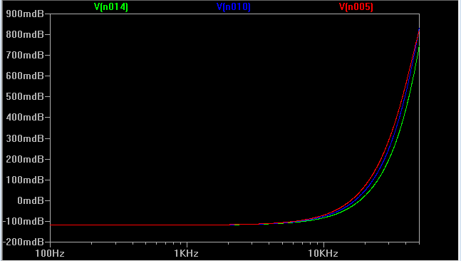

I just simmed the passive input section of JG's filter in LTSpice with 15mH, 18mH and 22mH as the inductor values. Its showing a minor (0.1dB) lift at 20kHz which gets slightly bigger as the inductor value goes up - this is caused by the inductor ringing. Nothing much to worry about. The design could be made less sensitive to inductor value by including a damping resistor across the coil. From simulation I reckon 47k is about right.
<edit> I just noticed curryman's circuit is a little different from the JG original, no series 40R so my result doesn't apply to that circuit, only JG's.

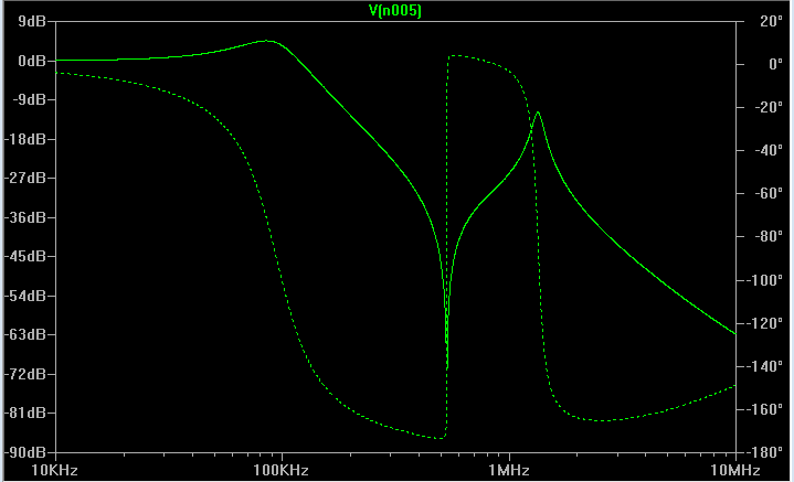

<edit> The new inductor turns out around 3uH with my estimates and the plot is here - problematic is the ringing above 1MHz.
To model an opamp output there's the open loop output impedance (which might indeed be around 200R or so for a CMOS opamp) at the unity gain frequency (probably 10MHz or so) and then this goes down with decreasing frequency so at 10kHz it might be 0.2ohm. The overall effect I'll try with an inductor for Zout in parallel with the 240R and also taking out the 40R now I'm slowly getting up to speed
Here's how it looks with two real resistors added - a 150ohm between the DAC and the 4n7, and a 47k across the inductor. Damping the inductor in this way makes variations in its value relatively inconsequential so there won't be a need to pre-select parts.

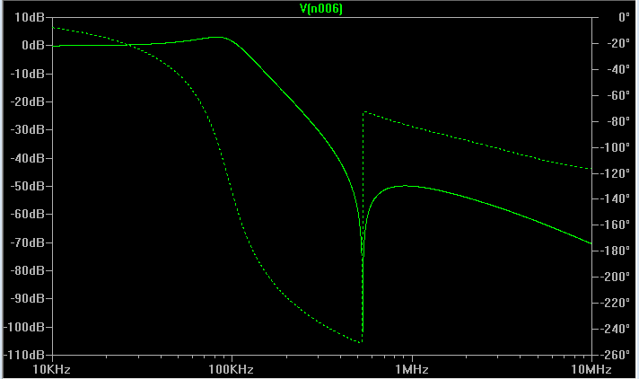

OK then assuming the 240R is a real resistance in series with the opamp output here is how it looks (47k inductor damping resistor still in circuit) :

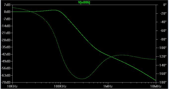

Inductor peaking is about 1.2dB at 70kHz quite benign. Second plot shows how it looks without the 47k - almost 3dB peaking.
Just for the sake of completeness, here's what happens to the FR when the inductor (with damping) is changed down to 15mH and up to 22mH - zero audible change to the audio band response - well under 0.1dB difference at 20kHz.
<edit> Please note this does not mean you can change the nominal inductor value and get no difference - this is just to show the effects of 20%-ish tolerance on the 18mH value specified.
