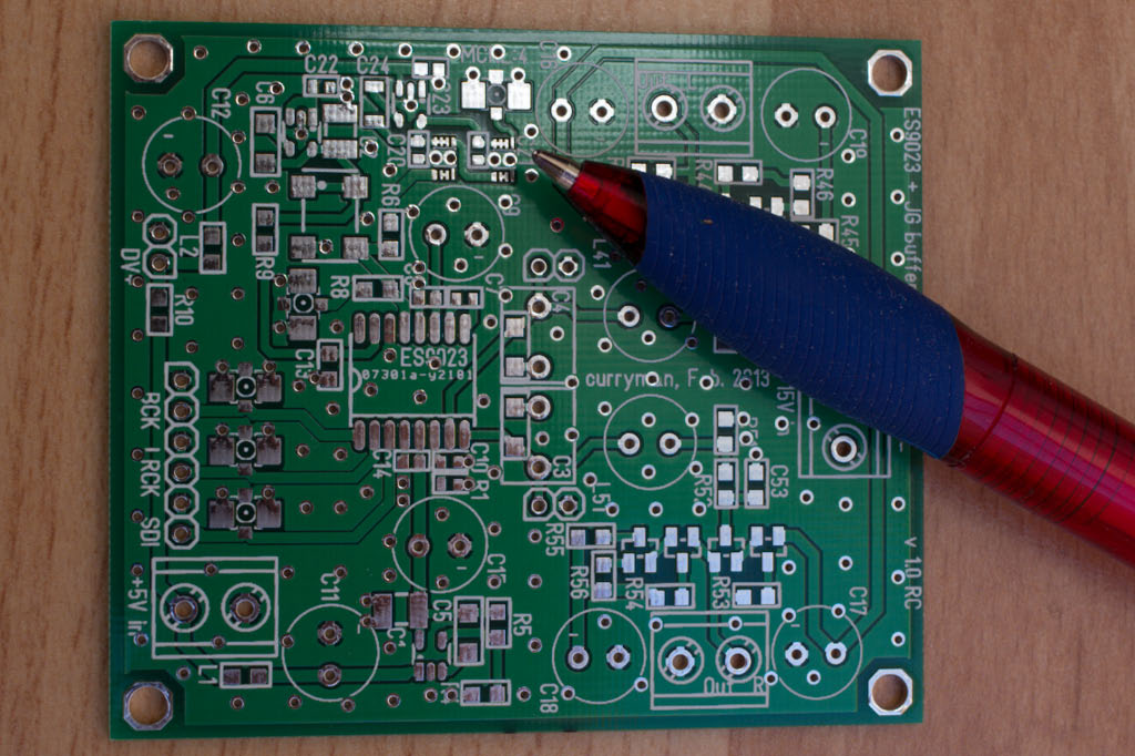

Dear all,
I'd like to send a little update about my version of ES9023 + JG filter buffer PCB.
Proto-boards arrived today so betatest can start soon. They look really good, though next time I'll take into account vias conflicting with silkscreen 😱
Unfortunately a flu knocked me down so it may take a few days until I start contacting the beta tester and stuffing a first board (soldering those tiny smd stuff isn't fun if the head is completely mucus-ridden :ill:). I'll keep you updated!
Best regards, Daniel

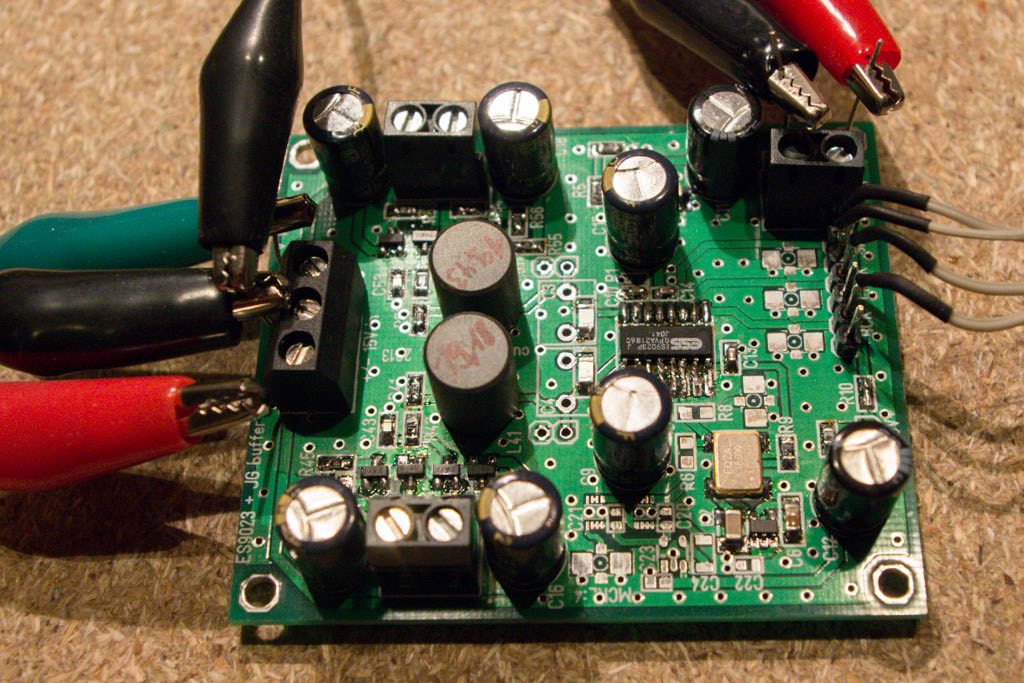

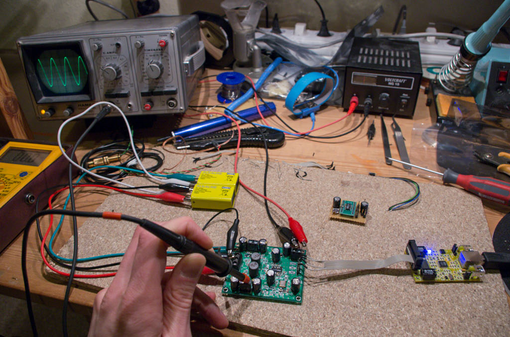

Hi all,
today I managed to stuff one board and do some first tests. Everything works right from the first start 😀
I used asynchronous mode with 48MHz clock and fed the DAC with miniSTREAMER. Today I only checked with 1kHz and 10kHz sine and scope (signals look really good!). Tommorow i'll do some more measurements with soundcard (FFT, THD,...) and more important some listening 🙂

I wonder if anyone with access to proper measurement equipment could run and publish some performance measurements for Daniel's board (THD+N, IMD, DNR etc.) ?
That would indeed be quite interesting 🙂 However the first betatester just received their proto-boards and it may take some time until they sourced the components and soldered the boards.
I already did some first measurements with my build but did not save the graphs (Arta Demo -> only screenshots). With my RME DIGI 96/8 PAD I measured a THD+N around 0.0058 (-103dB) with 96kHz I2S Input (not U.Fl but pinheader) from miniSTREAMER (TE7022) *. Hard to interpret though since there are too many variables. I don't have a low THD generator at hand to test the ADC of the RME card. In loopback (incl. soundcards DAC) THD is (only) slightly better.
*There might also be some potential to improve the miniSTREAMER or asynchronous USB solutions might also be better😕
Thanks Daniel. It does look promising. I would still love to see someone run a similar testing methodology like nwavguy did for the ODAC. I know it is a long shot to ask as it would require time and access to a professional grade equipment. If your BOM is finalized and replicable, the test results could provide a good indication of what we can practically achieve with the board.
