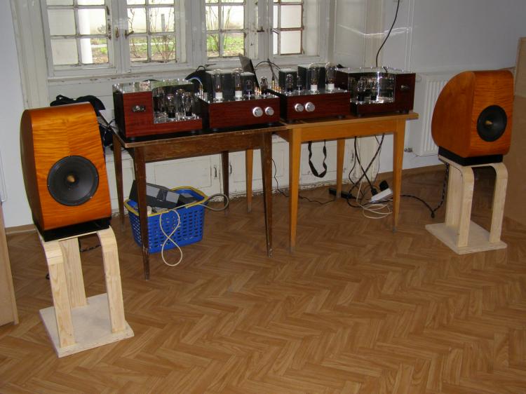

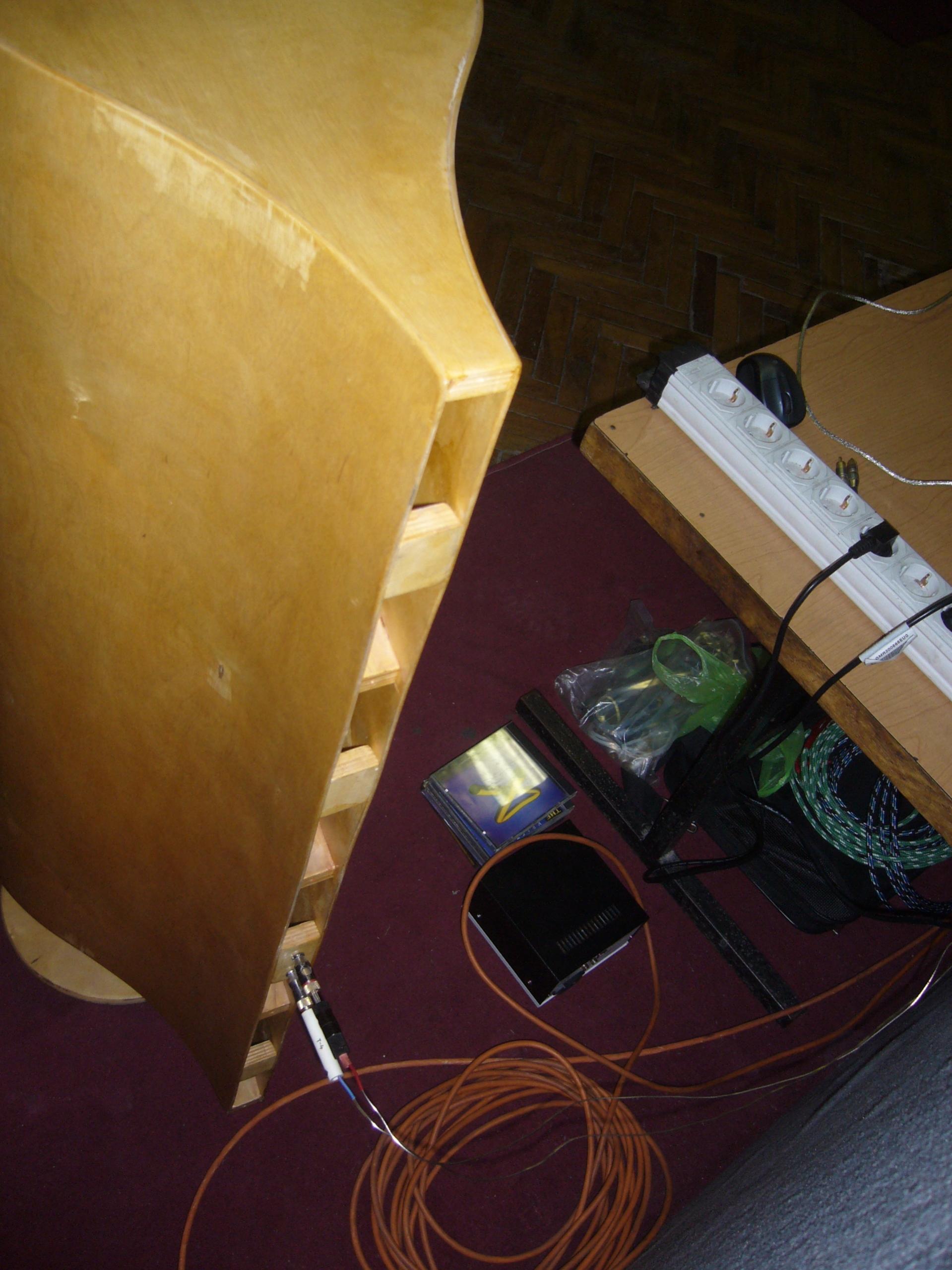

I've built two pair of the Reso style cabinet. One with the greencones and one with removable baffle for use with other drivers.
I like them a lot for low level listening.
Heres a greencone RS Ribbon configuration and a few other shots.
It's a tough thing to put in words how these things sound. Lively like a acoustic guitar kind of sound.
I've tried several drivers that have higher Qts. The greencones sound very nice as does the Lyeco in the last picture. My ears find the WB drivers need a tweeter.

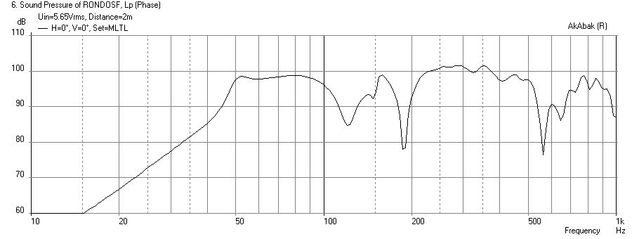

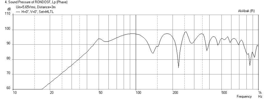

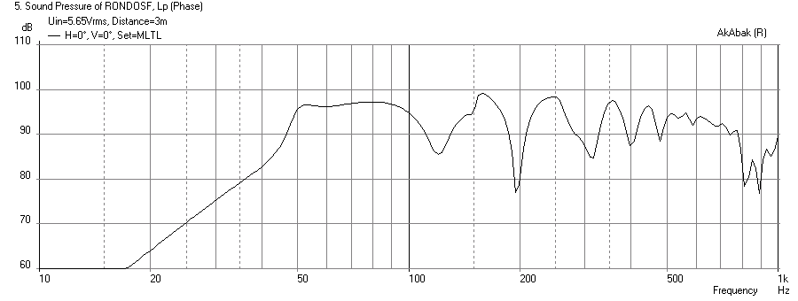

I ran some more calculations with the listening position at 3 m away with varying back distances from a wall: 48 in, 60 in, 72 in. The 72 in looks best but there are some unpleasant dips in response. This is for 4 watts input power (5.65 volts). The last plot is for the 72 in from back wall but with a 2 m listening position.

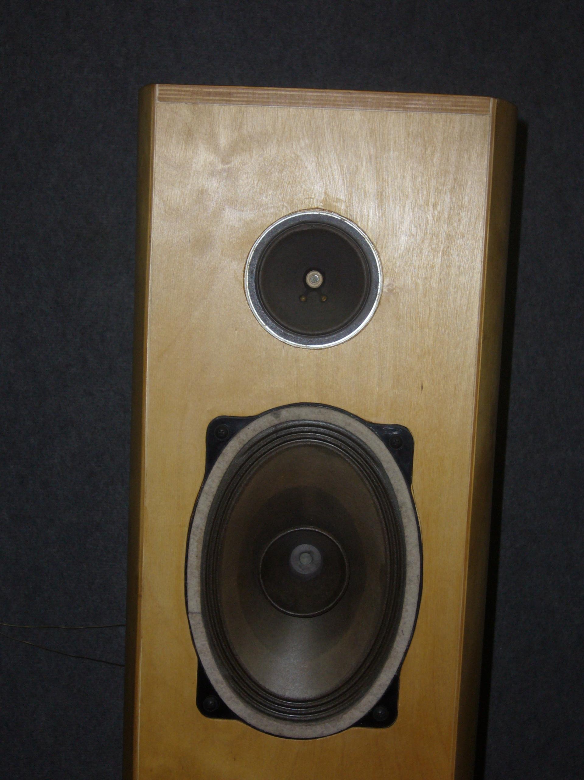

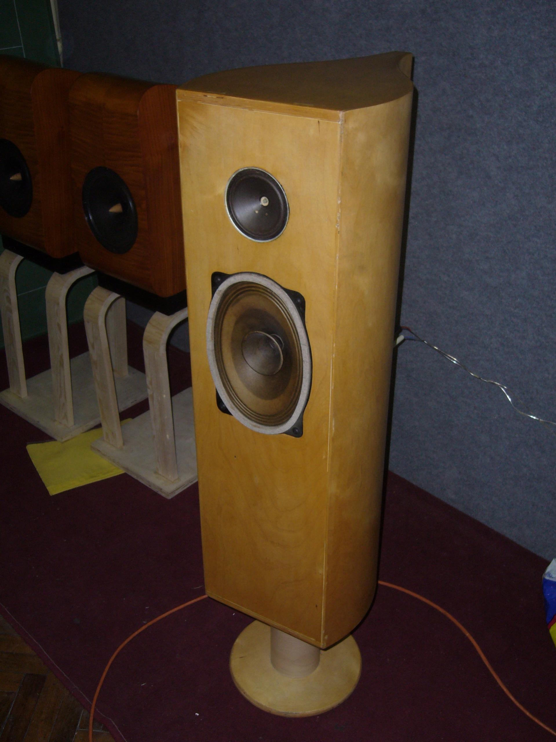

i liked them. they were interesting compared to a br. they were very dynamic. good price/performance ratio. there were other Rondo-type speakers without tweeter, I did not liked them (attached picture).
however, I don't like full range speakers, they are not my cup of tea. I auditioned the 4Pi speakers 1-2 weeks earlier (2226h/de250).

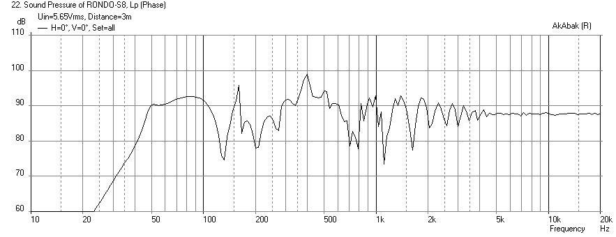

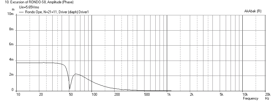

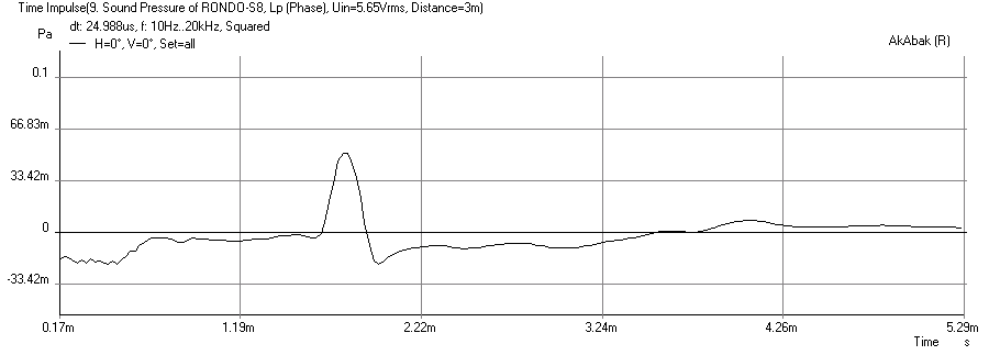

Sagamotto,
I am very pleased with how well the Super 8's perform in an open bottom Rondo style enclosure. Very simple yet the response appears to be very flat in the bass end with extension down to 50 Hz. There are resonance peaks and dips but that will make the speaker have "character" very much like a cellor or double-bass body. It will impart its own coloration to the music but that may not be bad depending on the music you play. Probably chamber music and simple vocals will sound very nice.
Here is the design I came up with in AkAbak: 12 in wide baffle x 16 in (equivalent depth) - make the nice tear drop shape cross section but preserve the cross sectional area of about 192 square inches (CSA) x 60 in tall, at the bottom provide a window brace (ring) with an equivalent CSA that is 80% of the main CSA. The driver is mounted 24 in down from the top, the speaker stands on 4 in legs to provide a gap of 4 in for the sound to radiate out. Otherwise, the box is sealed - open only at the bottom.

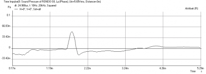

Here is the freq response, the impulse response, and the driver cone displacement for a 4 watt power input with listening position at 3 m away, and speaker situated well away from a wall (72 in). This design does not like to be near a wall - you will get cancellation and dips.
I think it may turn out to be a nice speaker if you are willing to give it a try.

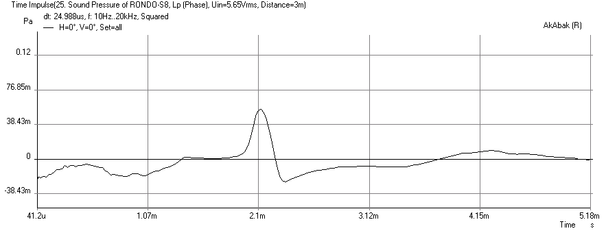

Sagamotto,

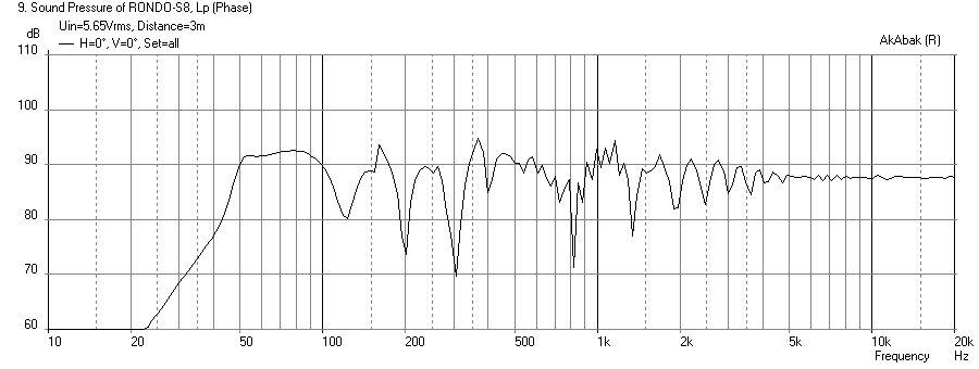

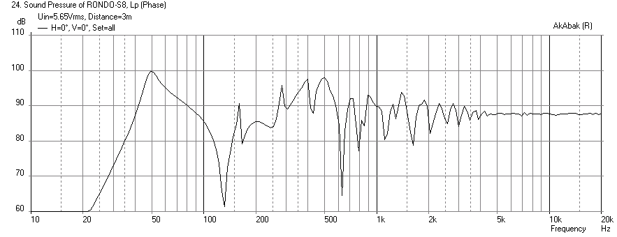

You are welcome. I just ran some more sims with a 48 in height per your request. It can work if you constrict the opening at the bottom (almost like making it into a MLTL). I also made the baffle wide and the speaker shallow.
The design is as follows: 24 in wide baffle, 10 in equivalent depth for 244 square inch CSA, driver mounted 16 in from top, 4 in tall legs for gap at bottom, the window brace at the bottom will now be only 60% of the CSA area of the top, plus it has a wall that extends up into the speaker cabinet like a vent tube that is 8 in long. Still, it doesn't like to be near a wall. I am showing you the response far from wall (72 in) and near wall (16 in). Pretty ugly near wall - very boomy bass peak at 50 Hz. You can of course, make this out of curved foam core in the back as semicircle and the foam core will let you bend and curve easily. Use soundboard wood like thin maple or cedar on the front like a musical instrument. The plots below are freq response far from wall, impulse, and cone displacement for 4 watts, 3 m listening position, and 72 in distance from wall. Last plot is freq response placed 16 in from wall.
Seeing your situation and requirements, may I suggest you just go with a traditional MLTL design with a front firing port? It may work out much better for you. You can still have the cool semicircle design with flat front and curved back. I can come up with a design for a true MLTL if you like.

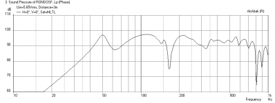

Sagamotto,

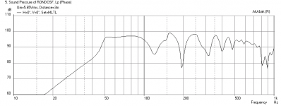

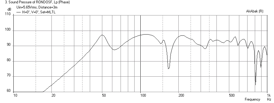

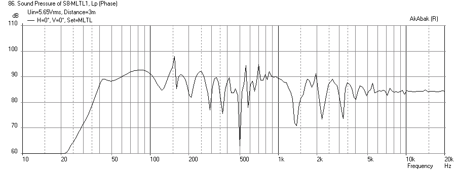

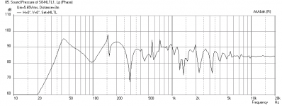

I think GM offered you a very nice design for a MLTL in the Super 8 thread. Although you said it was too tall for your tastes at 56 in. I am not able to come up with a nice design as a MLTL that is 48 in or shorter and able to sit close to a wall. Here is what I have so far based on your request for wider baffle... 16 in wide x 12 in deep x 48 in high, driver at 17 in from top, port is 5 in dia x 2 in long located 10 in from bottom front firing.
Simulations are for 4 watts power, 3 m listening position, and speaker placed 72 in from back wall vs 24 in from back wall. Not very pretty... It will look better with sufficient stuffing/damping in upper 2/3rds of the TL.
