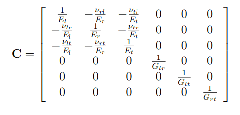

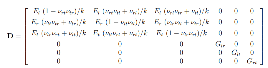

Yes I found examples of 6x6 matrix used for 3d models. It’s the inverse of the compliance matrix, according to one answered question on the forum. Compliance matrix entries have inverted E1 etc elements, so it’s not surprising the the inverted matrix has elements with the same order of magnitude as E1 etc.Just found the example below of anisotropic material.
But for 2d model I need a 4x4 matrix.
I may move to shell solver which I think uses a 6x6, and has more capabilities I think and may be more accurate. No answer yet on the Elmer forum.

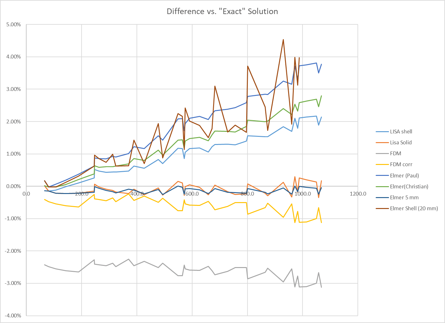

I did a run of the shell solver in Elmer, with some help from the Elmer forum. Seems quite fast.
I used the parameters that Eric specified for the various methods we are using.
This is with a ~20mm irregular quad grid.

I also found a reference about orthotropic materials that covers both the compliance matrix and its inverse, the stiffness matrix.
http://homes.civil.aau.dk/lda/Continuum/material.pdf
Coordinates are radial, longitudinal, and tangential, which apparently come from slices through timber logs.

I'm a little confused about your different options in Elmer. This time, you used the "Shell Solver". Wasn't what you were doing previously also using the a shell solver? What's different? Oh, wait, it's the "irregular quad grid" elements, instead of triangles. Is that it?
I've added your newest data to our charts. In the first chart, it's getting hard to distinguish the lines from each other, but the new data is the bumpiest. In the second chart (diff vs, exact), the new result has the most variable difference vs. the exact. The modes with the greatest difference vs the exact are the high order 1,N modes.
Maybe try the quad elements at 5 mm? How many nodes are there in a quad element? The LISA elements have 8. The corners and the midpoints of each side.

Hi Eric
Previous runs in Elmer were with the Smitc Elastic Plate solver, which is a dedicated solver for flat 2D plates. Now I am looking at the more general shell solver which is basically a 2D manifold in 3D space, so you could do cylinders or ship hulls or whatever. But it also has other features like Rayleigh damping, a 6x6 matrix for ortho which we have some info on, and I think better options for output of velocity
It certainly looks rough! I tried a second order element yesterday, but it didn’t accept it. Another thing I could try is regular shaped elements which is harder to do I think in gmsh. The quads I used here are from recombination of triangles, so you end up with a random pattern. More research 🫤 Maybe the convergence tolerance is too small. There are like 1000 settings to fiddle with.
Could it be picking up another series of in-plate modes? There does not seem to be more data points in this series, so I guess not. Or it could it be that this is closer already to the truth than the others. How would we even know? Shell models are more general again than Reissner Mindlin.

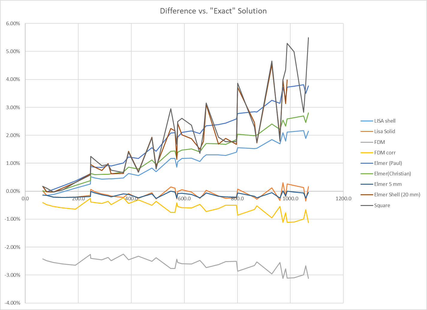

Would you mind adding this to your graph Eric? This is with structured (square) mesh, and all convergence tolerances set to 10^-11. Values do look smaller maybe on the other side now
6.573769554046E+001 8.106250951077E+001 1.067267229449E+002 1.428456374177E+002 1.895509826913E+002 2.470067472737E+002 2.500544782016E+002 2.652646957200E+002 2.907047580284E+002 3.154165111593E+002 3.264957870403E+002 3.727912370542E+002 3.950260387884E+002 4.297742926895E+002 4.861246726247E+002 4.976598370793E+002 5.654410298504E+002 5.766982302128E+002 5.805009210716E+002 5.890467629829E+002 6.056749807722E+002 6.410717244469E+002 6.671791603213E+002 6.868387120519E+002 7.041734291522E+002 7.431604869091E+002 7.694350229975E+002 8.102577963002E+002 8.319346898473E+002 8.838438909093E+002 8.883881609738E+002 9.728119528195E+002 9.778475123692E+002 1.010832299952E+003 1.024748540320E+003 1.039600149946E+003 1.064419837402E+003 1.078972529117E+003 1.099307577026E+003 1.127340855617E+003 1.144402483705E+003 1.150878057874E+003 1.192143409038E+003 1.199882414180E+003 1.265963880625E+003 1.296114427491E+003 1.304513197999E+003 1.317786850377E+003 1.342902490150E+003 1.430993900827E+003 1.456379224577E+003 1.472327214577E+003 1.479786621351E+003 1.530575343478E+003

Thanks Eric
I may try one more run with a finer mesh, before I return to the smitc plate solver. There is also something you are meant to define called the 'director' for the shell solver, which seems to be the normal to the surface at each node. Dont know if its important for such a simple geometry though.
But I have some bad news I found out last night by looking at the plate code, and confirmed definitively on the Elmer forum upon the return of one of the developers to the forum. Neither the plate solver not the shell solver supports orthotropic. Sheesh.

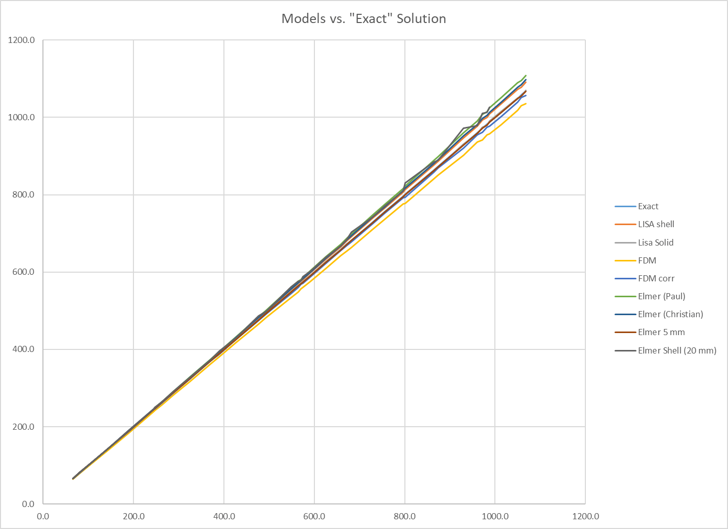

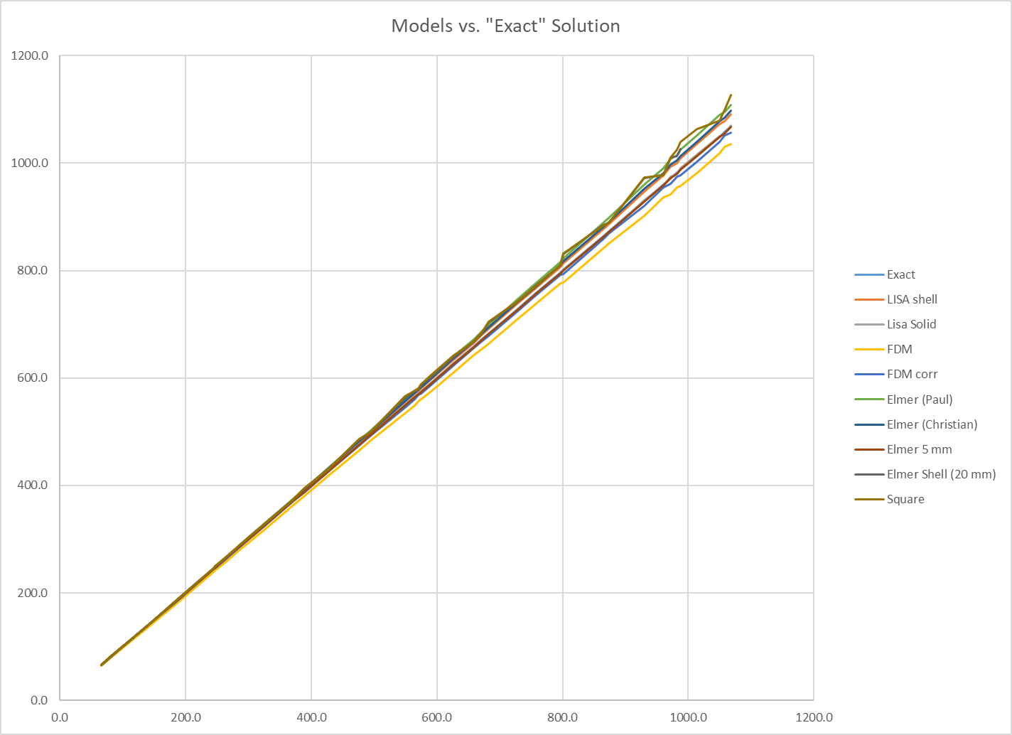

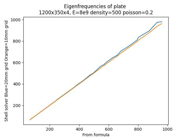

I plotted some graphs myself comparing plate (smitc) solver with the shell solver at different mesh resolutions, using a regular grid.
I found that plate and shell performed similarly (just from viewing the zoomed out graph), both at 20mm and 10mm resolution. The lines were over each other. Not sure why the shell solver seemed worse previously. In fact, at 20mm both are equally bumpy. I expected shell to be worse since I read that shell grids need to be finer, but maybe because they are normally in 3D.
In both cases, there was an almost identical improvement in the values for 10mm grid. I have only showed results for shell below but plate solver looks the same. You can run the other cases with python. I guess you would get diminishing returns from 10mm down. Interesting that both methods suffer similar errors.
Interesting that except for the slope of the line, the closed-form solution is very accurate.

Paul,
Wait, if you do your own plotting, what am I going to do? Haha.
Can you share the data for the four new runs? I actually would like to add them to my own plot. What type of elements did you use for each?

That was one thing that I found interesting. Even Lisa and Elmer seemed to have errors that were similar, while the errors in the FDM were almost mirror images of the FEM errors.Interesting that both methods suffer similar errors.
