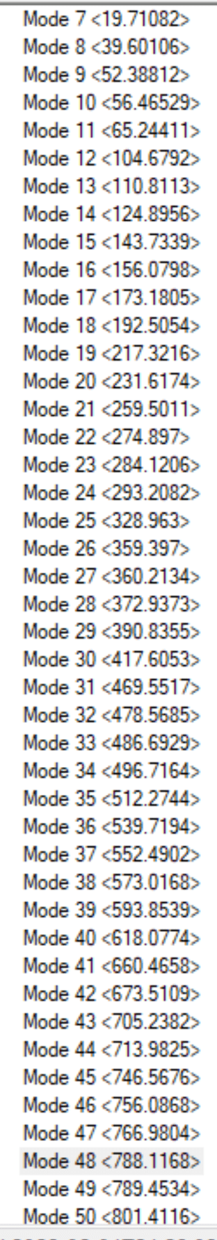

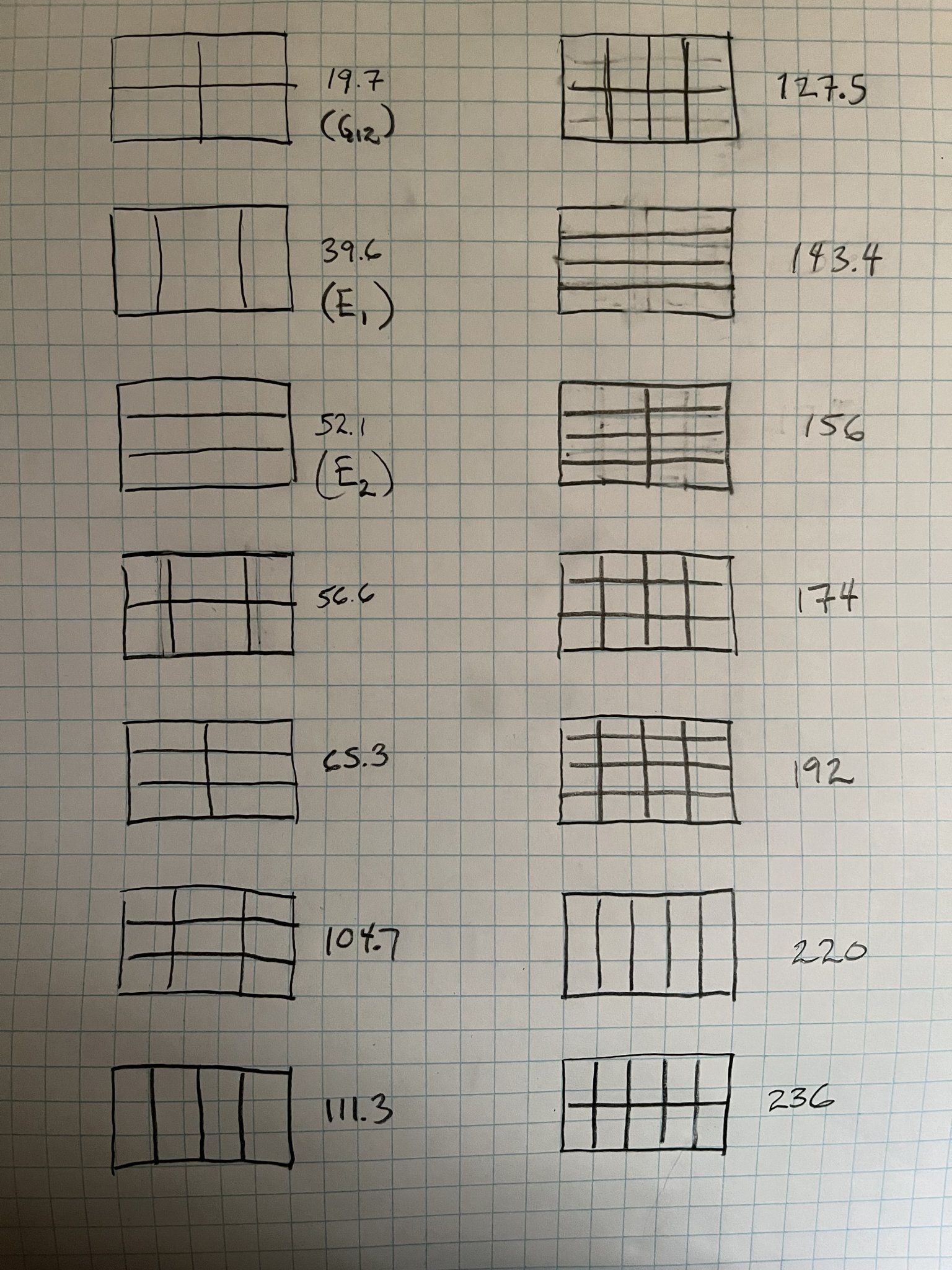

Here's some data for you on a fiberglass balsa sandwich panel. The balsa grain is running in the long direction of the panel, so it's stiffer in that direction. Here are the panel details:
0.457 m x 0.606 m
rho = 247 kg/m3
h=3.51 mm
The images below shows the eigenfrequencies (Hz) along with a schematic of each mode. The lines inside the rectangle represent the nodal lines for the mode. With the above parameters and the first three frequencies below you should be able to estimate G, E1, and E2. The remaining frequencies provide a check on the model. If you get those three parameters right, the model should predict the remaining modes decently.
Since this is not a poisson plate, it won't give you the best possibility to estimate nu accurately, but I did find that the upper frequencies did change a bit with changes in estimated nu,
![9ECB8222-E70E-4FBF-83A4-BE683C83294D.jpeg 9ECB8222-E70E-4FBF-83A4-BE683C83294D.jpeg](https://www.diyaudio.com/community/data/attachments/1046/1046153-08a23e416465141ff574423ab78c77a0.jpg)
With this data and LISA I was able to come up with estimates of G, E1, E2, and nu that predicted all but three of the 14 listed frequencies within 1%. The others were off by about 2%. I can share my values if you want, but I thought you'd probably want to try it on your own first.
Of course you still missed the part that's the most fun, that is, sorting out which frequency is associated with which mode.

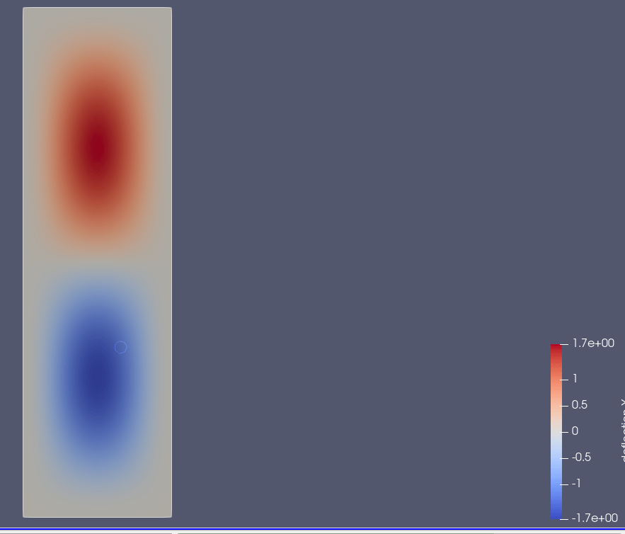

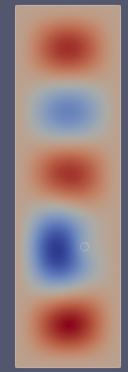

Looks like I have some promising results (or at least 'sanity checks') from the harmonic analysis, after playing with the linear solver and preconditioner options to get it to converge.
Mesh and sif files attached.
- With the frequency set to an eigenfrequency, it gives that mode shape
- Smaller amplitude the further that the "exciter" is from the antinode, as expected.
- Frequencies below the fundamental, give a static deflection of the panel under the exciter - makes sense.
- For frequencies between resonances, you get some sort of hybrid (see below)
- I have not set any damping yet, so I was surprised to have it spit out results in between. It did have trouble converging between eigenfrequencies though, until I used ILUT preconditioner. And it had more trouble with higher frequencies. ILUT made a huge difference - now converges essentially instantly whereas before it was not converging sometimes after 3000 iterations.
- The displacements seem too small. I'm using an exciter area of 30mm diameter (about 7cm^2). Im applying a pressure of 10^4 (I presume this is Pa or N/m^2), which is 1 N/cm^2, so 7N force overall which is about 0.8 kg force, and I only have a small deflections - see bottom image, I get 1.7 mm.
- Oh wait, that could be 1.7 metres deflection!! Never mind, it's early days yet and results are promising.
- Probably if I can enter realistic values for Raleigh damping (research required!) and a more realistic value for exciter force, we should get much closer to real results.

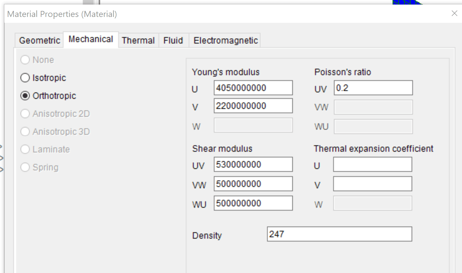

Ive set up the mesh and SIF file to run this but am stuck on the structure of the elasticity tensor.0.457 m x 0.606 m
rho = 247 kg/m3
h=3.51 mm
E11=4.05E9
E22=2.20E9
G12=5.30E8
G13=G23=5.00E8
nu12=0.2
It seems I need to start from a 4 x 4 compliance matrix (not 3x3), and invert the matrix with other software before entry into Elmer sif file.
Presumably its very similar to the 3x3 matrix, with extra column & row contain the 'axisymmetric' terms (I think that's what they're called) G13 and G23.
Ive asked on Elmer forum, but maybe you know the structure?

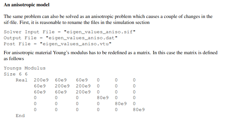

Just found the example below of anisotropic material. From Elmer non-GUI Tutorials page 6
The order of magnitude are similar to Young modulus (was 100E9 in the beginning of the example), not inverse.
