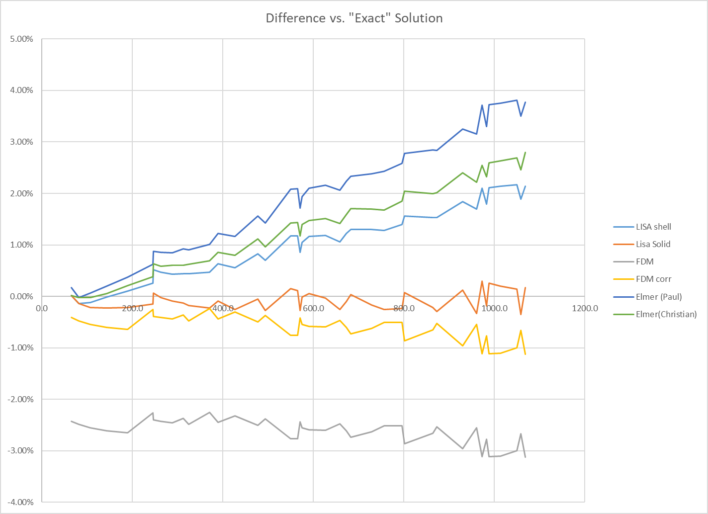

I created some new plots comparing the following solutions:
I did not include Christian's Elmer solution with ν=0, but a cursory comparison showed it was virtually identical to the ν=0.2 solution reduced by 2%. I think this is good validation for my correction to the FDM of the same amount.
- "Exact" formula
- LISA Shell Elements (84x24 mesh, 2016 elements)
- LISA Solid Elements (84x24x1 mesh, 2016 elements)
- FDM (for ν=0)
- FDM (corrected by factor of (1/(1-.2^2))^0.5=1.0206, to account for ν=0.2
- Elmer (Paul)
- Elmer (Christian)
In the plots below, all the results are plotted relative to the "exact" solution. Not because I think it is the most accurate for a real plate, but rather, the most neutral, I would say. In fact, I expect that the "exact" solution would actually not be the best solution, as (I believe) it neglects shear deformation. I could be wrong about that however.

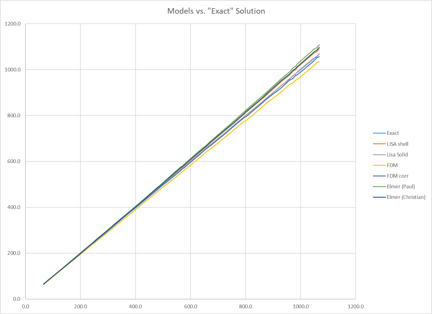

Here are the plots. In the first plot, the y axis is the predicted eigenvalues and the x axis is the "exact" solution for the same eigenvalues. In the second plot, the y axis is the percentage difference between the each solution and the "exact" solution, with the same x axis as the first graph.
Overall, I think all of the results are pretty good. Interestingly, the LISA solid model is closest to the exact solution, with the corrected FDM method being next closest but estimating slightly lower natural frequencies. The LISA shell and both Elmer models (also shell/plate elements), on the other hand, all started pretty much dead-on the exact solution but wandered higher with increasing frequency.
One curious thing is how in the second graph the profiles of all the LISA and Elmer models follow the same pattern of peaks and dips, while the FDM profile is practically a mirror image. Curious.
What's the difference between the two Elmer models? Did you guys use different mesh density? Christian's mesh was 36x121 I think, what was yours Paul? Sorry if you mentioned it, I can't recall?
For me the odd thing is that I expected that the models that include shear deformation would predict lower, rather than higher natural frequencies. That is, that neglecting shear deformation, the exact solution would act stiffer than the real panel, and hence slightly overestimate the natural frequencies. And on the other hand, the models that include shear deformation would tend to tend to give lower (and more accurate) natural frequencies than the "exact" solution.
Interestingly, for the LISA and Elmer models, the results are opposite of what I expected. Any thoughts on why?

Christian, as far as the Poisson's ratio is concerned, I think that for the FDM script and for the "exact" solutions you can modify E as:
E (effective) = E/(1-nu^2) = E/(1-0.2)^2 = 1.04166*E
as here:
For myself, I learned a few things too.
(2).../...And sorry about that Christian, I could just as easily have chosen 3.4 or 3.6 but I did not anticipate your issue with 20 mm elements). Anyway, I created a 24x84 mesh with square elements and reran the test case with that. Results are better now I think, and track more linearly with Paul's results, I expect. My originally elongated elements did not work great with modes like 1,10 etc as the element resolution across the width of the panel was too small, I guess.
Eric
Thank you for this feedback. I agree the exercise was very good for me too.
- Up to now as my script was running without external comparison, I remember decided not take care of the Poisson's coeff as you mentioned due to the errors that exists in other terms. Correction done.
- No problem with the dimensions. It show me an other improvement not too difficult to implement to allow rectangular (not too rectangular!) tiles.

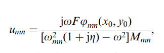

I can access the data from the vtu file output by Elmer.
So now, looking again at the equations from Putra/Thompson paper (another good one is Xie and Thompson) it looks like we should be able to do a simple numerical integral to estimate far field sound at a point.
The Rayleigh integral adds up the contributions from each point on the panel. The 1/r term accounts for distance (why not 1/r^2 ? ). The complex exponential accounts for the phase effect of each point on the panel with regard to its distance from the observation point. In any case, we can do the calcs directly in complex numbers.
The velocity term is given by the mode shape (which we have) times a constant Umn
Umn is given by this expression below, which also makes sense. The j makes sense to me because it represents a 90 degree phase shift between maximum displacement and velocity. F is the applied force, which we would assume constant for our exciter in the first instance. Mmn is also an integral over the shape function which we can calculate. The phi(x0, y0) represents the forcing location - if its at an antinode, it causes stronger excitation as we know.
The term in square brackets represents the resonance peak, which would cause Umn to go to infinity without damping. Omegamn is the modal frequency (which we have) Eta is the damping loss factor, which we can estimate. Seems like there is an absolute value missing? I don't think we would want Umn to be negative?
Anyhow seems to me if we get a few details straight, we can use these directly to estimate power at a given point in the far field from any mode due to point excitation on the panel. Should be useful for comparative purposes, particularly for strange mode shapes to tell how productive they are.

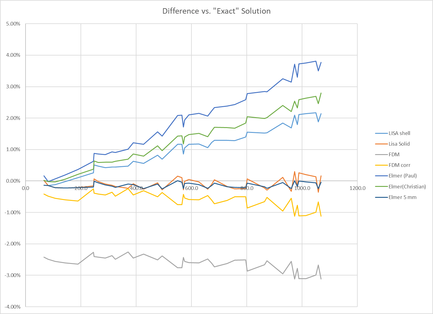

Here's another run with a 'true' 5mm grid. I found an option that was setting a hard limit on the grid size, explaining why my 5mm gid was actually ~20mm.
Cant tell if its any better just browsing a few values... Looks like there are more modes, so maybe in-plate modes? Dunno.
6.554225947209E+001 8.086218961498E+001 1.064642682221E+002 1.423747305539E+002 1.885945210975E+002 2.451182170946E+002 2.468906831794E+002 2.621745856817E+002 2.876821363936E+002 3.119417256610E+002 3.234495808750E+002 3.695043426655E+002 3.890598467747E+002 4.258638949652E+002 4.764696327141E+002 4.925395475418E+002 5.491697454286E+002 5.644408555318E+002 5.695305292589E+002 5.741704960837E+002 5.899110757467E+002 6.256058875852E+002 6.568343008481E+002 6.715501051795E+002 6.821599859572E+002 7.277674398621E+002 7.544508862144E+002 7.942810210743E+002 8.004402279101E+002 8.623729809290E+002 8.711012605289E+002 9.290080572819E+002 9.582351393185E+002 9.724180774173E+002 9.806059581032E+002 9.876794931535E+002 1.013126150167E+003 1.048777251983E+003 1.055691385887E+003 1.067864138528E+003 1.094651587263E+003 1.109138359968E+003 1.150770980257E+003 1.163465520040E+003 1.217010951662E+003 1.217159932444E+003 1.247970424852E+003 1.281570822592E+003 1.293833276388E+003 1.376446142470E+003 1.380804207814E+003 1.397108807456E+003 1.409991244641E+003 1.478089034204E+003 1.516692135563E+003 1.531943766485E+003
Paul,
Yep, it's better. Nearly perfect it appears, at least compared to the exact. It's the blue line right labelled Elmer 5 mm. Nice.
I can't do a mesh that fine with LISA. Not sure if it's my laptop of LISA but something runs out of something....
Eric

The 'exact' solution just happens to be from a formula, but how closely does it model reality compared with Mindlin?Paul,
Good test that shows a possible improvement behind each deviation from the theoretical values. For the FDM script I am used to see increasing error with the mode number when the mesh is not fine enough. Before seeing those graphs, I haven't noticed it is almost a straight line. The FDM in orange is a 10mm mesh. Is a correction function from that particular case might be applied to other boundary condition? No interest for FEM as far as the computation time is acceptable, more interesting for the FDM. The interest I see for FDM and I should test next (except if an other solution comes from our exchanges) is the possibility of local "devices" like spring, damper, mass attached to each point (starting from the exciter location). I still wonder how the modes are modified mainly in light membrane because of the exciter moving mass and spring (spider).Paul,

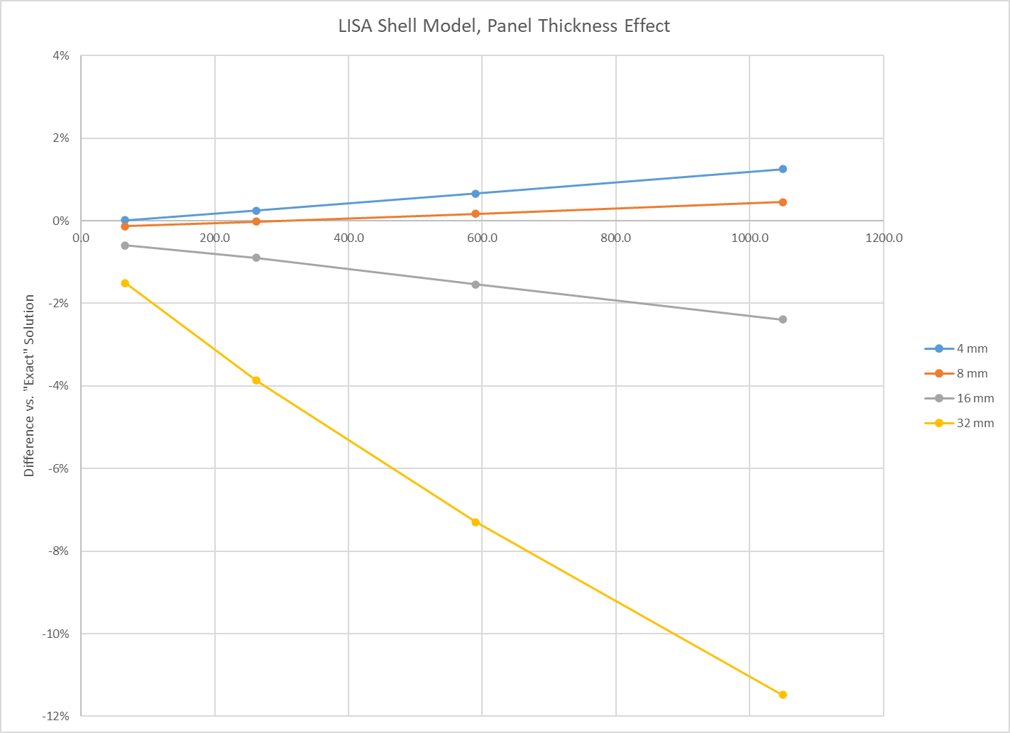

My thoughts are this: Of course the exact solution applies strictly only to an imaginary plate, ie one that is vanishingly thin. So I would hope and expect the Mindlin model to compare better with a real plate than the exact solution would. But also I expect that the Mindlin model would converge to the exact solution when used to model a very very thin plate, as long as the model has a sufficiently fine mesh. And I think that’s exactly what our combined results are showing us. Your 5 mm mesh is sufficiently fine, while all the other shell/plate FEM results are close but not quite there. Today I was able to run a Lisa model with about 3000 elements ( my earlier model was 2000 elements) and the results fell closer to yours than the coarser model, but still it didn’t converge to the exact solution. It’s the best I can do though with LISA for now.The 'exact' solution just happens to be from a formula, but how closely does it model reality compared with Mindlin?
Today I also tried modeling thicker plates which should reveal the effect of shear deformation better than the 4 mm thick plate we have been working with. I doubled the thickness in a series from 4 to 8 then 16 and finally 32 mm. For each doubling of the thickness I divided E by a factor of four, to give the same D in every case. The result was that for every step in thickness the new frequencies fell farther below the previous thinner case. Also the separation between the curves increased as frequency increased. This is exactly (qualitatively at least) what I was expecting/hoping to see from the beginning with these tests. I’m feeling more and more confident in our models myself.
Eric

Here are the modeling results I mentioned in my previous post. Otherwise same dimensions and properties as previous results.Today I also tried modeling thicker plates which should reveal the effect of shear deformation better than the 4 mm thick plate we have been working with. I doubled the thickness in a series from 4 to 8 then 16 and finally 32 mm. For each doubling of the thickness I divided E by a factor of four, to give the same D in every case.
I used these parameters:
thickness, E
4 mm , 8e9 Pa
8 mm, 2e9 Pa
16 mm, 5e8 Pa
32 mm, 1.25e8 Pa
I believe that the results for the 4 and 8 mm thickness panels land slightly above the "Exact" solution only because my mesh isn't quite fine enough. I expect if it was fine enough, the 4 mm results would land ever so slightly below the Exact solution, and the 8 mm result just below the 4 mm (as it is now). But other than that, the results look like I would expect. As the plate gets thicker, the farther the result lands below the exact solution.
Plywood plates are typically around 4 mm thick or less, so it looks like that pretty much qualifies as a "thin" plate, at least up to 1000 Hz. But PS foam plates tend to be thicker, closer to the 16 mm lines, and hence are probably best considered "thick-ish" plates for which the Exact solution isn't so good, especially at high frequencies.
Oh yeah, I only plotted four frequencies this time. One reason is that fewer points were easier to plot! But the other is that I noticed that increasing thickness had stronger effect on some types of modes than others, so the "order" of the modes changed. In this case I plotted the 1,1 2,2 3,3 and 4,4 modes only.

That will be interesting to see. I have noticed in my tap test that with 4 mm plywood panels there is virtually no change to the natural frequencies after adding an exciter. But with a 12 mm PS foam panel, the fundamental frequency increases, say, from 60 Hz to 80 Hz, or the like when the exciter is added. I'm not sure if the same increase extends to higher modes, I just can't recall.The interest I see for FDM and I should test next (except if an other solution comes from our exchanges) is the possibility of local "devices" like spring, damper, mass attached to each point (starting from the exciter location). I still wonder how the modes are modified mainly in light membrane because of the exciter moving mass and spring (spider).
Eric
