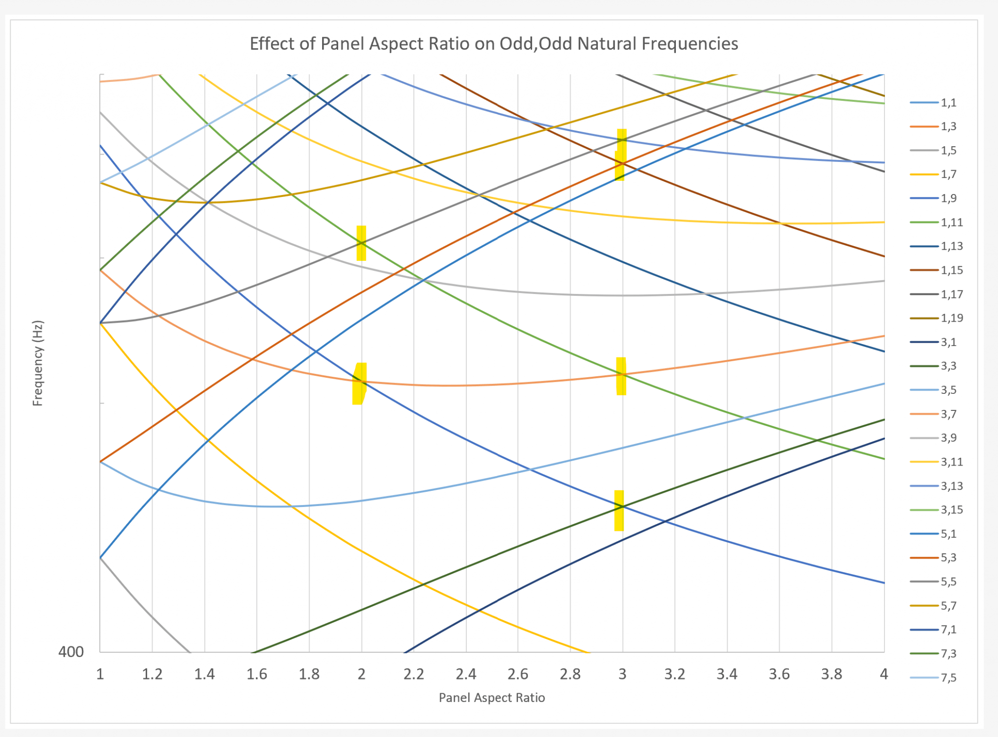

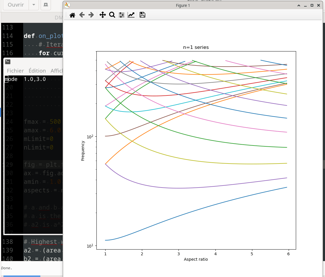

Light modifications of your script (please do not make a conclusion I am a specialist of Python... far from that, just a user)
2 remarks :
- only odd odd modes
- log vertical axis
- passing the mouse over the graph shows the modes in the terminal (first time I test that! Thank you stackoverflow).
2 remarks :
- mode 1,3 (orange) and 3,3 (brown, 4th line ratio=1) lines become quickly close (risk of a too high level?)
- does ratio (vertical line) passing on mode line crossing be avoided? Is the minimum of crossing points a criteria?

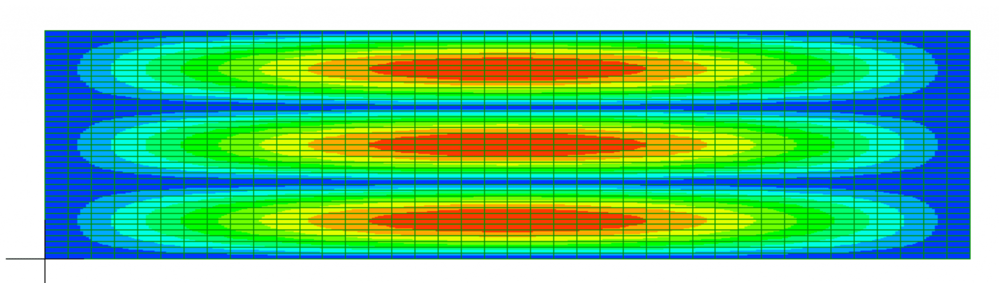

My script based on FDM (finite difference method) is on progress; The simulation of a simply supported plate seems ok (eigenfrequencies equal to the formula prediction). I added one feature to show the mean value of the mode shapes. Only the odd, odd have a non zero mean value. Kind of confirmation. Next step is to compare results against other simple cases like clamped and then to add the free edge condition.
The interesting output of this FDM script is to get a table of the displacement of each point. I would be interested if you have an idea to get from a FEM solver embedded in a Python script.

Great, I’ll have a look at the rollover feature. I think it’s worth including odd/even modes too.Hello Paul

I would say so. Two modes of the same frequency will give a higher peak. Plus, for every two modes that are degenerate (ie close together), you effectively have a gap somewhere else. So even distribution is a target for me.

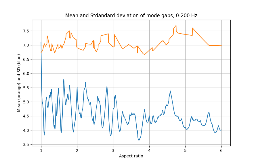

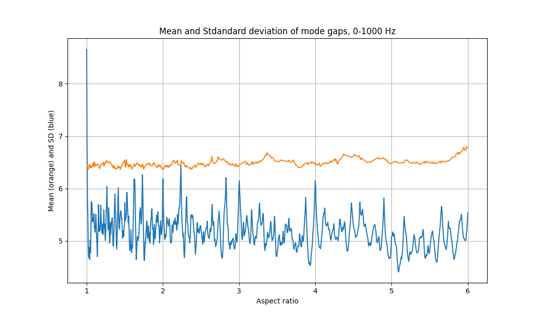

Here is a graph of mean and SD for different aspect ratios. Frequency to 1000 Hz. Note the peaks at integer ratios. I don't know if this is significant though for a real build. The peaks are sharp, and any asymmetry in mounting, damping, exciter position etc may eliminate the peak. Also this graph uses all modes, not just odd-odd or odd-X modes. But if it's easy to avoid, why not?
The average SD (is that a thing?) is around 5.3 or so, seems quite high compared to the mean? I would hope to find it lower for asymmetrical, large-perimeter length or panels with concave (dispersive) edges.
My intuition about a two modes at the same frequency 'causing' a larger gap somewhere else is wrong. Zeros just occur where they occur.
The distribution is not gaussian, but more like exponential distribution, with decreasing counts for larger gaps. Here is the distribution of modes 0-1000Hz at aspect ratio 3.0. Lots of small gaps, but there is no related increase at the larger end.
In fact, the reverse may be true. Since the mean modal gap is relatively constant with changing aspect ratio, a FALL in the number of small gaps will be counterbalanced with a longer tail, and more larger gaps further out.
Scrub that last sentence. I was thinking of a steep and narrow distribution that starts high, vs a flatter distribution that starts low, with a long tail. But that's not going to give the same mean!
What we know is that the number of modes less than a given frequency is quite constant, and the mean is quite constant. Looking for aspect ratios with the smallest number of near-equal modes will give you more further apart, but still less than the mean. Anyhow, we probably only need to consider near-equality for odd,odd modes as Christian said.

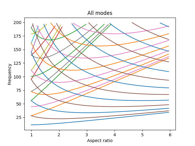

In what follows I am using:
I am using some rough material constants in the ballpark of EPS
- height (long dimension) = a and width=b
- mode indices m and n for correspond to sides a and b.
- area 0.5 m^2, h = 0.015 m
- nu = 0.3 # Poisson
- E = 4.0E6
- rho = 26 # density kg/m^3
Here is a plot of all modes < 200 Hz.

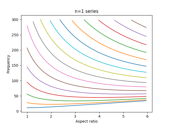

The first 'series' of modes with n=1 looks like this:
With a high aspect ratio, the 1,1 mode is at a slightly higher frequency, dominated by the 1/b^2 term. This actually helps because it lifts the fundamental from a pretty useless low frequency up to a point where it might do some good.
More importantly, side a is much longer, so each successive mode (adding m^2/a^2) adds much less than at low aspect ratio. Consequently, more modes are squeezed in at low frequency and are evenly spaced. At low aspect ratios, that first series quickly exceeds 100 Hz.
Not only that, looking again at the first graph, the first series has 'clear air' at the higher aspect ratios, because the second series with n=2 rises steeply leaving the first series alone and presumably giving a smoother LF response.
Script attached.

Good questions Christian,
On that topic, I can say that with my high aspect ratio panels I have often seen spikes in the FR corresponding to where the "second wave" of resonances start to hit. That is, where the (3,1), (3,5) (3.7) etc start to overlap with the first set. Sometimes (but not always) these peaks can be mitigated by offsetting the exciter close to the 0.33 position (along the short direction of the panel). That is, along the one of the two blue lines in the image below). Of course, this position is a nodal line for the entire "second wave" of modes, so it makes sense that placing the exciter along that line would reduce the contribution of the "second wave".
It's funny, though, that in a way this is opposite of the NXT way. That is, I'm suggesting to position the exciter in a place that avoids exciting particular modes, rather than in the place that excites as many modes as possible.
Eric
Paul,
Very interesting, I never noticed that before! I know you have suspected it, and I was skeptical. But you are correct. I had to go back to my own plots to see what's happening. Now I see that indeed at the integer ratios there is a higher probability of two modes at exactly the same frequency (see yellow highlights below).
One thing to note, however, is that these calculations all assume an isotropic panel. But few materials that we typically use for panels are isotropic. For an anisotropic panel, I suspect there will be similarly poor aspect ratios (i.e with higher standard deviation), but they probably won't fall at integer aspect ratios anymore.
Eric

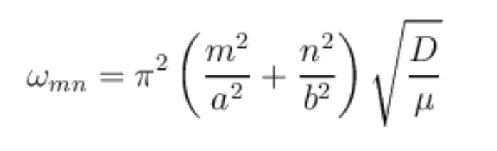

Am I correct that your script is using this equation? Sorry I am not a Python user.

Paul,
Yes that’s the equation. I thought there would be one for free panel too, but there is no closed form solution for the free panel.Am I correct that your script is using this equation? Sorry I am not a Python user.
