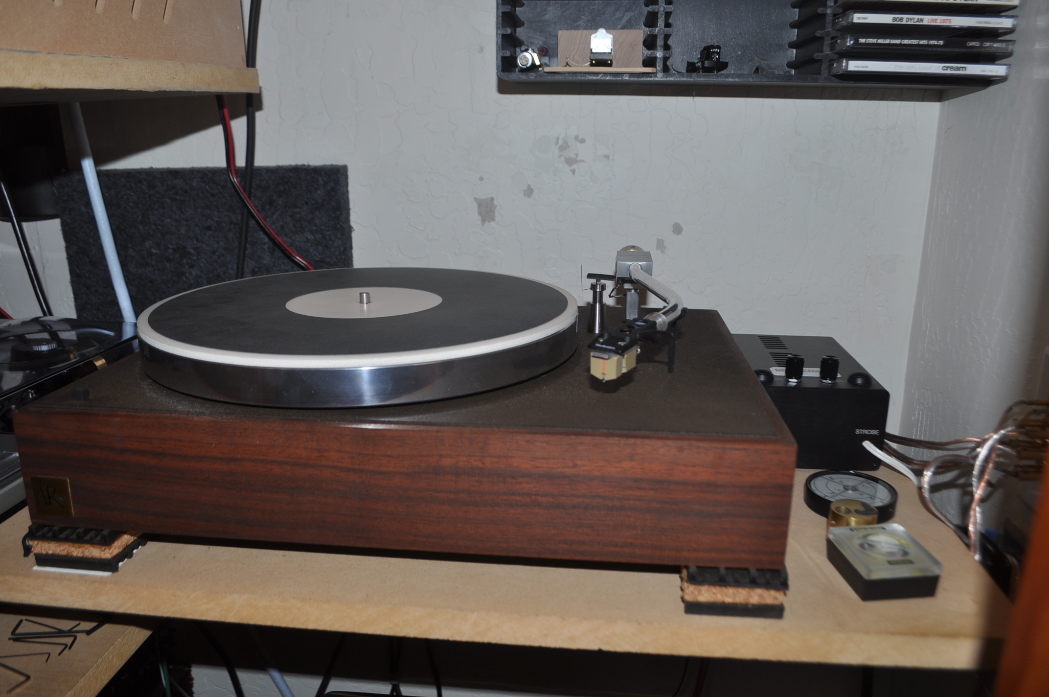

Not stock by any stretch of the imagination. We use this everyday.
