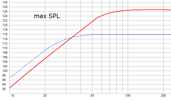

You are generally right with distortion for the price, but the rest, no... If processing allows, high EBP and low Qs is what brings best buck for money balance. Speaking about value, one can get better outcome for less money with some cheap 12“s. Just buy 8 of them.
Comparing UM-18-22 with Beyma 18LEX1600Nd
UM-18-22 in a 200 L box, Beyma in 107 L.
Both have a same Qtc of .767.
WinISD shows a few interesting facts:
1/ Beyma Fsc is 61.6 Hz, UM-18 is 28.9 Hz.
2/ Max SPL is the same for both drivers around 35 Hz.
3/ The max SPL is higher for Beyma as of 35 Hz upwards. At 100 Hz it is 10+ dB higher than UM-18. Subjectively "twice as loud".
4/ UM-18 max SPL below 20 Hz is about 4 dB higher than Beyma. In a sealed box max SPL is proportional to both area and Xmax, so the 4 dB seems logical as UM-18 has 22 mm Xmax vs Beyma 14.5 mm.
So at first sight a Beyma would have the advantages of a smaller box and more max SPL above 35 Hz (there where 99 % of the signal frequencies is found).
But the Beyma's maximum "rumble" output is still 4 dB less. In this box it also requires Linkwitz transform (or DSP) below 61.6 Hz leading to possible power compression at high volume and very much low frequency signal. The latter looks more theory. Modern EDM has much 30 Hz-ish bass, at 30 Hz Beyma's output is only 2 dB less than UM-18, so that doesn't look too dramatic.
Playing the devil's advocate, why would I want an UM-18, excluding $$ reasons for now? Are there other vipers in the grass (distortion and such) ?
