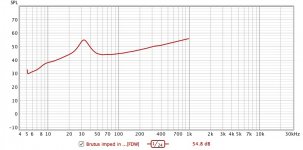

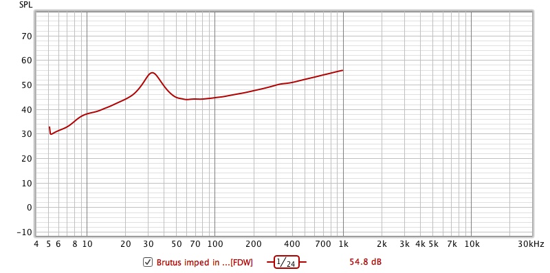

If you put a Brutus BRZ-15 with Fo of 21 Hz into a semi-stuffed box of 5 cu feet, the Fs goes to 32. Small boxes waste Fs.
(Ignore the scale numbers.)
B.
B.
