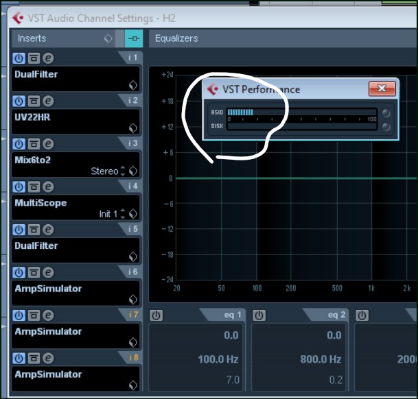

PC's, even a rasPi, can handle all the taps we can eat.

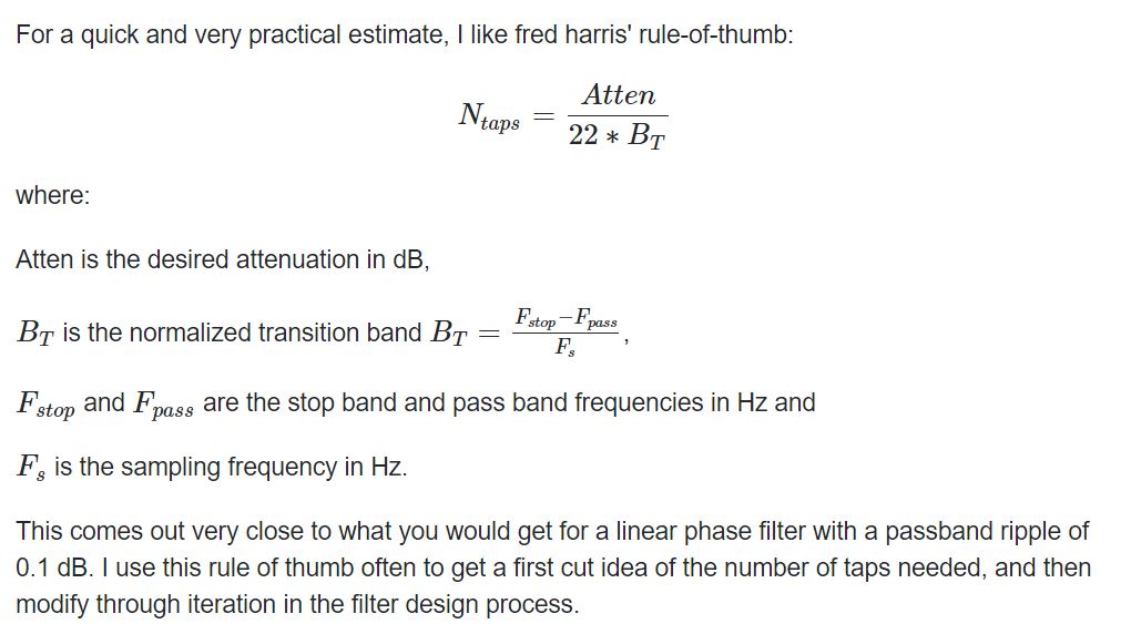

Still can't see why so many taps would be needed, though.
Have you found doing so evens out low end response over a wide area, or is it back to a spot?
Here's an old rule of thumb re taps required, in case it's of interest...

To be honest if you want to try FIR ( for filtering not DRC) a dedicated processor is not the way to go imho: a pc some older software and plug ins and a multichanel soundcard is way cheaper. I run a secondary system with a dual 3ghz pc with 2giga ram under windows xp with an Aardvark soundcard- previous brand of Antelope engineers-. Overall cost including soundcard is below 200euros and sound is great ( Aardvark sounded very good and 'warm', a bit like older ( first gen?) Apogee converters which mimiced tape saturation).
I agree this is not plug and play, it won't run at 1megahertz sample rate ( please could someone explain me what is the interest of very high FS, when 90% of studio run at 96khz max and more often 44,1 or 48k?), you'll need to setup a daw or vst host and use virtual cables and drivers... yes it is a bit technical but if you enter FIR you'll probably have to do that kind of geek occupation anyway.
