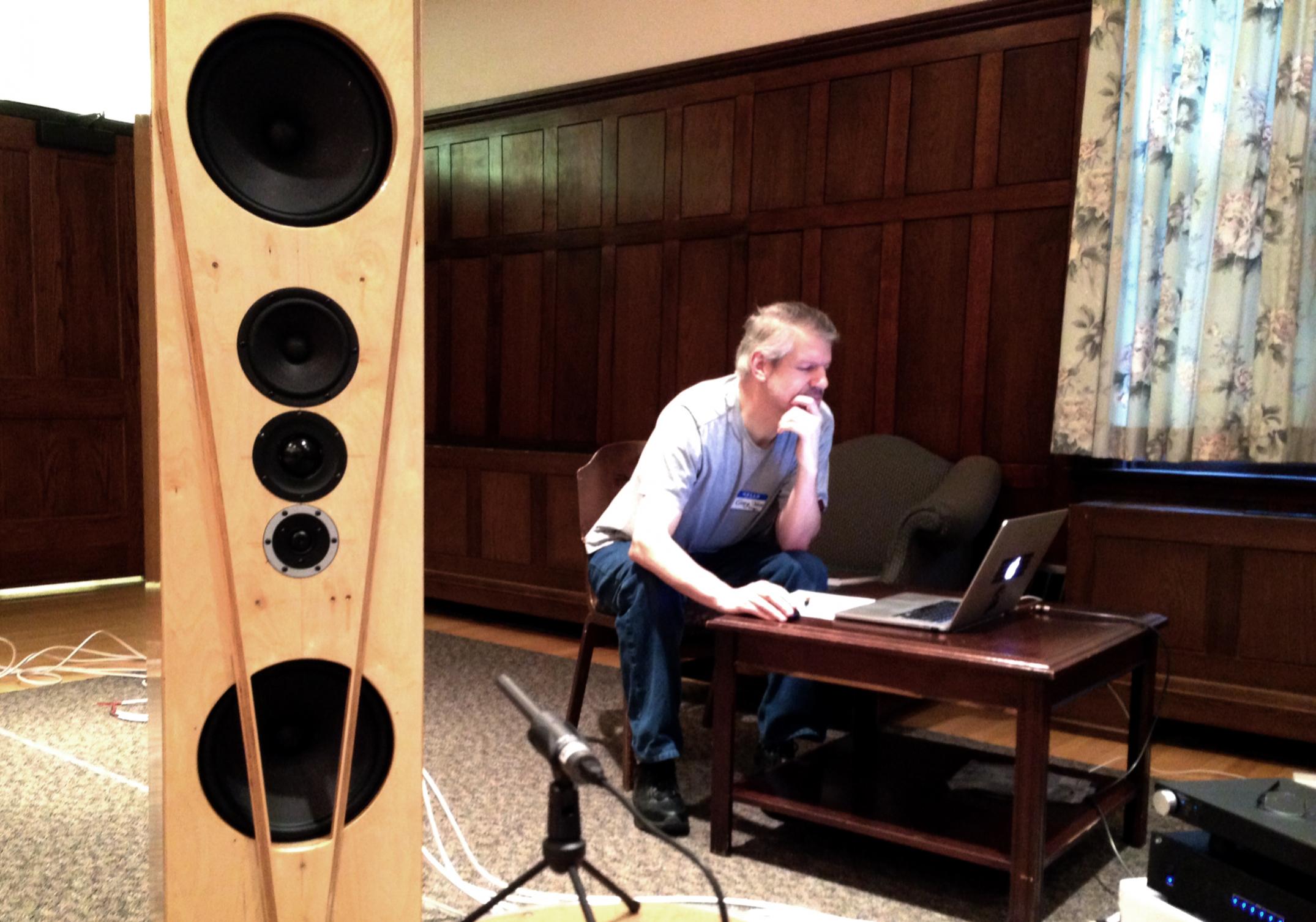

4 way digital active for one year now and will never bother with anything other than digital active (nothing against those with passive systems and skills).
Still have significant work to do, but already hear enough good stuff to know these will equal or exceed anything I could have purchased with the same budget. I don't pick up any multi-way defects indicating lack of integration and/or cohesion. I do believe that any crossover point can be designed to sound transparent, but here is my rational for the current configuration of my Javelin speaker project:
Satori tweeter crossed at 1.6 kHz as I feel this point is low enough to bring out the best of the Satori and avoid the most critical range of 2-4 kHz where the human ear can be very sensitive but yet high enough as a crossover point with 48 dB slope to prevent any stress or strain.
Morel mid dome at 800 Hz to 1.6 kHz to protect it from any strain and because I think Geddes is onto something by being very careful to have constant directivity from this point upwards. The mid and tweeter dome have distortion and directivity properties that are easy to unify and I can not hear any lobing interference despite the C-T-C between mid and tweet.
Satori mid from 200-800 Hz so that vocal range and phase through this range is clean and easy, and a pair of Vifa 12 NE woofers on each channel to cover 20-200 Hz
On some source material, this is as good as any system I have ever heard, but more measurements and optimization is in the works.

48 everywhere ?
Seems like you had thought through your system very well. Are all your crossover slopes 48db/oct L/R ?
Yes, for now everything is 48db/oct via miniDSP 4x10 HD.
I keep waiting for a similar product with more DSP horsepower and FIR filter options while still being as nice of a turn key hardware/software/GUI product as the miniDSP but nothing yet.
I keep thinking I need more audiophile approved DAC sections, but no complaints when I just listen to the music and stop thinking about the "gear". The truth is that I could easily live with this digital active crossover solution for many years even though I would gladly pay 3 or 4 times as much money for the product I am waiting for, but I think the 4x10 HD is a fantastic product at a great price point, mad props to miniDSP.
I also recently upgraded my power to a decent used Adcom amp for the woofers and still using the Dayton MA1260 for the rest. Next upgrade will be better class D amps on mid dome and tweeter with Crown drivecore 2 on woofers and mid-bass.
