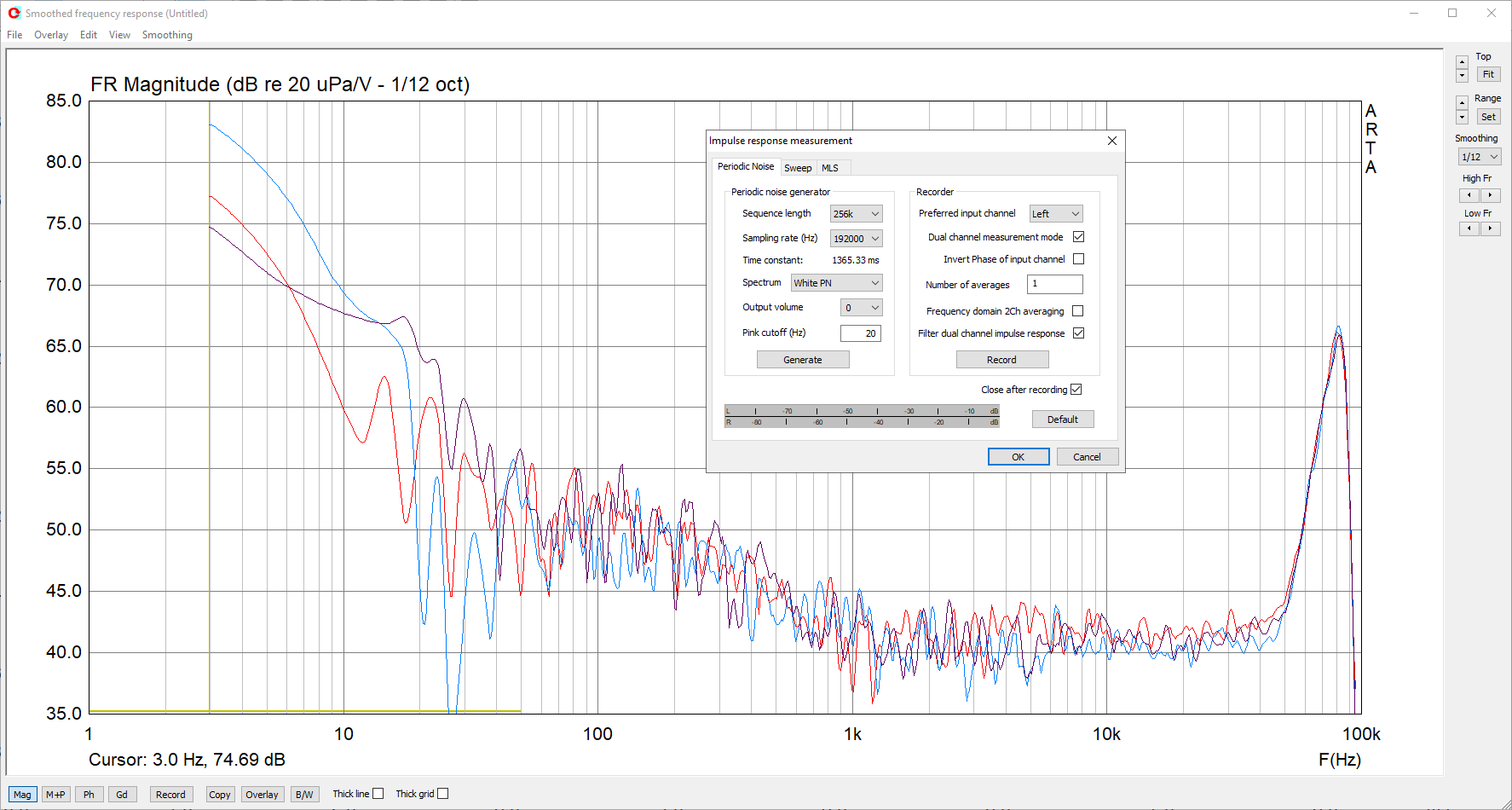

Motu M4 channel matching I would say is very good as well:

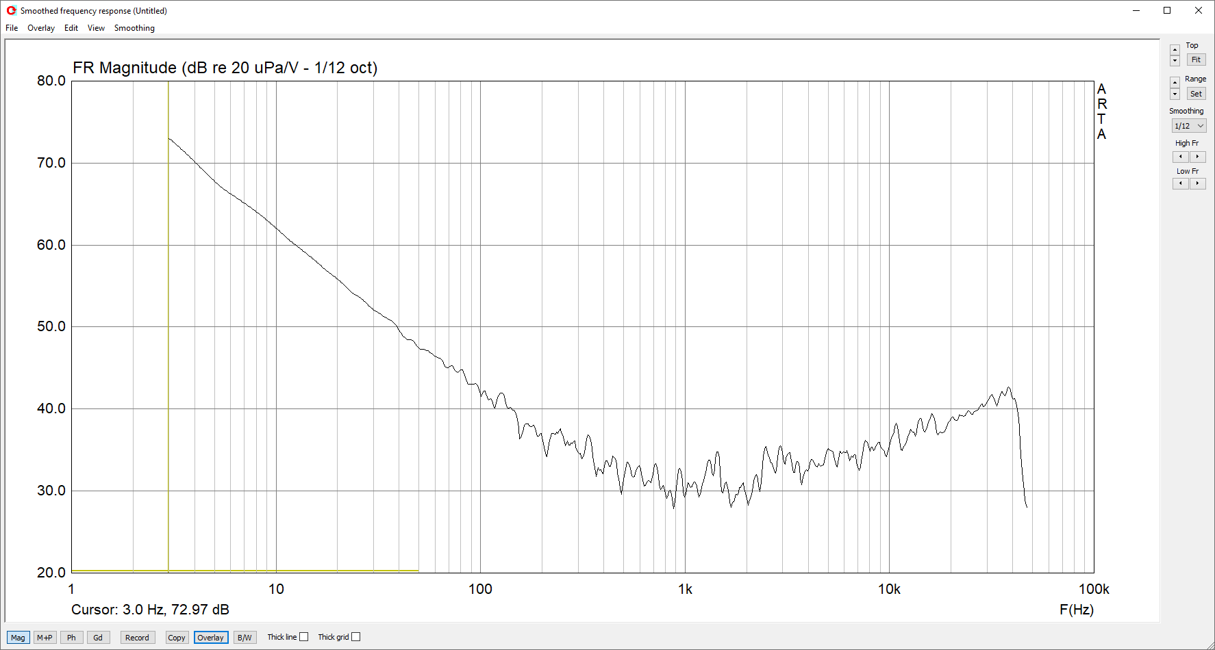

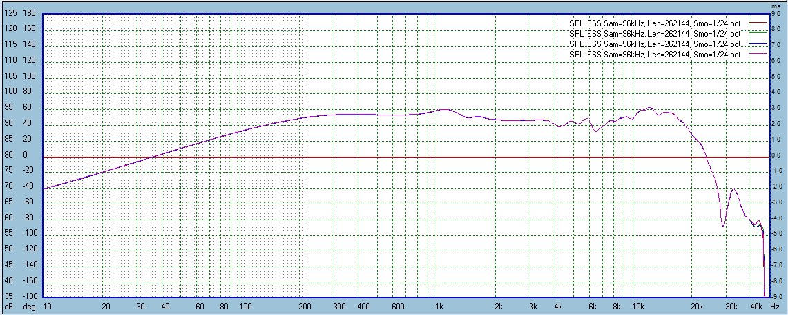

Just for a bit of additional information, I can provide some comparison with SoundEasy and REW included as well. I took a little bookshelf speaker, and measured in ARTA with sine sweep, 4 measurements overlaid, hanning window at 4.3ms.
ARTA Sine Sweep, not very good consistency / repeatability at low frequency:
Same sine sweep measurement in SoundEasy, same hanning window at 4.3ms provides very good consistency / repeatability:

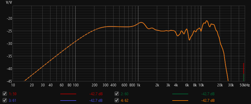

Same result in REW, sine sweep presents no issue with consistency / repeatability, in fact the measurements are perfectly overlaid that you can't see the other three, you'll have to take my word that 4 traces are shown.
Based on this, I don't see the problem as anything inherent to a dual channel sine sweep measurement, or the Motu M4 hardware.

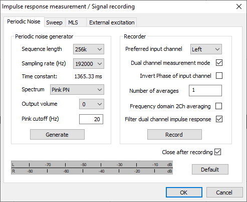

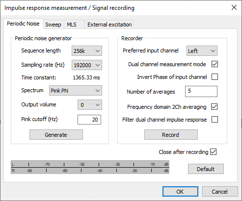

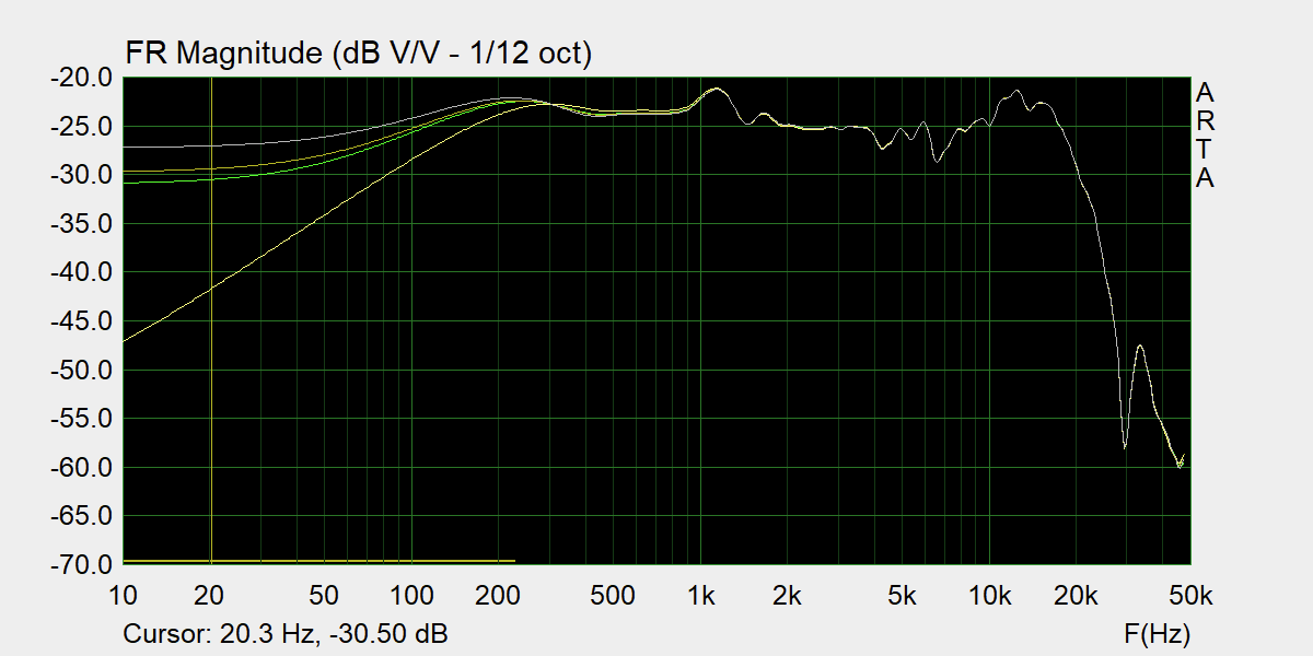

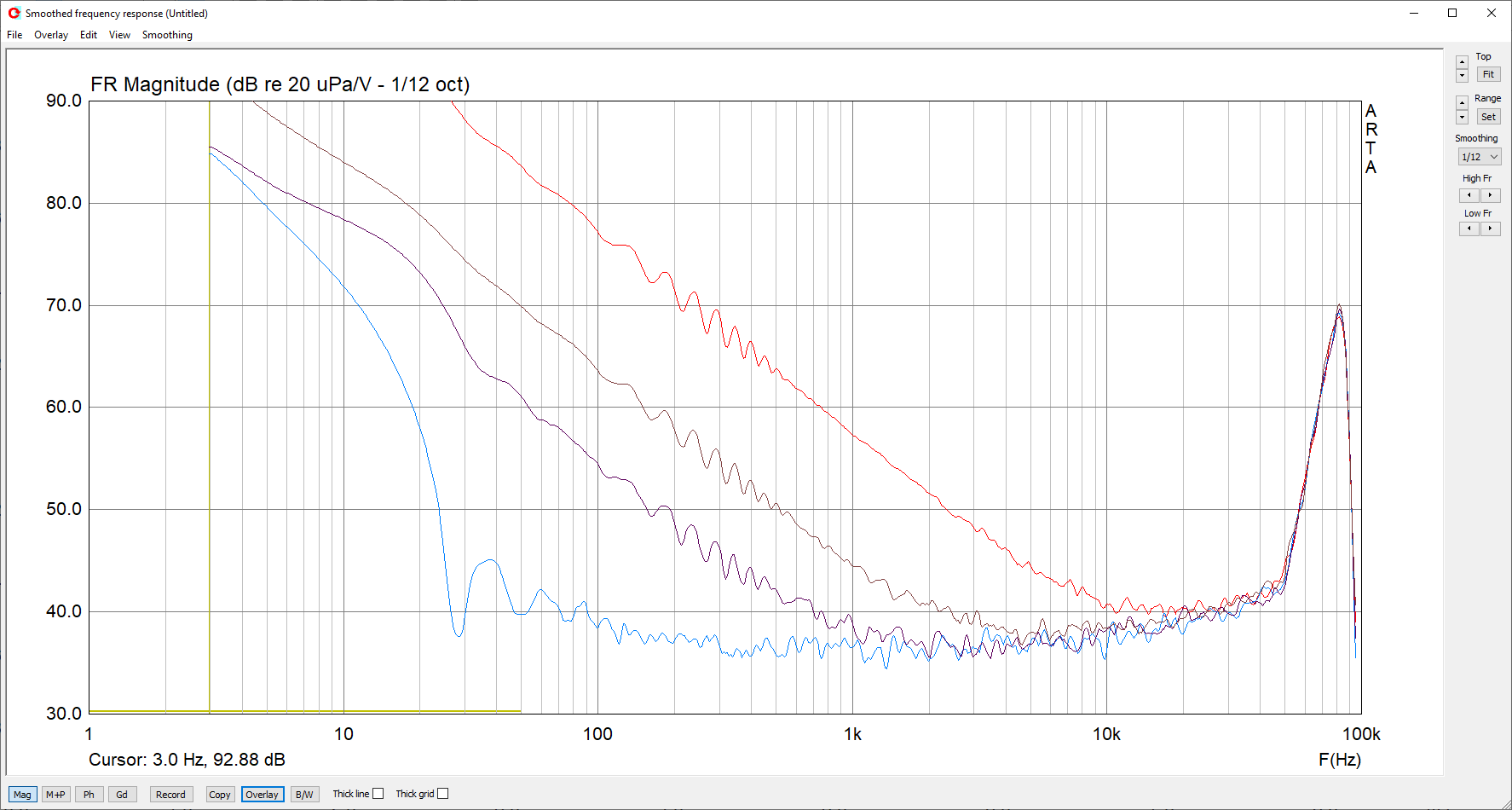

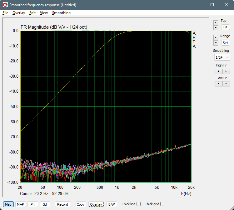

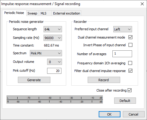

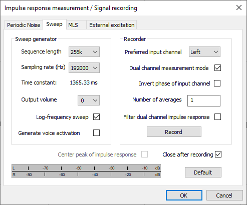

Yesterday and today i did the same tests, to see how much it varies.
In short the sine sweep has what appears as a DC offset effect, rising with ~6dB/oct towards lower frequencies, also with occasional a serious outlier ?!
Periodic Pink noise is the best option. Periodic white noise is worse. Lower sampling frequencies and/or lower FFT periods does not significantly change this behaviour.
Sweep: (IMP-Setting-10 ; IMP-Setting-10-IMP-View ; IMP-Setting-10-SeveralTimes-FR),
Periodic Pink Noise:
(IMP-Setting-11 ; IMP-Setting-11-IMP-View ; IMP-Setting-11-SeveralTimes-FR) although at very low frequencies (<20Hz) again a rising curve of ~ 6 dB/oct:
At lower sample frequencies and FTT length, in essence the same:
(several measurements litterally the same output!)
Periodic White noise is worse compared to periodic pink noise:
Reactions: 2 users

Thanks for your verification. I agree that with sine sweep there is occasional outlier, perhaps 1 in 10 measurements appears very good, but repeatability for exact same measurement conditions is not good, which is a problem in itself in addition to the rising noise floor at low frequency. In any case, it appears that Ivo has been able to reproduce this with some of his own measurement equipment and is looking into it. In the meantime, periodic noise is the solution.
For your PN measurement, below 20Hz you are likely seeing rolloff of equipment frequency response, so this behaviour is expected. single channel loopback will confirm.

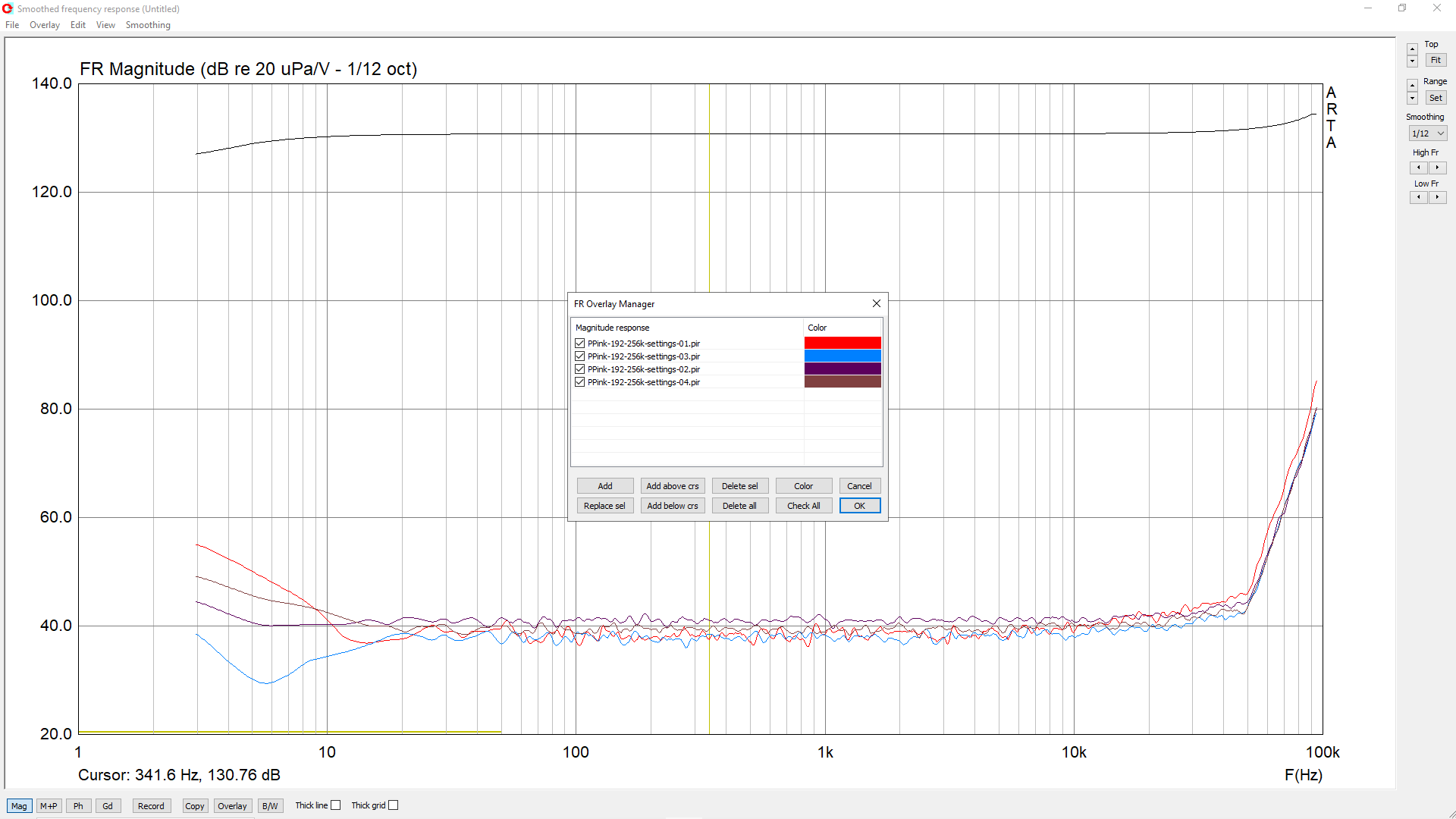

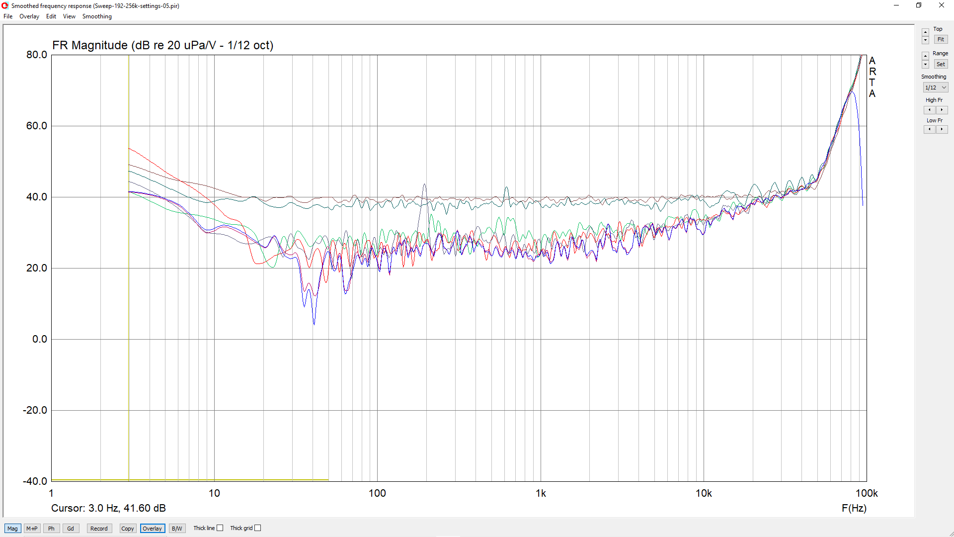

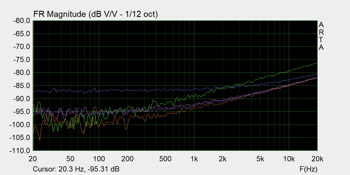

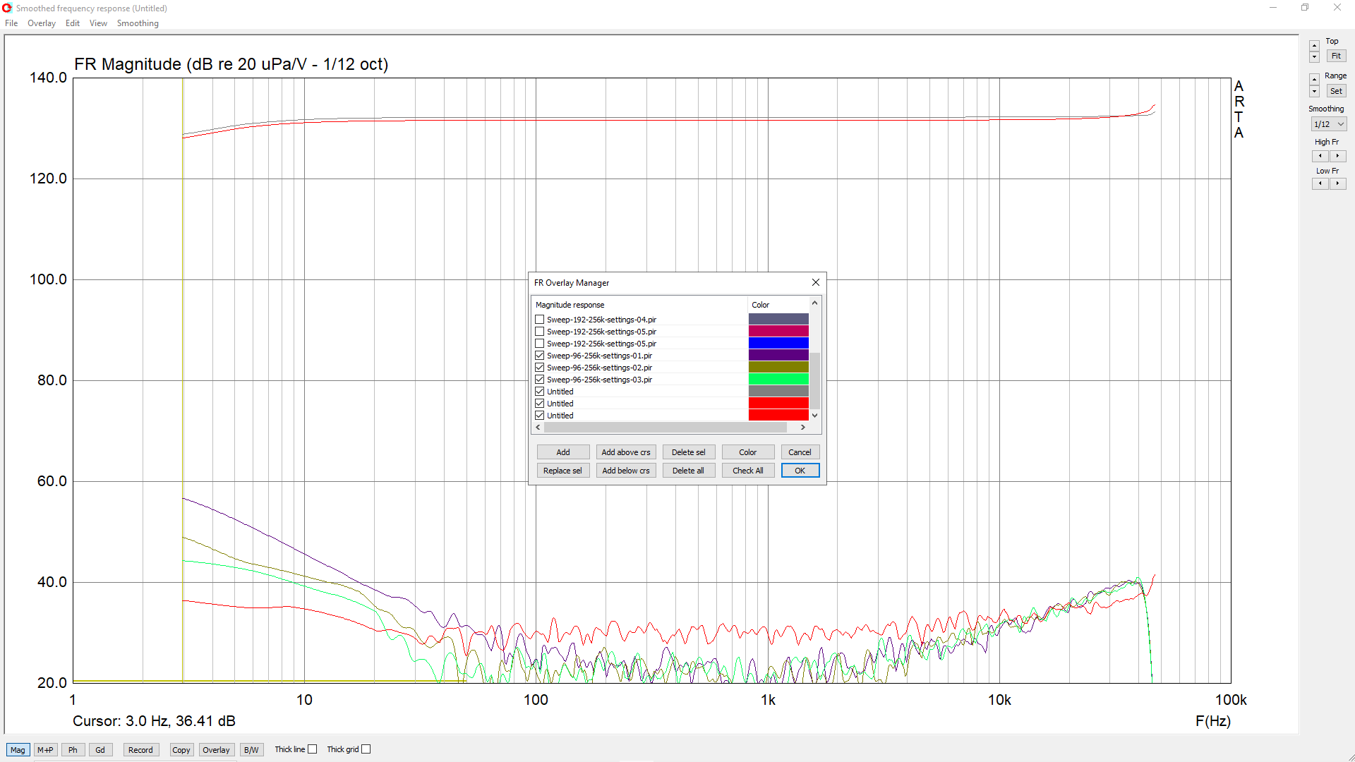

Thank you Ivo!
I have checked the new version, and while there is still some small error in repeatability of sine sweep measurements, the overall noise floor is incredibly improved. In the image below, same noise floor measurement as previous, with no input and -10dBFS reference channel. Solid green is periodic noise, the overlays are sine sweeps, 1 of 4 measurements is a bit out of place but overall the result is a huge improvement!
Reactions: 1 users

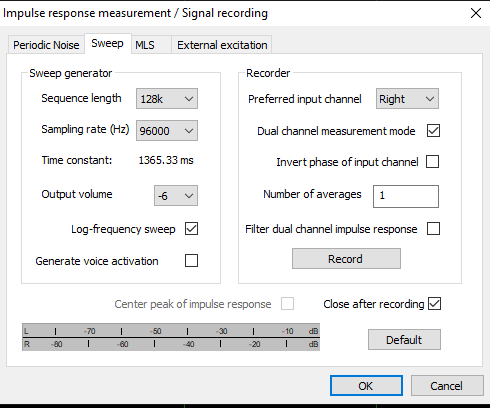

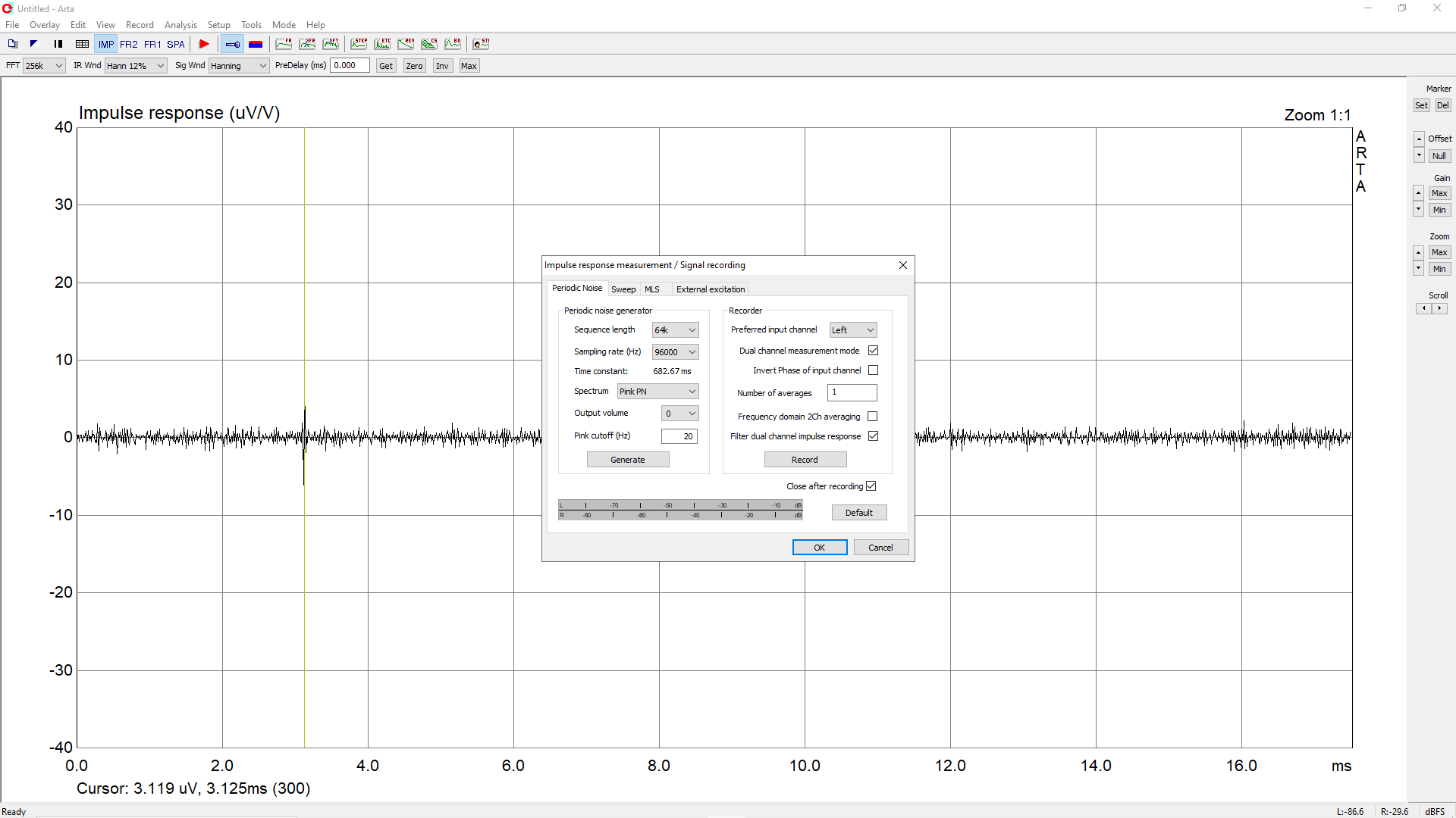

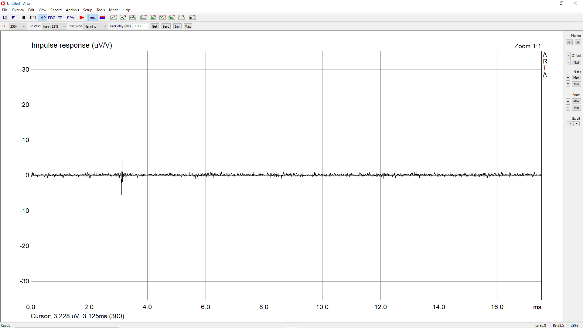

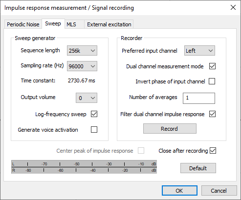

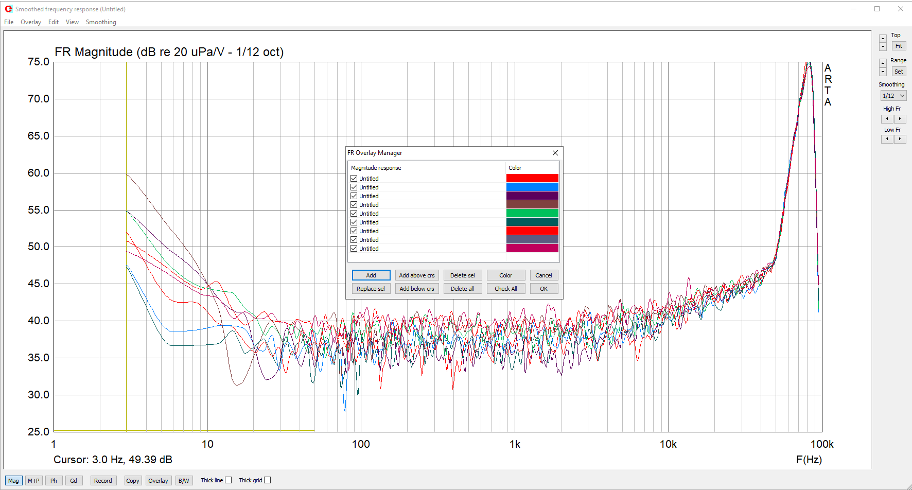

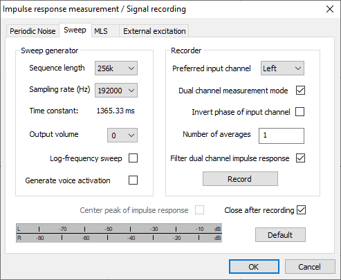

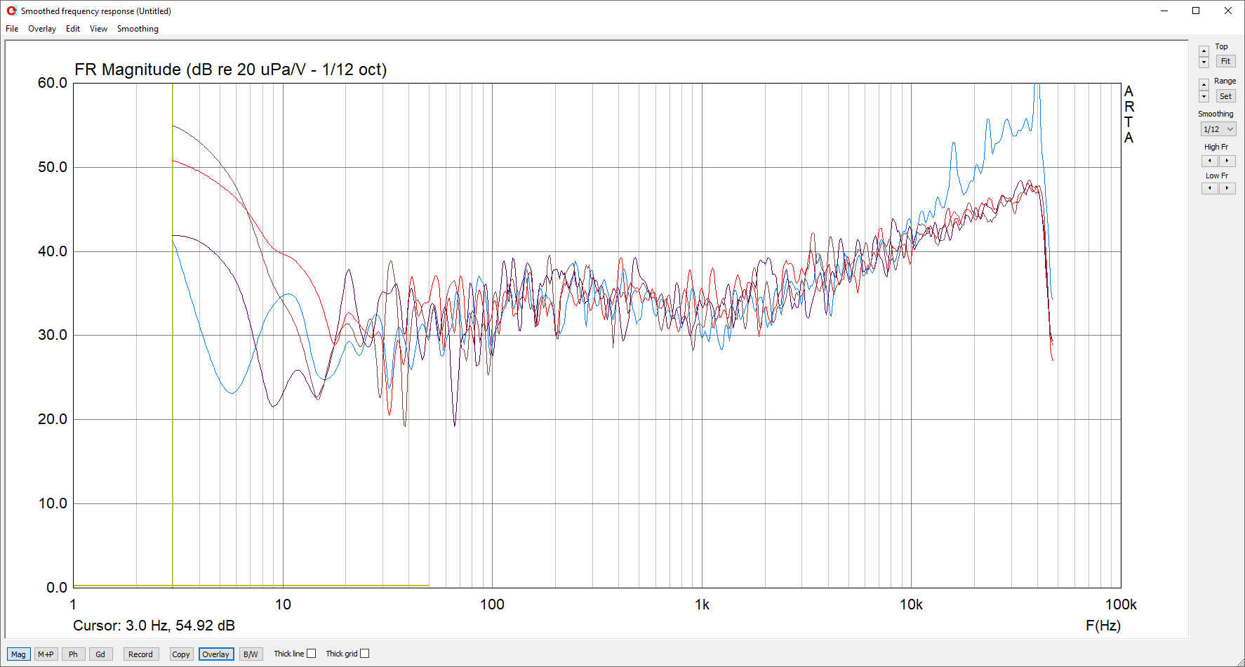

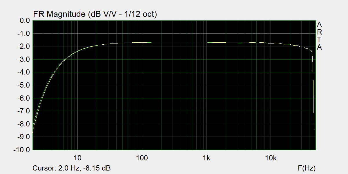

Tested ARTA 1.9.6:
My conclusion:
Significant improvement over Arta 1.9.4 : a level to noise of 90-100dB, less strong outliers if any. The typical "wing" is below 20 Hz of even below 10Hz and less pronounced.
Case PPink-256k:
Result:

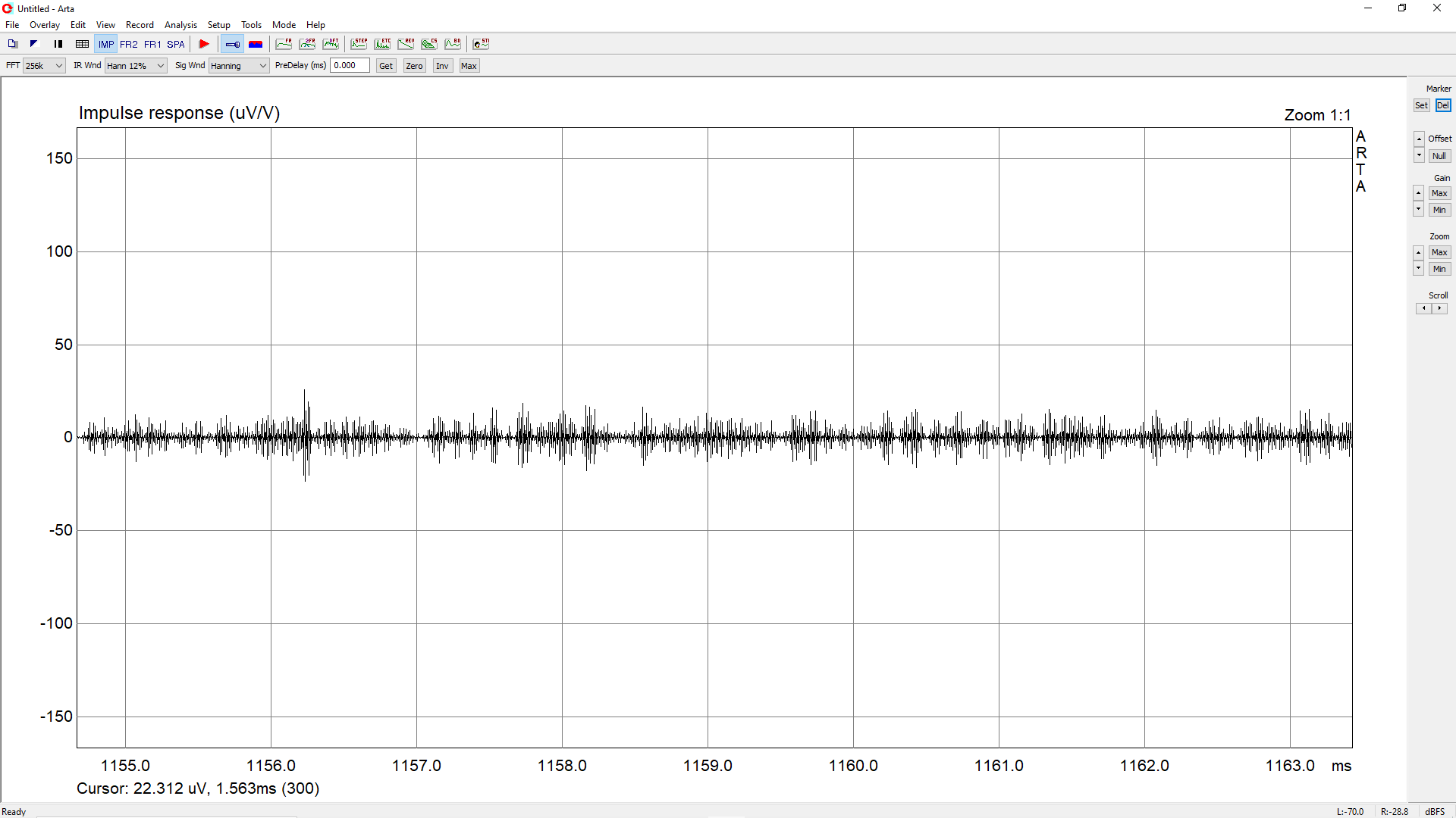

Note: Home button (sampling zero is 300):
If cusror at 270 instead of 300, it makes some difference, still prefer the 300 samples home:
Case Sweep 192kHz:
Quite good as well, but occasionally a not so strong outlier, also the Home (300) vs cursor at 270 makes a not so significat difference.

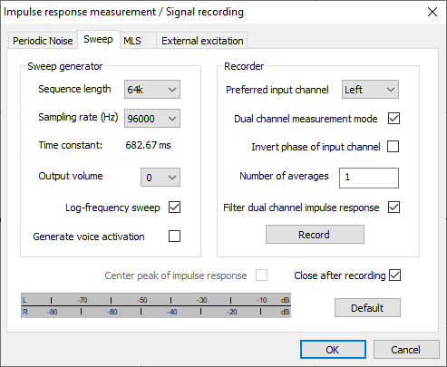

Case Sweep-96kHz:
Basically same picture with 96kHz-256k:
Note that the position of cursor has an effect, both in level(ampliture) and in pattern of the open input noise(in overlay the bottom two entries (red, level, noise) are with cursor at 300 samples.
