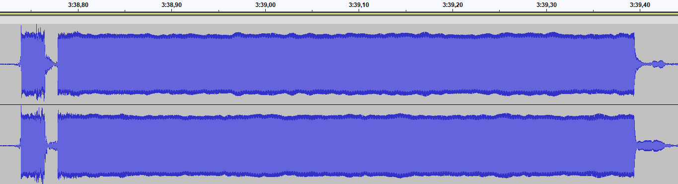

Might that be what leads to weird signal form in sine bursts in STEPS when I do a distortion limited Max. SPL run at 192 kHz (needed to measure HF response) on a native (Windows) 48 kHz setting?
Can be heard here:
Signal form looks like:

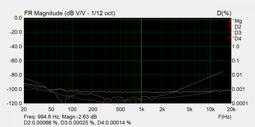

FWIW, here's the distortion numbers on my external, bus powered USB interface (Motu M4).
Loopback measured at 2V output, input level adjusted for about -3dBFS.
