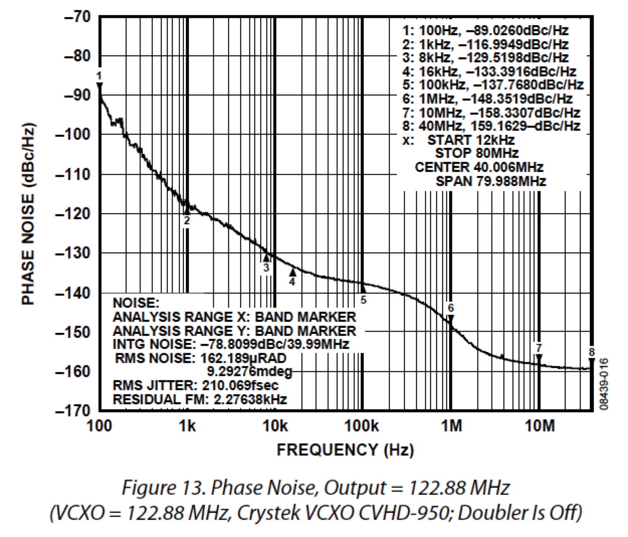

AD9525 total overkill ???
Some numbers are impressive but -89dbc/hz at 100hz is not the best we have seen.
Yes I agree, but a lot better to hear the noise in the higher audio band where its will be more pronounced. I would rather have it where its nearly inaudible rather than in the 8K - 20K range....
