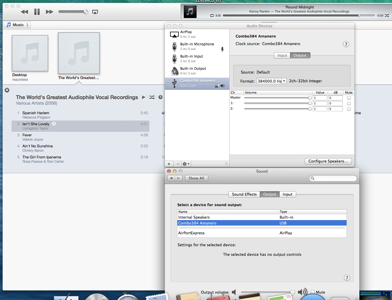

384Khz
I am only six and a half foot tall and short of brain, so this counts for me too!
One time our Guru says it works, another time the opposite.
The thing I know, by trying, is that I can not manage higher than 192 with the dual board + 45/49 and the 1794 DDDac. But it can with the 570 board.
Think I have to go back to school.....or find me some fresh braincells.
Now back to the music,
have a nice sunny weekend,
Ed
Thanks for trying this, Ed.
Even if nothing different happens, how can it not change anything?. This is all way over my head BTW.

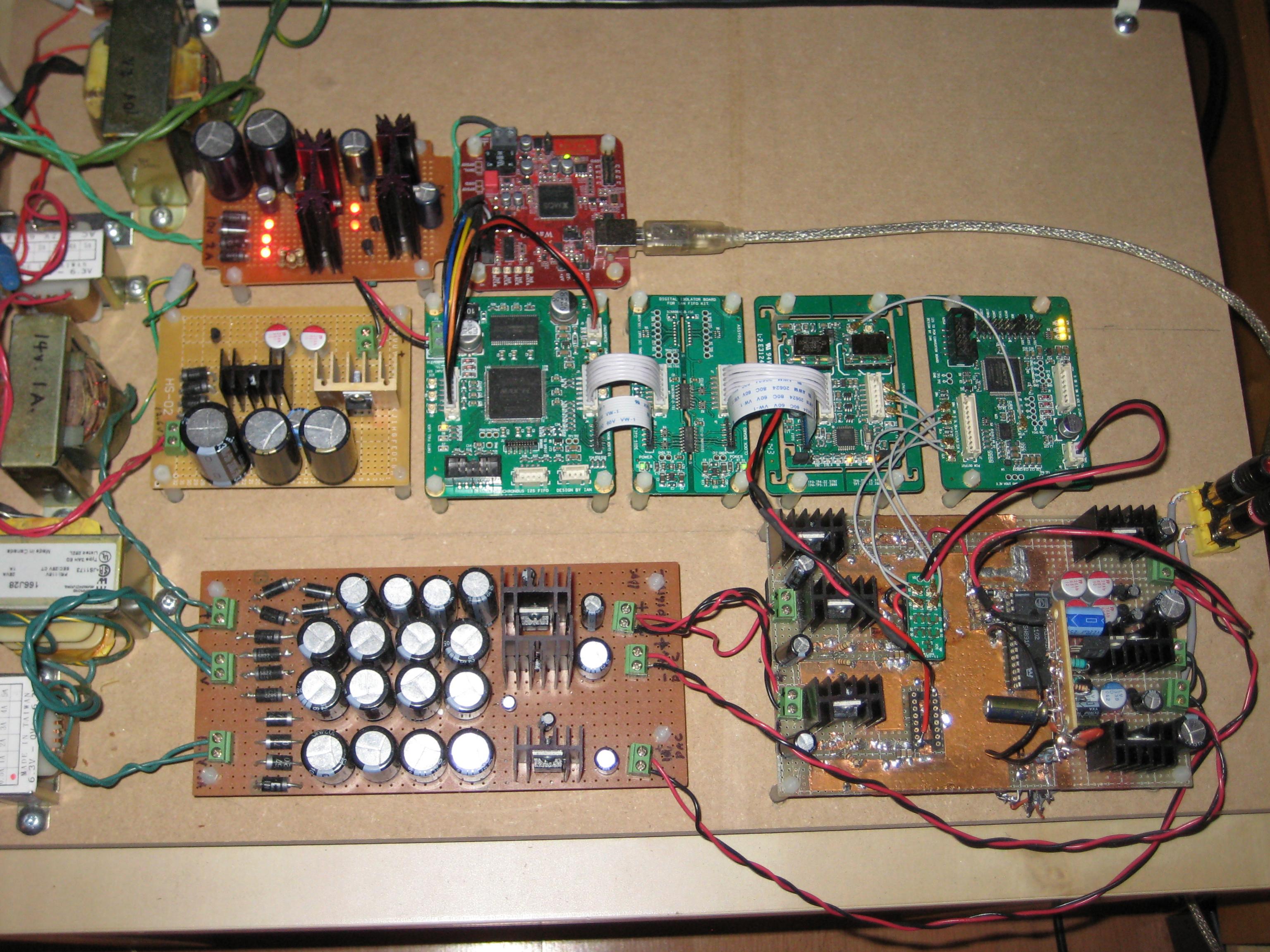

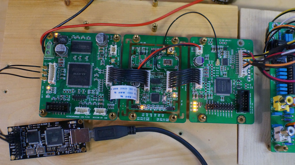

Hi Ian,
Before sending the board to you, I thought that possibly my power supply feeding the Dual Clock board and one half of the isolator was not supplying enough current since there is a CCS in the power supply.
To check the Chrystek 45MHz xo, I tried the 45/24 combination and it worked. So both Chrystek xo frequencies are working properly.
I then upped the CCS current from 70 mA to 120 mA and tried the board with both Chrystek XOs in place and again, the leds did not light up. According to the Chrystek data sheet, the XO draws a maximum of 25 mA and I have increased the current available by 50 mA to accommodate the second Chrystek XO. Is 120 mA enough for the Dual clock board with Chrystek CCHD 957 XOs plus one half of the isolator? Or is there something else that I am missing?
Thanks for your help.
Ben
Hi Ian,
Success at last. The last time I posted, I had determined that the Chrystek XOs were ok.
After thinking about it some more, I checked the supply voltage with both Chrysteks in place. The voltage had sagged to below 3v. I then checked the data sheet for the isolators and it appears that the current requirement for them increases with frequency.
I then upped the ccs current from 125 ma to 175 ma and that did the trick. So it appears that for the Dual Clock board with Chrystek CCHD 957 XOs of 45 and 49 MHz and also powering the isolator board, the minimum current requirement at 5v is somewhere between 125 and 175 ma.
Ben

Hi Ian,
Ben
Hi Ben,
Good to know you figure out the issue. I didn't realize ccs current can cause xo stop working. Thank you for sharing your experience with others.
BTW. I like your project, the logic looks very clear 🙂.
Have a nice weekend,
Ian

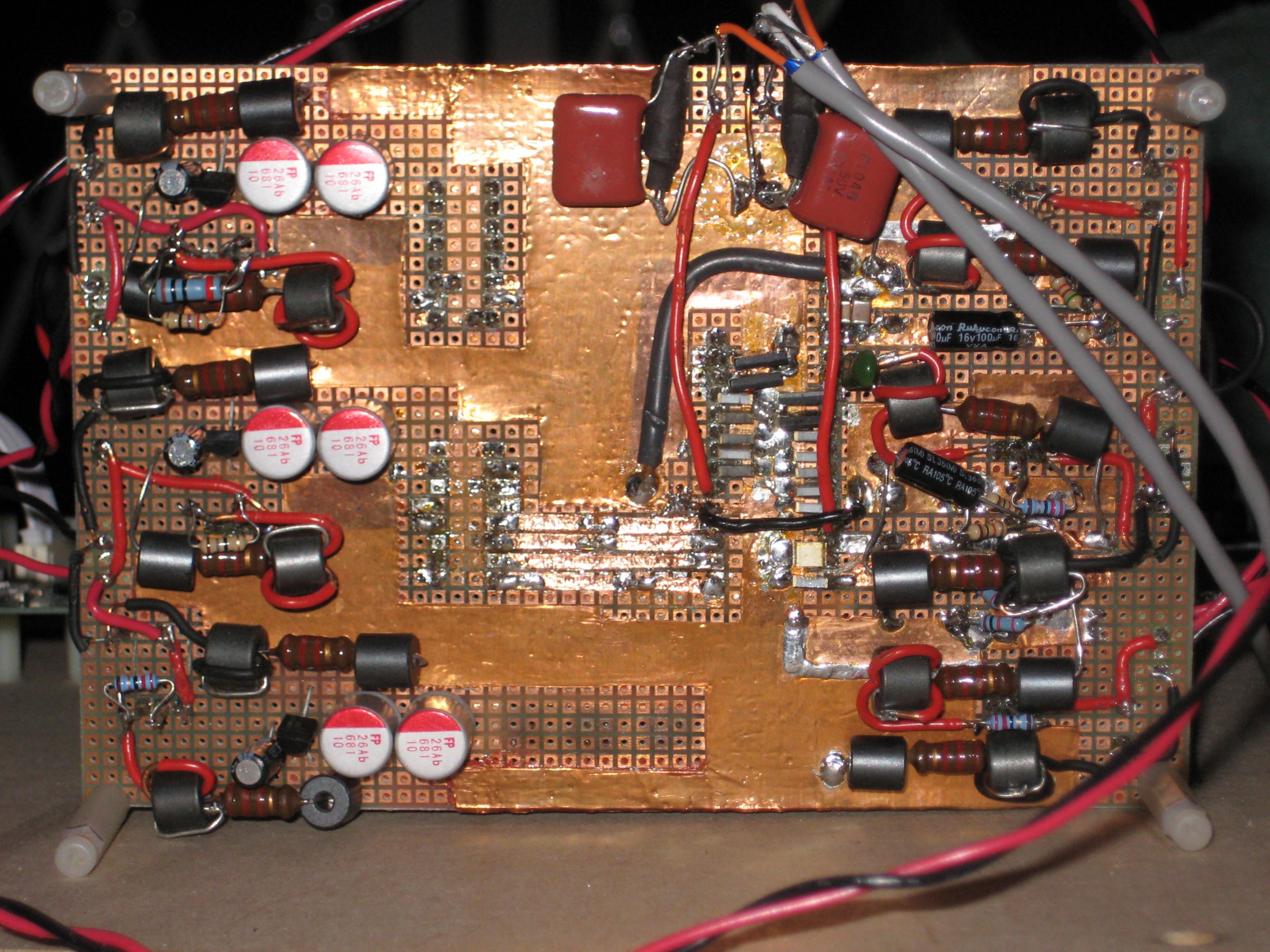

Hi Ian,
I tried to keep the wires short between the clock/pcm/dac boards so that was what worked best.
The dac is tda1541a on a copper foiled Veroboard, based on Thorsten Loesch's many posts regarding the subject a few years ago, plus also using ideas from John of ecdesigns and others. It used to have reclocking and dem clocking on the board but with the addition of your pcm board, that has been removed and their power supplies power the dual clock and pcm boards.
The addition of your boards have made a big difference in the sound, all for the better.
Ben
Ben

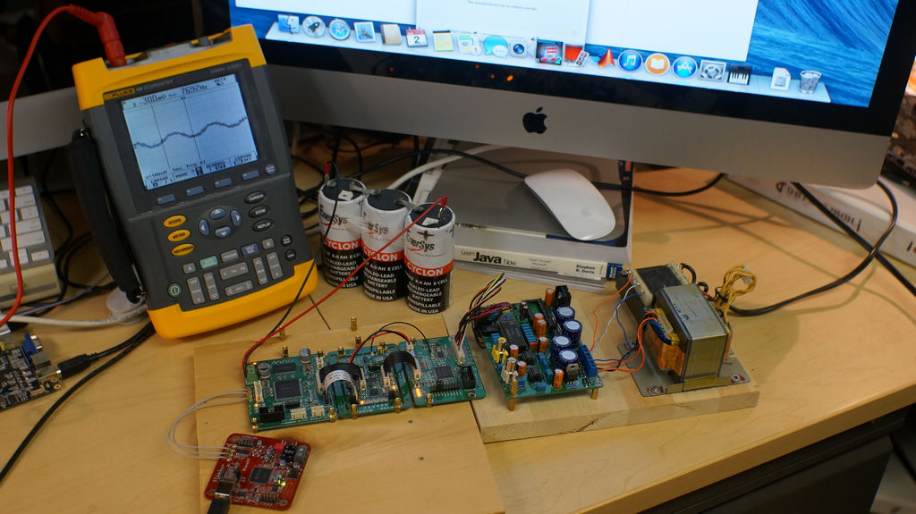

Running FIFO at 384KHz with Dual XO clock board and 45/49 MHz XO on TDA1541A
@ed linssen

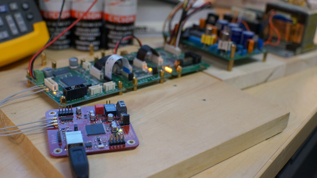

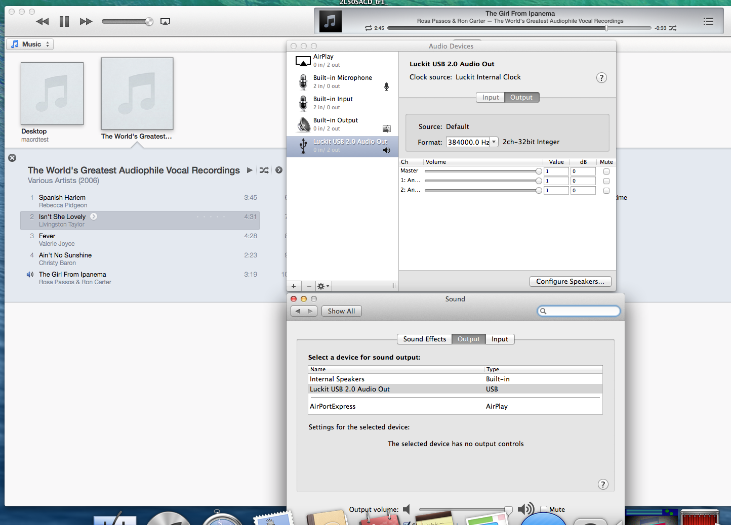

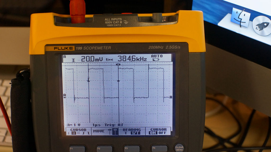

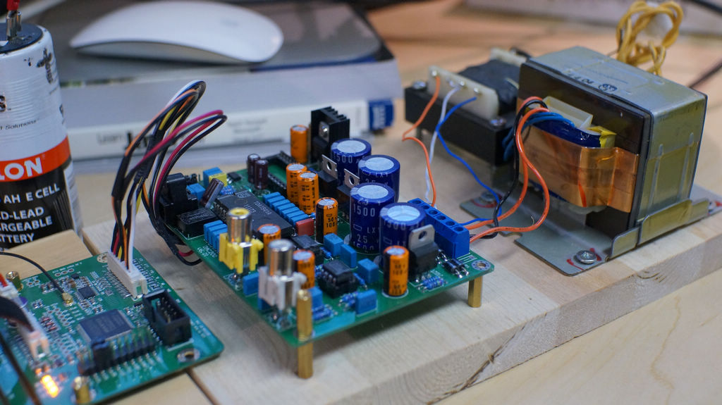

I’m so sorry for the long time delay addressing your problem.
I set up a testing fixture today running at 384KHz without problem.
My configuration is:
iMac - USB – FIFO – DualXO(45/49) – PCM board – TDA1541A DAC
Please see the pictures for the jumpers of the PCM board and other details
1. With Amanero Combo384 USB and u.fl cables, it’s running perfect from 88.2KHz to 384KHz.
2. With WaweIO XMOS USB(upgraded to 384KHZ FW) and u.fl cables without isolator, it’s also running perfect from 88.2KHz to 384KHz.
3. With WaweIO XMOS USB(upgraded to 384KHZ FW) and with isolator, it could only run up to 192KHz. Noise starts from 352KHz and gets worth at 384KHz. Maybe that’s your case. I don’t know why. I suspect the speed of IL715-3 is not enough, but I have no time to analyze the waveform by my 1GHz oscilloscope.
Some tips for 384KHz:
1. Use u.fl coaxial cables or twisted pair as possible as you can if it’s longer than 2 inches, the BCK(SCK) will run at 24.576MHz in this case.
2. If want to use isolator after USB, please try hi-speed version, for example, 150MHz data rate.
Please let me know if there is any help solving the problem.
Thanks Palmito, Thanks Ceglar for your helps.
Have a good weekend.
Ian

@ed linssen
Ian
