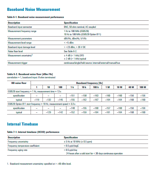

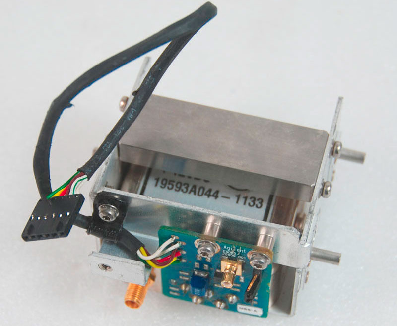

I wonder how they measure the phase noise of DuCULoN. By Agilent signal analyzer? If this DuCULoN has unprecedented performance, what's the clock inside the signal analyzer? It should be less noise than DuCULoN, right?
I think phase noise characteristics are measured by using Agilent Signal Source Analyzer E5052B. I have no idea on oscillators employed for sampling in the analyzer.
I found the picture and the base band noise figure of this particular OCXO used in Agilent E5052B. Actually, someone is selling used parts on ebay. I borrowed the picture.
It looks like it has better close-in performance than DuCULoN, but DuCULoN is better at higher frequency and so is the noise floor. Interesting.

It's very interesting document and picture!
As all of you may know, "close-in" phase noise measurement values depend on its main carrier frequency. The values increase roughly 10 dB as the frequency doubles. The OCXO unit in the picture seems to be 10 MHz one while DuCULoN is 45 or 49 MHz one.
DuCULoN employs a filtering crystal in order to reduce phase noises at a floor region. That's why the unit shows better values at the range.

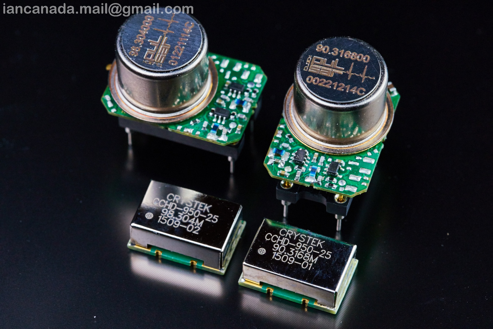

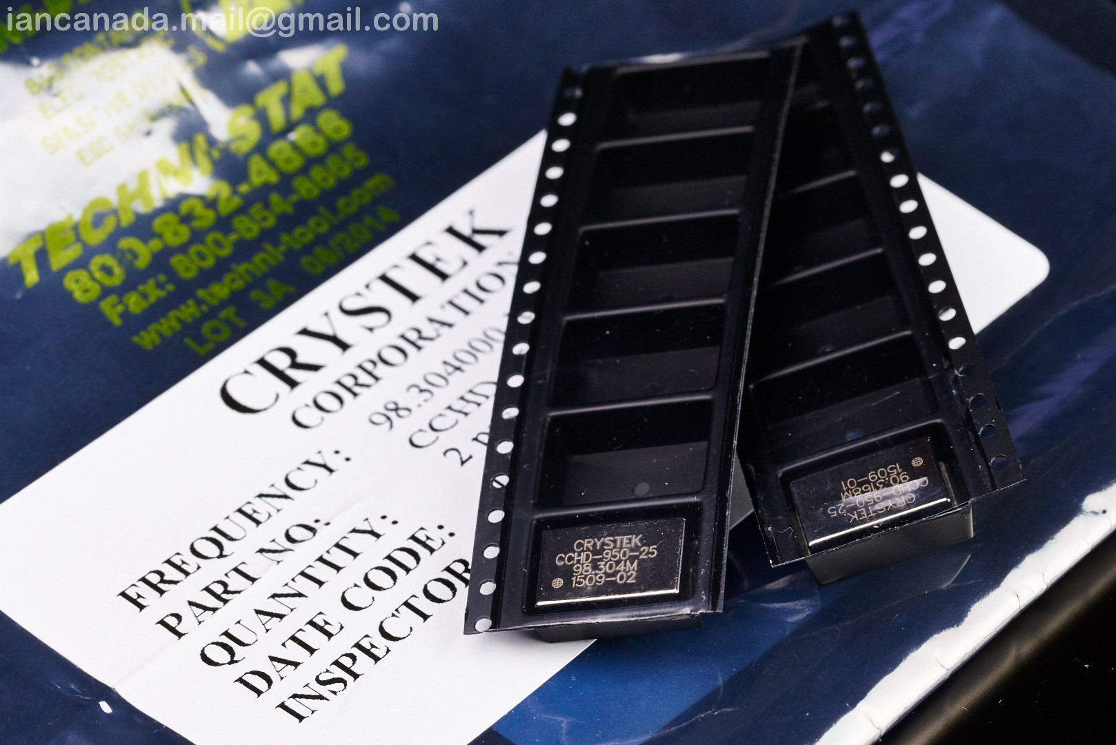

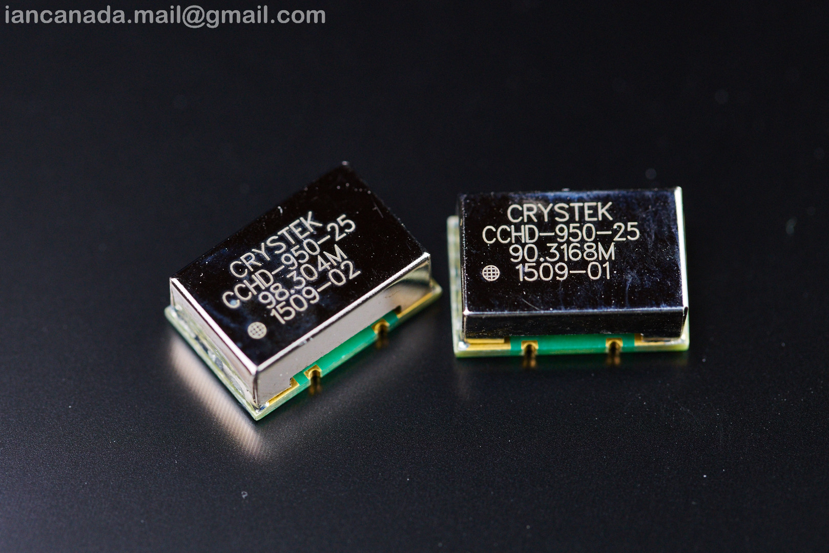

Crystek CCHD-950 90.3168/98.3040MHz
Friend of mine sent me a nice pair of Crystek CCHD-950 for evaluation. I was tied up with multi-channel I2S/DSD FIFO project. I'm gonna test them very soon.

Over at HifiDuino (http://hifiduino.wordpress.com/2012/08/27/crystek-cchd-957/) it is suggested that the CCHD-957 has significantly less jitter than the CCHD-950.
The Crystal specs suggest the same: http://www.crystek.com/crystal/spec-sheets/clock/CCHD-950.pdf http://www.crystek.com/crystal/spec-sheets/clock/CCHD-957.pdf
Unless there is something special about these Ian?

bkdog: the 957's is not avaliable at 9x.xxMHz frequencies, while the 950's are. Earlier i have only seen the 950's in 80/100MHz though, while these two are for sync 44/48 frequencies.

Thanks RollE2k,
That's what I meant
