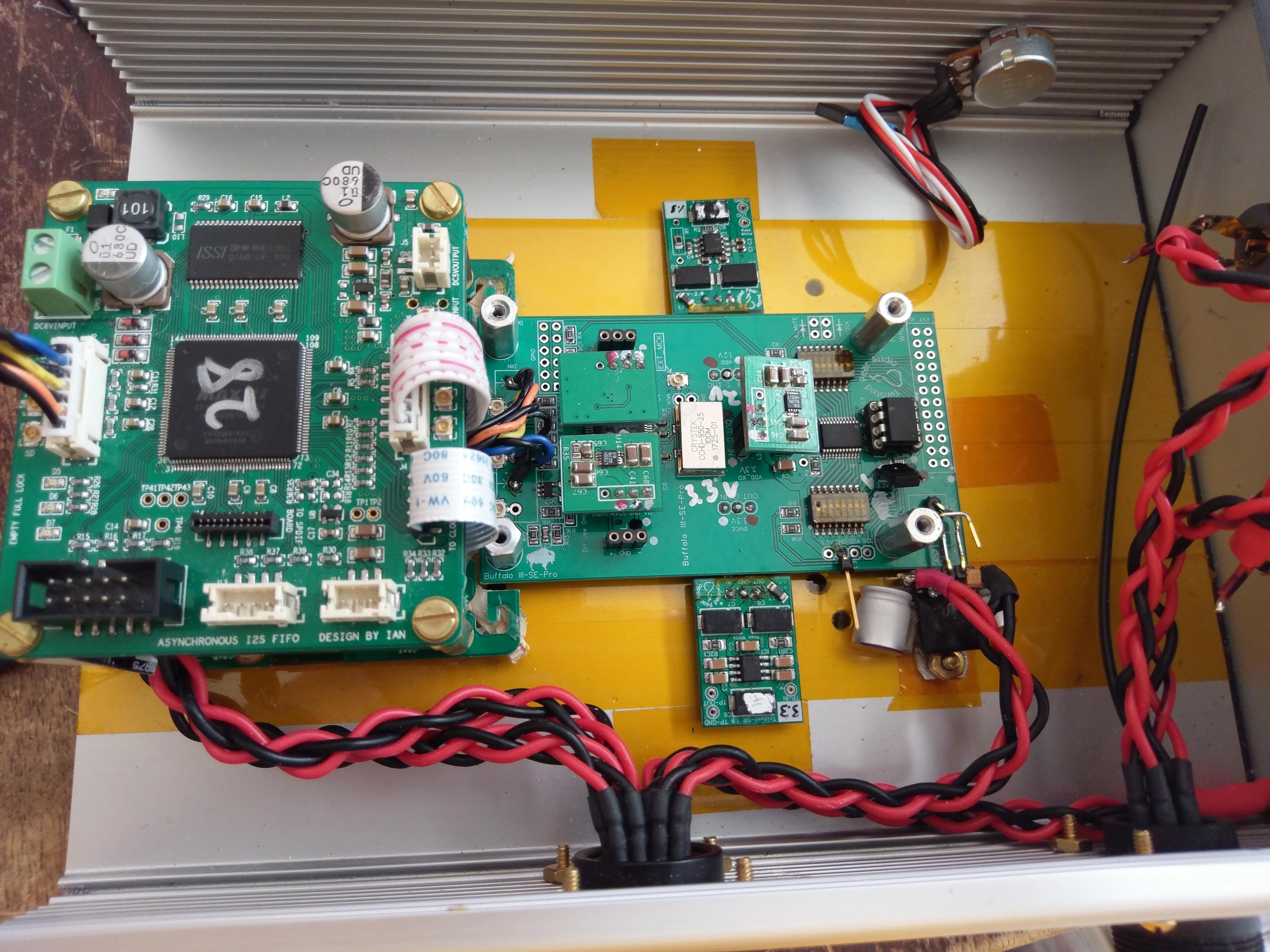

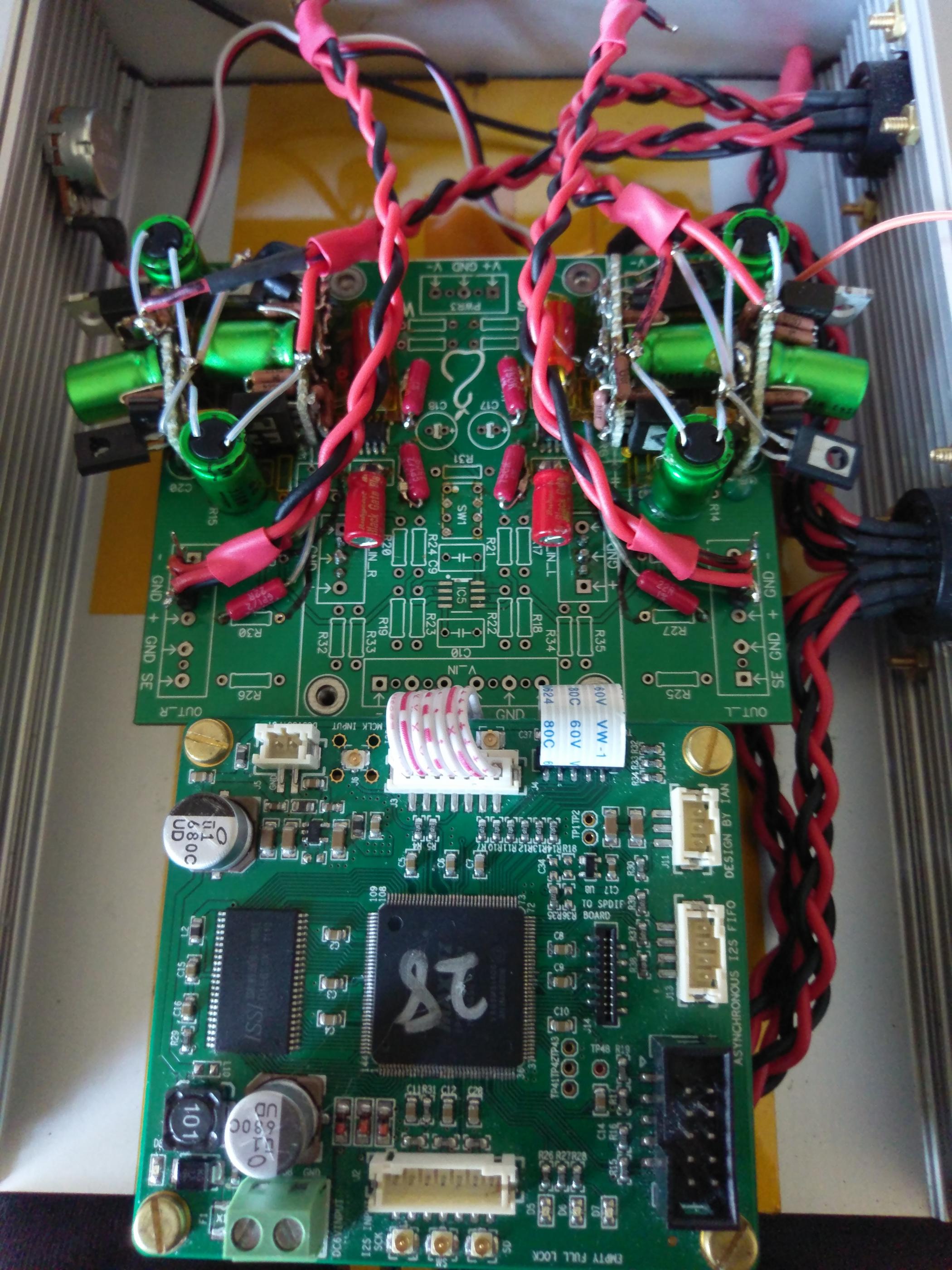

Another couple of builds using Ian's FIFO....
I haven't seen a lot of setups using Ian's FIFO-based gear posted recently, so I thought I'd put my latest up here.
I just got both of my Twisted Pear Buffalo-III Pro setups fully running. One is the ES9038 version of course into their Mercury. The other is the ES9028 version, which I've run with 2 different I/V stages. One is a 'truncated' IVY using just 1 OPA1632 per channel in the configuration Joe Rasmussen published a couple of years ago. The other is their Legato. The ES9038 won my head, the ES9028 with the Legato won my heart.
The setup is fed from a modified RPi->Ian IsolatorPi->allo.com Kali->Ian RPi I2S adapter. This goes into an original FIFO->isolator board->Dual Clock Board. A large part of why I included the FIFO setup is to provide a clock domain I can use to configure the Buff-III Pros to run in Sync mode, which some have tried and liked.
Power is a bit different than the typical setup:
- The RPi has been modified with an ldovr.com 3-rail mezzanine to provide the 1.8V, 3.3V, and 5V needed by the Pi and allow me to remove the onboard DC-DC converter. It is fed from a 6V Stammheim dual 3||LT3045 board which is fed from 2 Uptone Audio LPS-1.2 Ultracap supplies, which provide totally off-the grid power.
- The IsolatorPi and Kali each are powered by a 3rd & 4th Uptone Ultracap supply, LPS-1's here.
- The FIFO & DAC boards are powered by an array of 4 normal-ish power supplies with each sporting an oversized toroid, good fast-recovery diodes, and a 47000uF Jensen 4-pole cap. The FIFO & isolator input side are fed via one of Ian's TPS7A4700 boards set to 6V. The isolator output side and Dual Clock board are fed via an Acko AKR75 ADM715x-based regulator set to 5V. The Buffalos get their 5V VD from a Belleson SPZ 8A regulator mounted right on the DAC board, with the on-board regulators split between 2 TP Trident SR's for the 1.3V VDD & 3.3V DVCC and 3 LT3042-based boards OPC had made when he was still active here, 2 for the AVCC L&R and 1 for the VDD_XO.
The FIFO and Dual Clock board get their own supply with the DAC board using the 3rd. The 4th is there for later experiments with separately powering the AVCC rail.
- The I/V stages have a +- supply similar to the ones for the DAC and digital front end, but with an appropriately-sized R-Core transformer instead of a toriod. Each board has a set of 4 discrete regulators providing +-15V to each channel of the board... the 'truncated' IVY is fed from small shunt regulators of a design from Ric Schultz of EVS (sorta like a simplified Salas), the Legato has 4 of the new discrete Dexa regulators, and the Mercury has 4 of the discrete Sparkos regulators. Right now I'm running them in single-ended mode, but they'll get moved over to balanced as I finalize their configurations.
I worked hard to keep the signal runs short and direct along with short power supply runs and closely-placed regulators, drawing a lot of inspiration from Twisted Pear's DAC board design.
The great sounds I'm getting from each configuration are due to a lot of outstanding building blocks... Twisted Pear, Ian, OPC, Ric Schultz, Acko, Dexa, Sparkos, Allo.com, ldovr.com. BUT by count, Ian has more pieces in this setup than anyone else. THANKS for the great digital audio components that make DIY'ing gear like this possible... and sounding great!
Greg in Mississippi
Greg in Mississippi

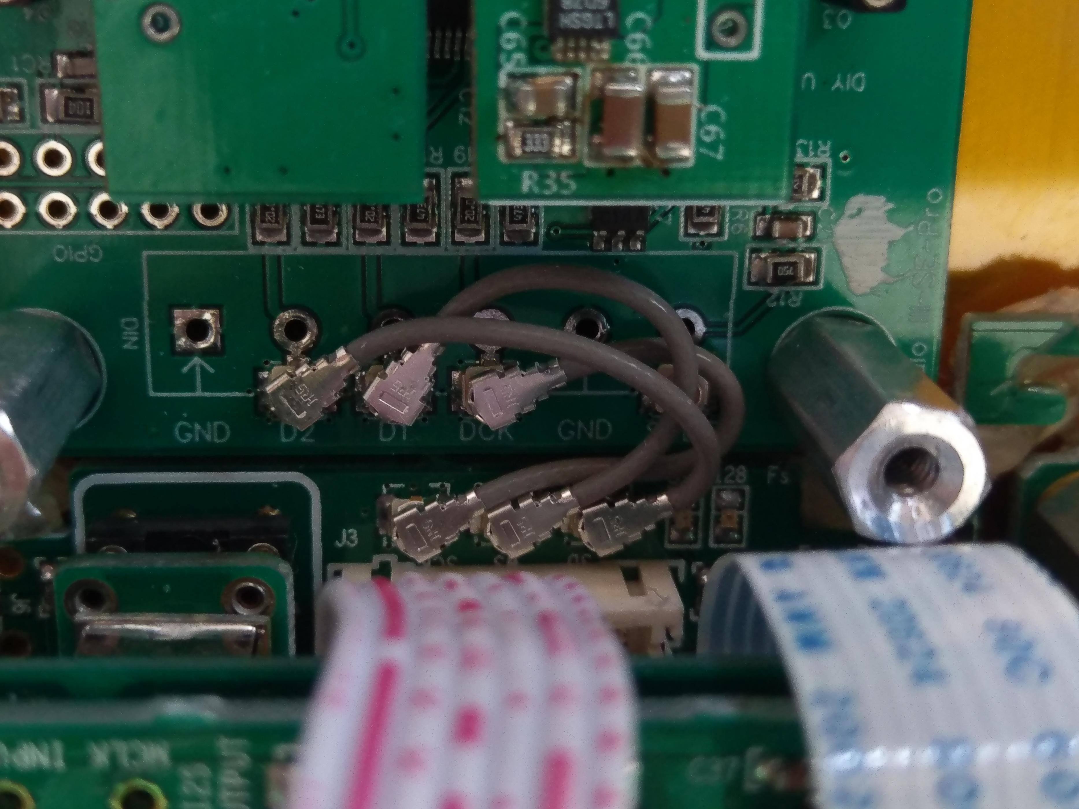

@ Greg,
Where did you find those short u.fl cables?
I think they're these Ian: http://uk.farnell.com/hirose-hrs/u-fl-2lp-088k1t-a-50/cable-u-fl-u-fl-50mm-50ohm/dp/1688071
Lovely work Greg - always like reading your posts!
@iancanada, @Crom, thanks for the kind comments.
Crom, you hit the nail on the head with the u.fl cables... the ones I ordered were these:
U.FL-2LP-066J1-A-(35) Hirose Electric Co Ltd | Cable Assemblies | DigiKey
Same line from Hirose as you posted. My ultimate intention is to hard-wire one end (likely the inputs to the DAC and FIFO)... does anyone know if the carefully engineered & implemented u.fl connections are better than if I carefully cut and prepare the u.fl coax cable and soldered them in? I've done this before and have a pretty good process and technique, but I'm not sure if it is actually better.

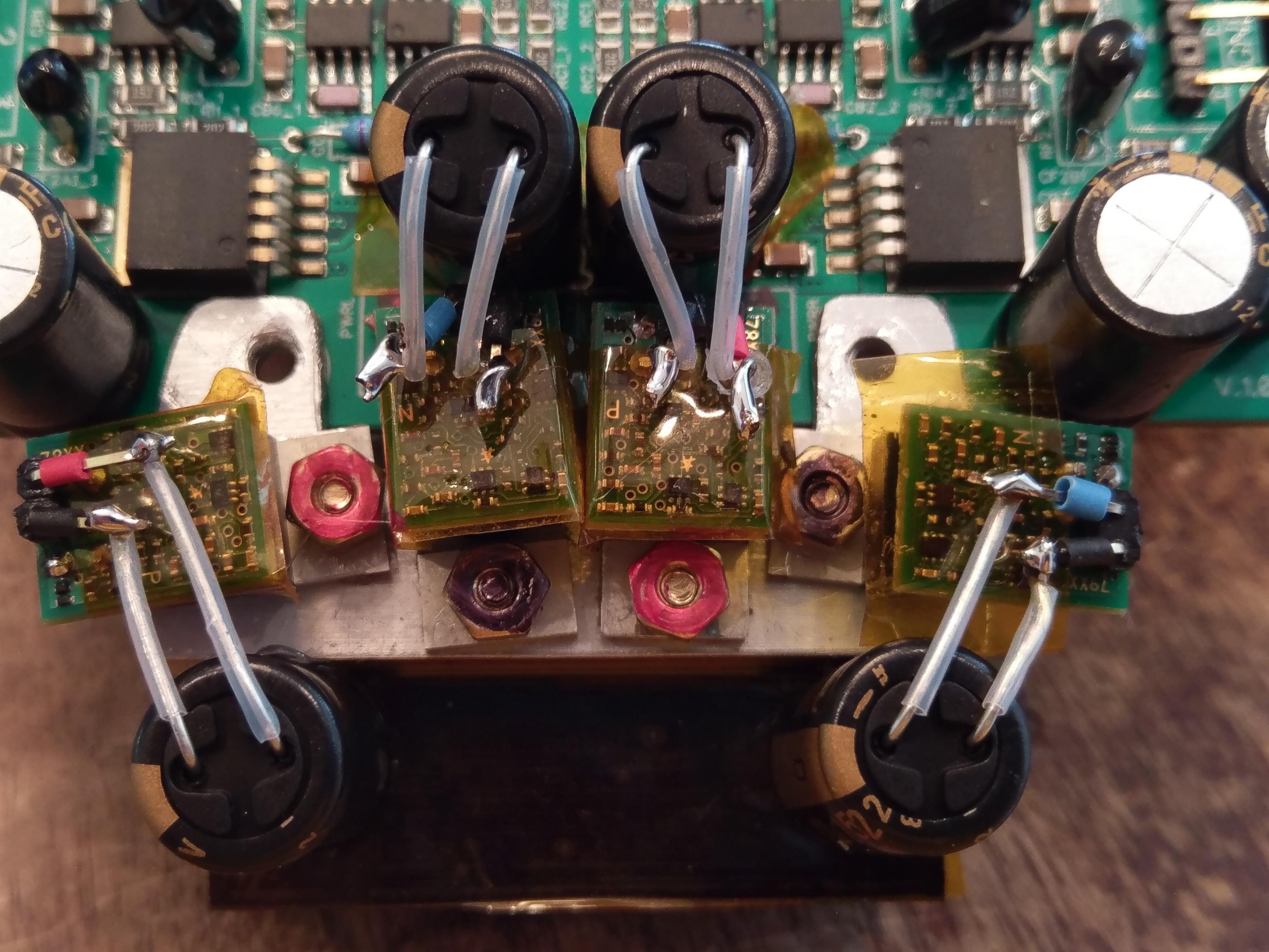

P.S. Another picture, showing the Sparkos Lab regulators on the Mercury. I've always liked very short paths from my final regulation stages to the powered stages... this is as close as I can get them without some hackery, of course, which I'm not above, but didn't want to descend there for the first implementation.
Greg in MIssissippi
Greg in MIssissippi

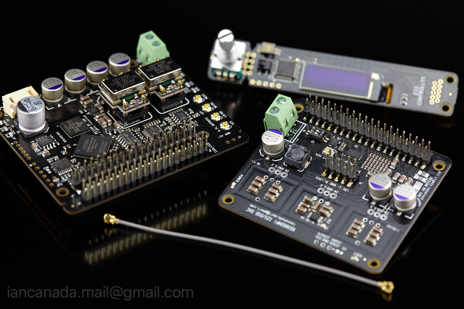

FifoPi, the next generation all in one I2S/DSD/DoP FIFO for Raspberry Pi
To achieve higher performance and better sound quality, I finally decided to design my own FIFO for raspberry Pi based on my third generation FIFO technology.
I'd like FifoPi to have the following features and specifications:
1. Up to 768KHz full range I2S support;
2. DSD64,128,256,512,1024;
3. built-in 768KHz DoP decoder to enable RaspberryPi native DSD play back up to DSD256;
4. Isolator board will be included;
5. Clock board (isolated) will also be integrated, works with interchangeable XOs through standard sockets or adapters;
6. Supports full rang of XO frequencies from 11.2894 to 98.3040MHz;
7. Has two DC inputs for both isolated clean power and RaspberryPi power;
8. Has an additional non-isolated GPIO connector to make DAC controller working in isolated mode;
9. Works with good 5V linear power through on-board low noise LDO or pure direct 3.3V power from ulatr-capacitor or LifePO4 battery power supply;
10 Works with all RPi DAC HAT and external high-end DAC at synchronized master clock mode to remove jitter;
11. Optional external display panel with adjustable delay time;
12. DIY friendly with options and flexibility.

FifoPi and ES9038Q2M DAC HAT
FifoPi makes ES9038Q2M DAC HAT working at pure sync clock mode. The MCLK u.fl cable is the only cable that needs to be connected for sound quality. Anything else will be plug and play.
ESS controller can be connected to the non-isolated GPIO of the FifoPi. I'm highly rerecorded doing it this way. With the FifoPi on-board isolator, ESS controller will be 100% isolated from ES9038Q2M DAC in this case. The processor of the controller will never have any galvanic impact to the DAC.
FifoPi_3 by Ian, on Flickr
Ian
