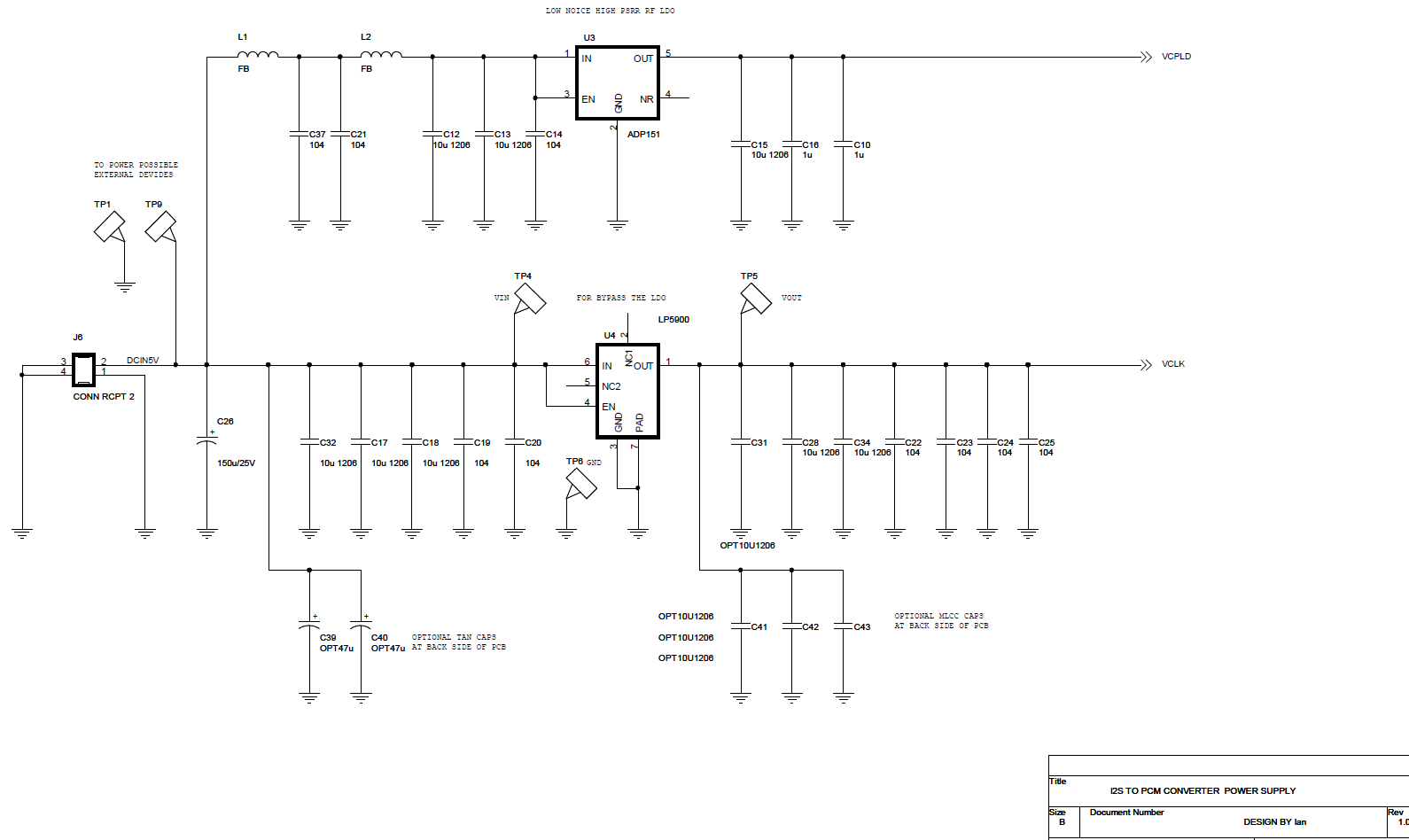

Ok, I understand I can do this way, but I would know what parts I have to remove (LDOs and other components on the power path).
I would get pure battery powered way.
Please, let me know.
Andrea
Only Need to remove the three LDO boards on the McDualXO and the LDO chip on th PCM board.
Please refer to corresponding user's manual for details.
Ian

Hi Andrea,
There was some recent discussion about bypassing the ldo on the I2S to PCM converter. It is covered in the documentation on point 9, but effectively jump 3.3v in to 3.3v out and connect the battery to the J6 5v in connector. It will short bypass the ldo. I doubt that removing the ldo will make an appreciable difference.

For PCM board, you only need to remove U4 and then short TP4 and TP5. Please figure it out from the attached schematics.
For Dual XO II, nothing needs to be removed. You just need to short the IN(TP3) and OUT(TP5) pin of the external LDO connector.

I'll try my best to support, though modifying circuit could be out of range of a user's manual :).
