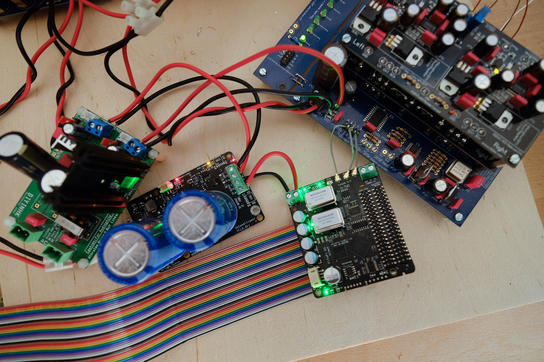

coming from the DDDAC thread, I need some help please regarding FIFO Pi Q3.
I have it in my system for quite some time now. I'm very pleased soundwise when a track is running, no pop / clicks, very clean and detailed sound, great soundstage.
But there is one issue I'm struggling with: When I start playing a new track or jumping to a new position within the same song, there is often one short (loud) click / pop. After that the track plays without issues with great sound. The click volume differs, sometimes it is quiet I can almost not hear it, but most of the times it is really loud and I'm afraid that my speaker get broken!?! Also the 'position' of the click moves: Most of the time on the left side, sometimes the click moves to the middle and right side of the soundstage. Really strange.
I have done some tests but to summarize:
RPI I2S -> FIFO PI Q3 -> DDDAC: Clicks and Pops at track start
RPI I2S -> DDDAC: no issues
I'm running volumio, but I have also tested with moode. Same issue.
If have done some tests with different settings without success:
I've set the I2S DAC Model to HifiBerry and test wise to Generic I2S.
I have switched on audio respampling to force 24 Bit output. And I've disabled resampling and used the fifo pi 32 bit transformation.
If have exchaned the Accusilicon clocks against the default clocks for one test.
Because I thouht this comes from EMI issues I have ordered a GPIO extension cable to get some space between RPI and FIFO PI. But also not luck with this.
In the DDDAC thread there are a few other people with the same effect, but they have not done tests to isolate the fifo pi as the cause of the issue, so maybe I'm still the only person with this issue!? Just doing something wrong, or my copy is broken!?
Do you have an idea? Someone with the same issues? I would really love to keep the FIFO PI in the system because sound is great when track is running, but the clicks in the beginning are driving me crazy...

@Ad: I have a Q3 model.
I asked my dealer for exchange and got now a reponse. He offers me to check the fifo pi in his workshop. He will charge me 30€ if the device is not defective. This means for me in worst case, that my fifo pi will be away for some weeks plus the risk with shipping to another country and at the end I need to pay for it because my dealer tells me everything is fine in his workshop. Great 🙁
Actually I'm not sure if should send it back. Means, if my fifo pi is really defective or if it is a design issue of the fifi pi or some kind of incompatibility with DDDAC setup. I guess not, because there is not much negative feedback in this thread. But there are some people with similar issue who learned to live with it and maybe there are more out there I do not know!?
I would appreciate any advice? 😕

Different from other DACs, DDDAC has it's own logic to convert standard I2S format into left justified NOS mono block timings. Some times multiple DDDACs can be in parallel configuration to increase the output current and lower the noise floor.
Can you please post pictures of your system and configuration to see if I can figure out what's the issue?

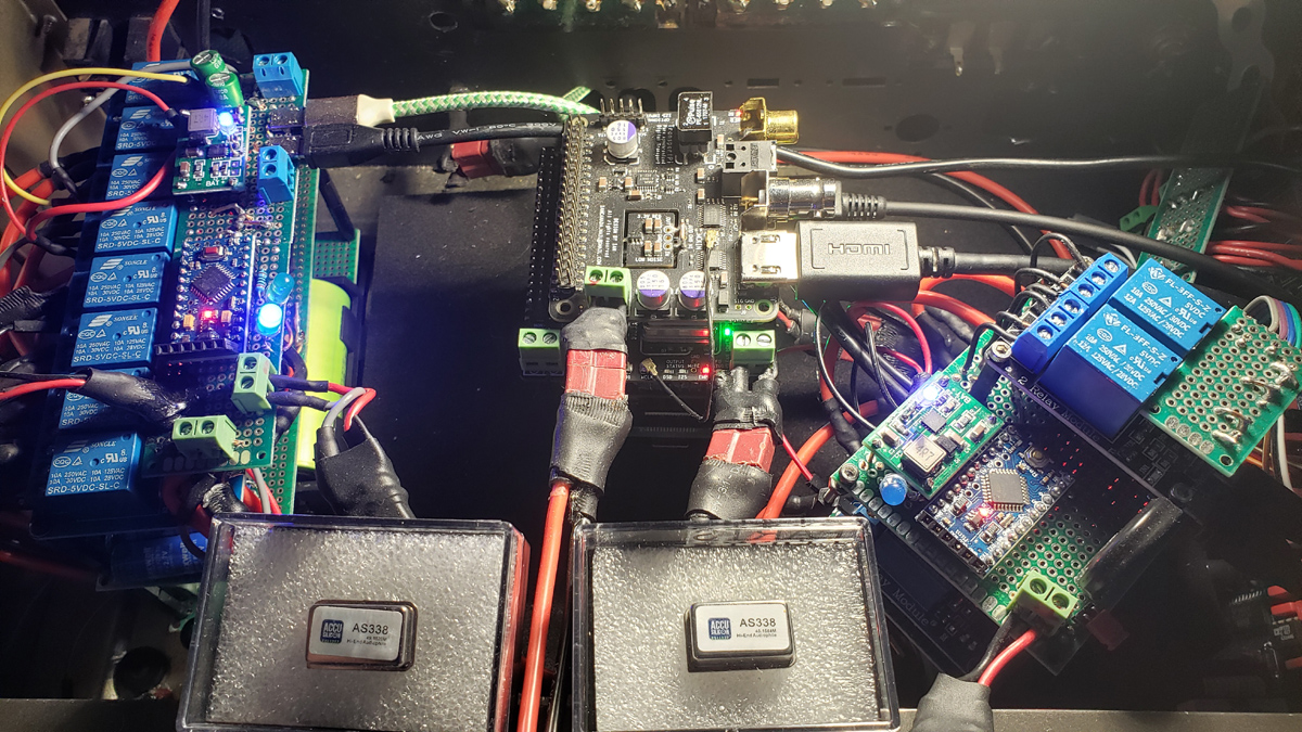

2x AS338 received
Just received the 2 AS338 clocks from the Taobao Focus order
I'm installing in the LifePo4 + Ultracaps powered FifoPi .... hopefully I'll notice a positive difference from the AS318b and NDK clocks they are replacing.
Please forgive the rats-nest wiring- this unit is a work in progress.
Listening reports coming soon. It would be cool if the FifoPi allowed manually switching between 2 clocks from the same family for better A-B testing... just a thought.

Does Ian's FifoPi keep both clocks powered in this manner? Or, if not, can it be modified to do so?
You can keep the DC power to the FifoPi clean side always on without shut down, so both of XOs will be powered continuously.
FifoPi Q3 also supports both XOs running at same time. In my system, I use two Pulsar OCXOs. They don't have any OE control. So both of them keep outputting even at time that is not selected as current MCLK. You can see my YouTube video for more information.

For XOs with the OE control, you can still keep them outputting all the time by disconnecting the OE pin from the XO sockets (they have internal pull-up).

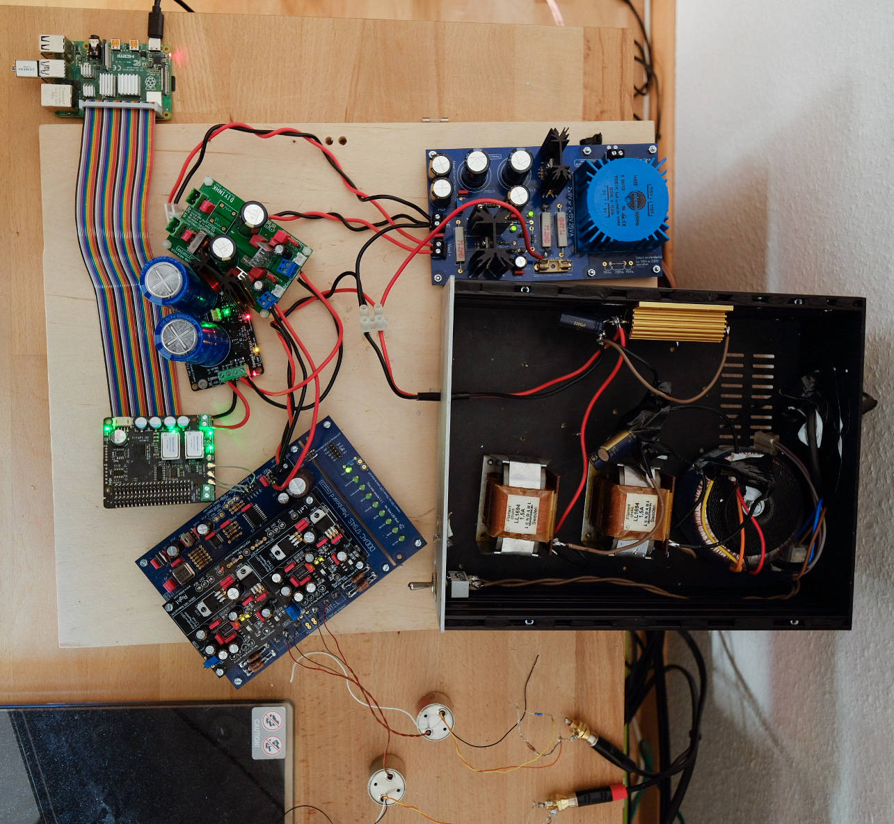

Thank you very much Ian for taking care of this case 🙂
Here are two pictures of my system. Please excuse the messy setup. My plan is to put the whole thing into a case once I'm finished / satified with it (That can't be long because the click thing is my only left issue).
If I can give more information or pictures please let me know.
Thank you in advance!!
