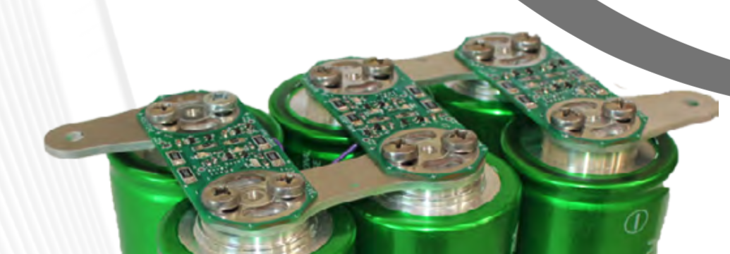

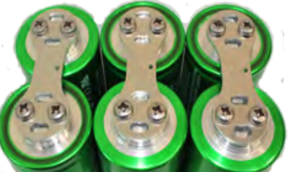

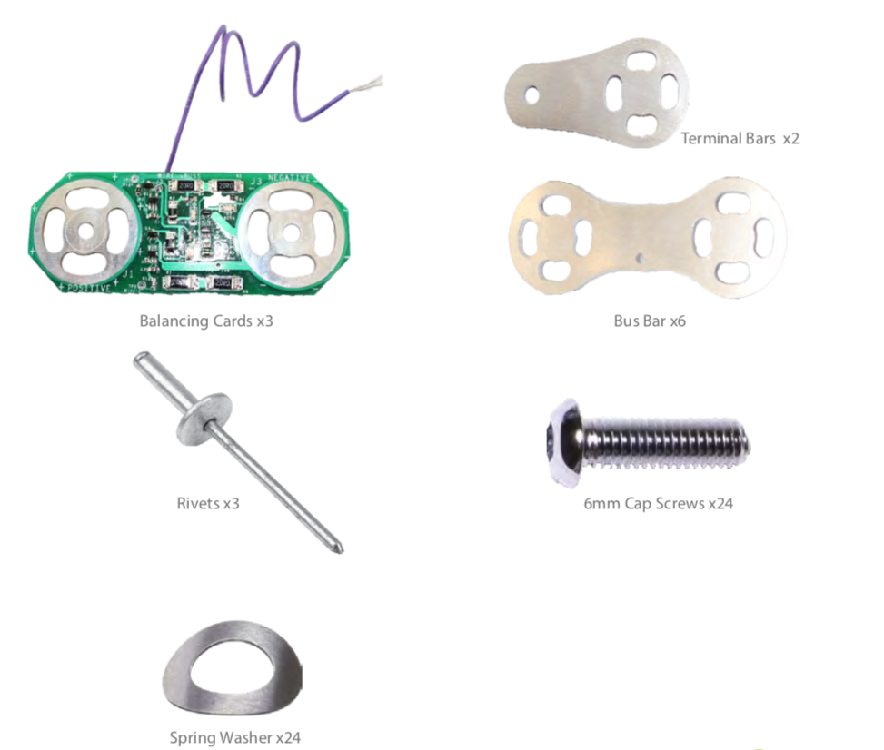

Hi Ian,
Does Termination Style matter for the UcPure? Or do you basically need just a positive and negative termination bar along with a third-party balancing board?

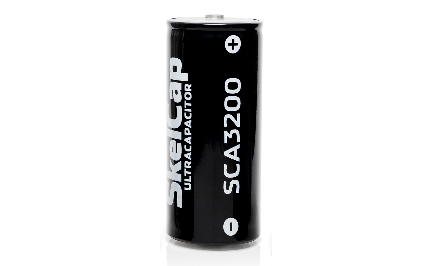

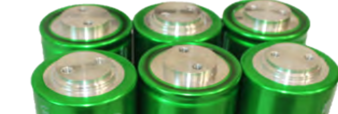

The traditional method is based on Maxwell threaded UC, but there are other 3000 F+ UC with different termination styles. Unfortunately, the available Skeleton Technologies 3200 F is of cylindrical termination style. I don't know if there are balancing boards for 'cylindrical'. Can you weld a 'screw' type to a 'cylindrical' type thus making it a 'screw' type for a third-party balancing board?
The attached photos are from a complete balancing kit but they use the 'screw' termination style not 'threaded'.
Hi Ian,
Thanks Ian. It helps plenty to open more doors.
Since all this is foreign territory, I can consider a kit to simplify if it makes sense. It's just the kit is older tech, but still 3000 F so need to balance simplicity versus latest and greatest.
That would be great after the dust settles on the Group Buy to demo the balancing board off Amazon. As of now I don't know where else to source.
The kit from Mouser is for a future 15V build in a year. Just keeping options open like if I split the 3 balancing boards from the kit, I can use now for 5V.
I'm just going to start off slow with 5V, so need a simple balancing board + a couple of Tecates / Eaton. But I prefer a brand name balancing board if available like the kit.

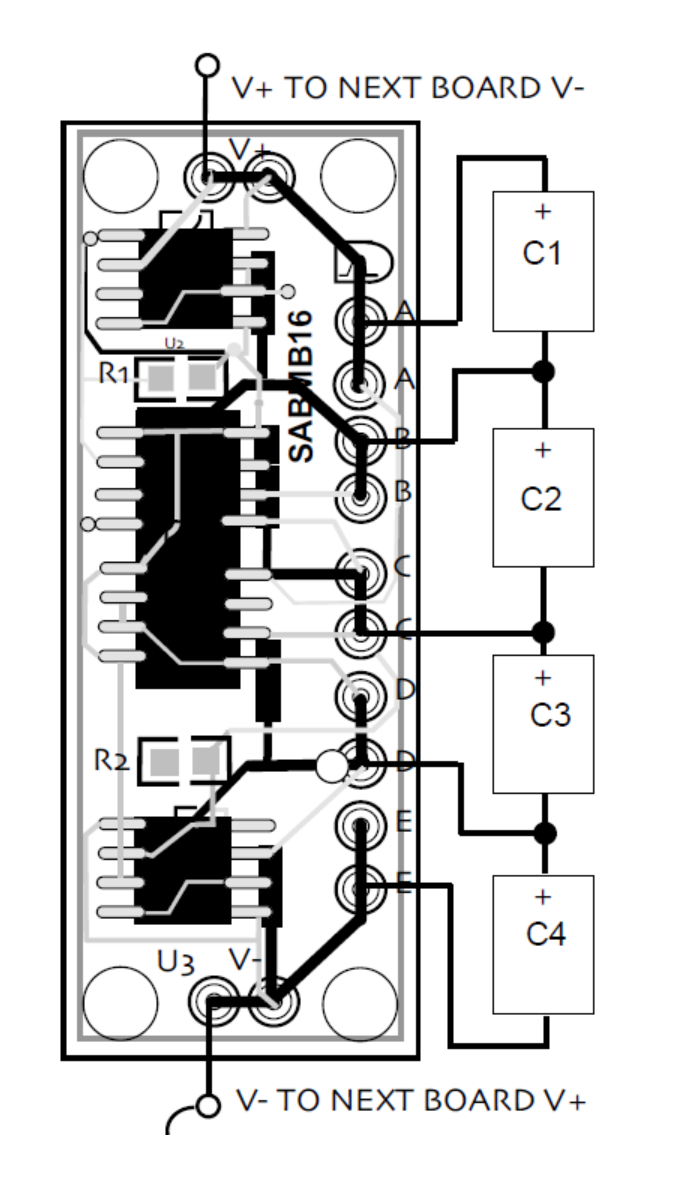

I will feel more comfortable if we can use a brand name balancing board like this:
https://www.aldinc.com/pdf/NewPlug&PlaySolutionforBalancingSupercapacitor.pdf
ALD Precision Analog Standard Products
But as a last resort would use the one on Amazon if no other options.

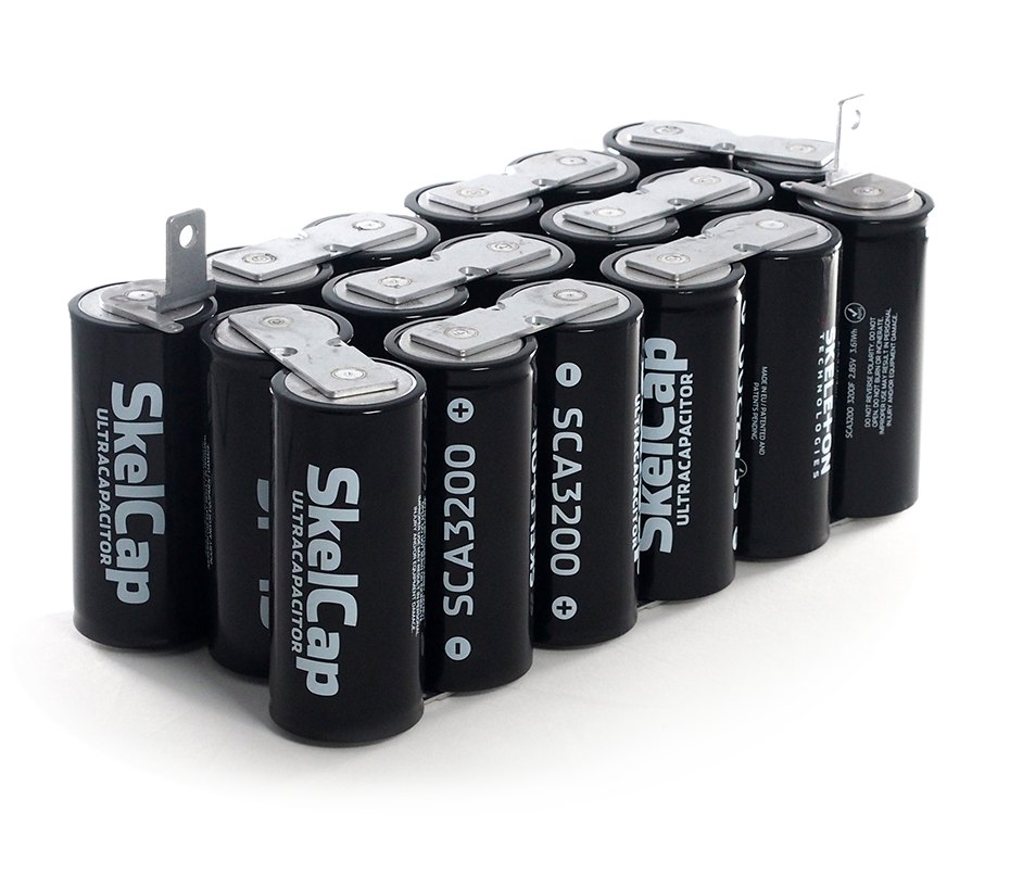

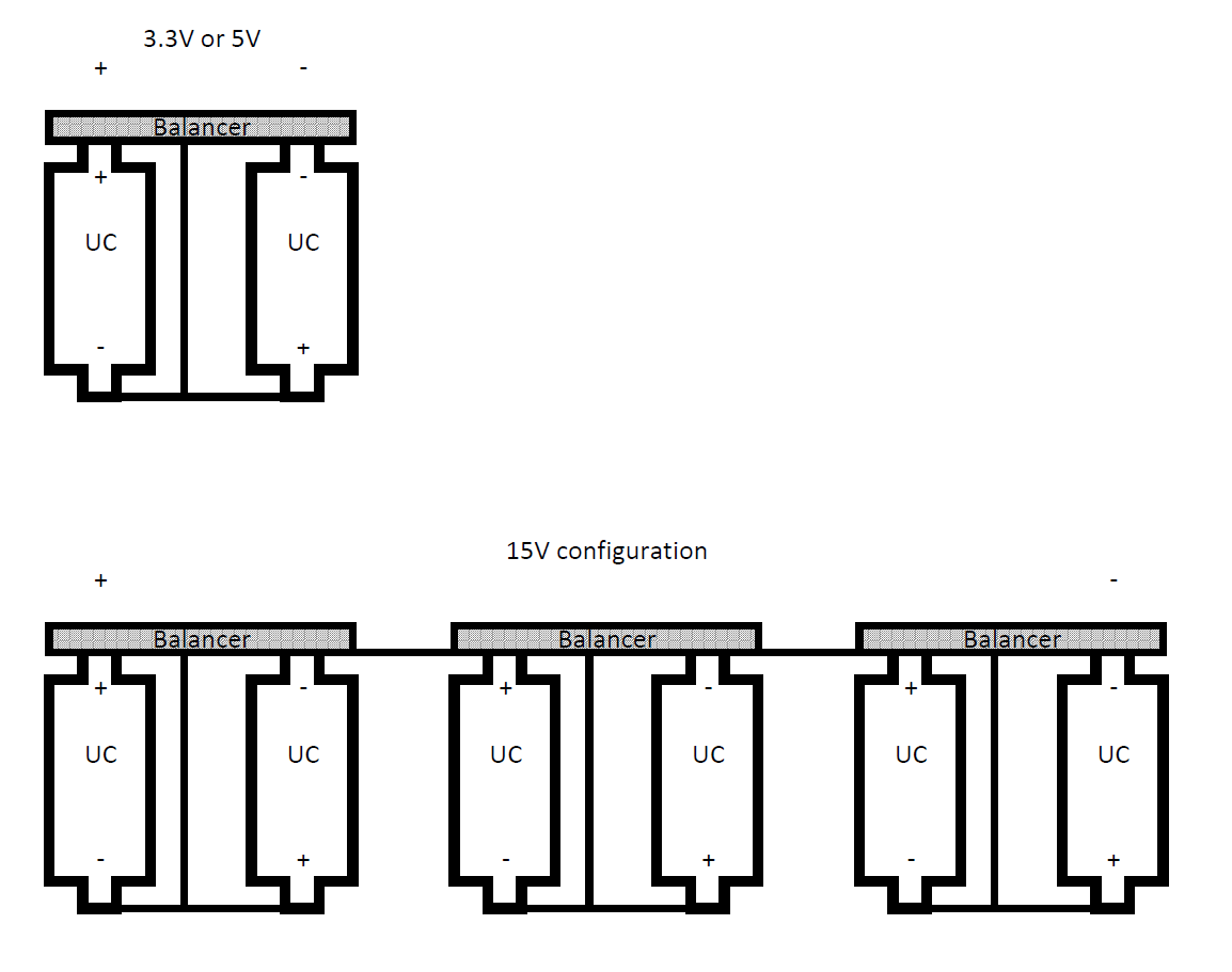

If there is a way to use the above balancing board with the UcPure, then maybe there's a chance we can use Alligator clips to clip on the Skeleton Technologies SCA3200 (arriving at Mouser soon) since Termination Style is irrelevant? Or solder wire onto bar / tip?...

Balancer/Protection board for 3.3V/5V and 15V configurations
Balancer/Protection board for 3.3V/5V and 15V configurations for ultracapacitors
Please let me know if there is anything wrong.
Ian
