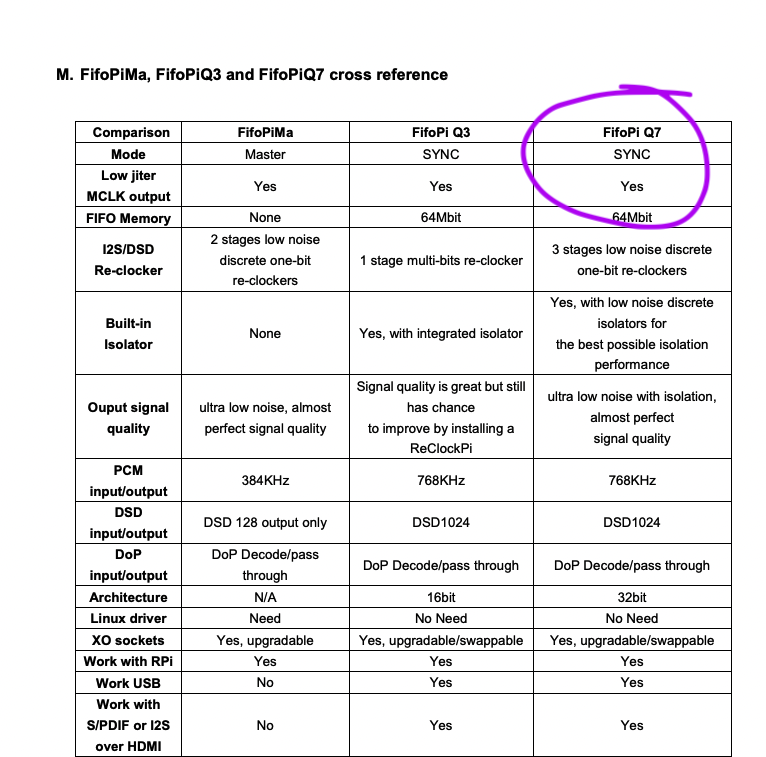

If I had to guess, the FIFO Q7 is going to be an end game solution for R2R-DACs, but I’ll wait for the documentation…
Iggy, why the ‘tude, dude? You might allow that there is more to digital audio than caps and resistors, and if you read the docs you will certainly find a level of excellence in concept and execution that finds no analogy in car trim or sartorial excess…

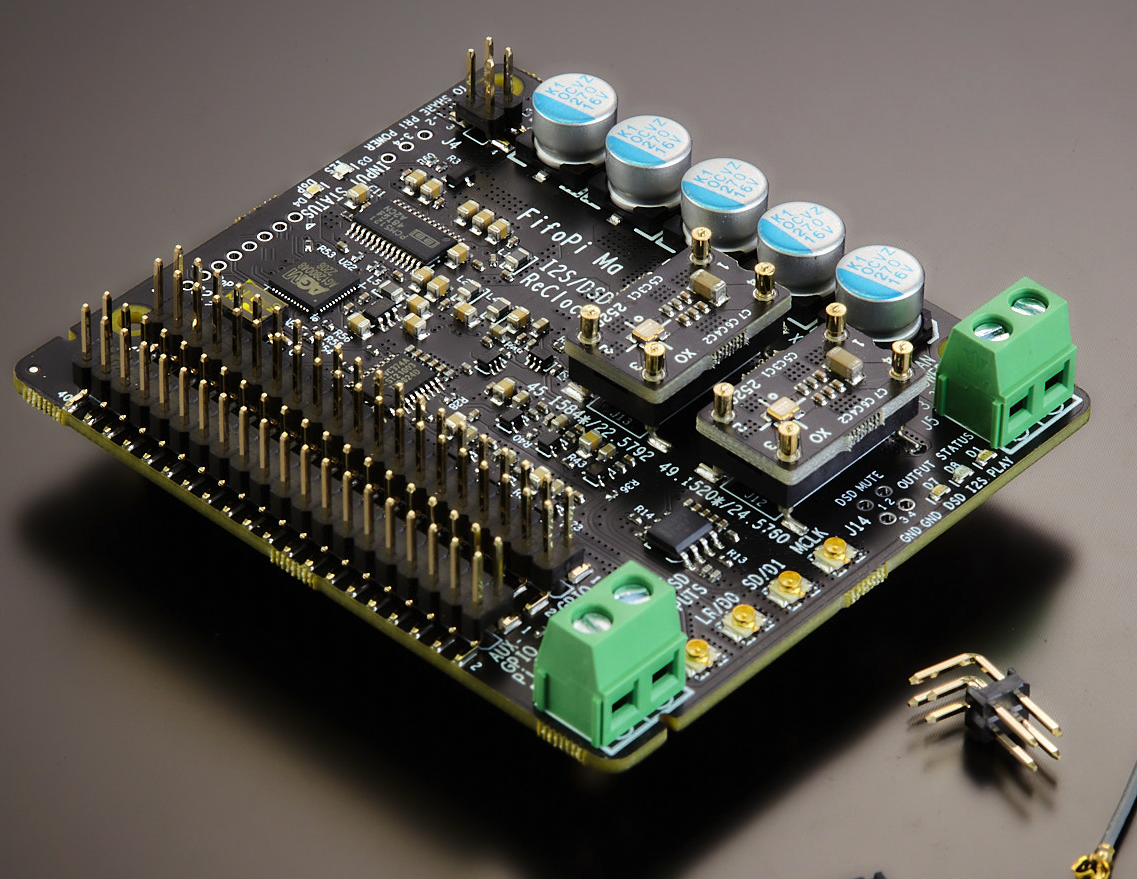

Dose FIFOMa work well with r2r DAC?If I had to guess, the FIFO Q7 is going to be an end game solution for R2R-DACs, but I’ll wait for the documentation…

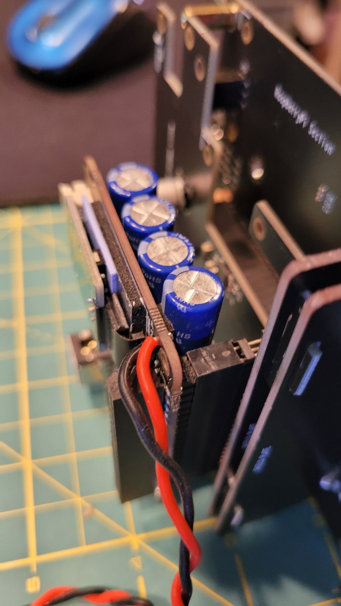

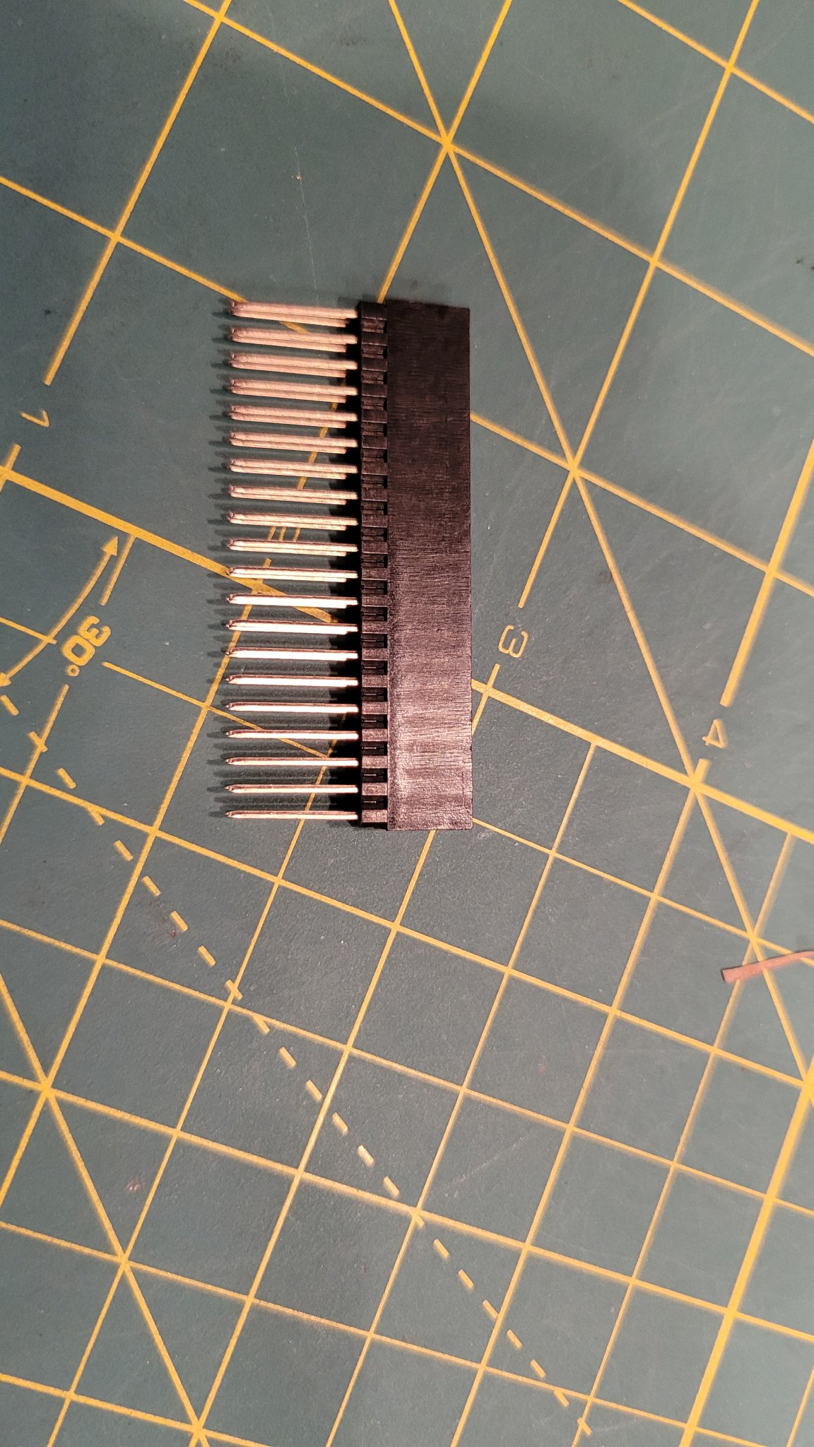

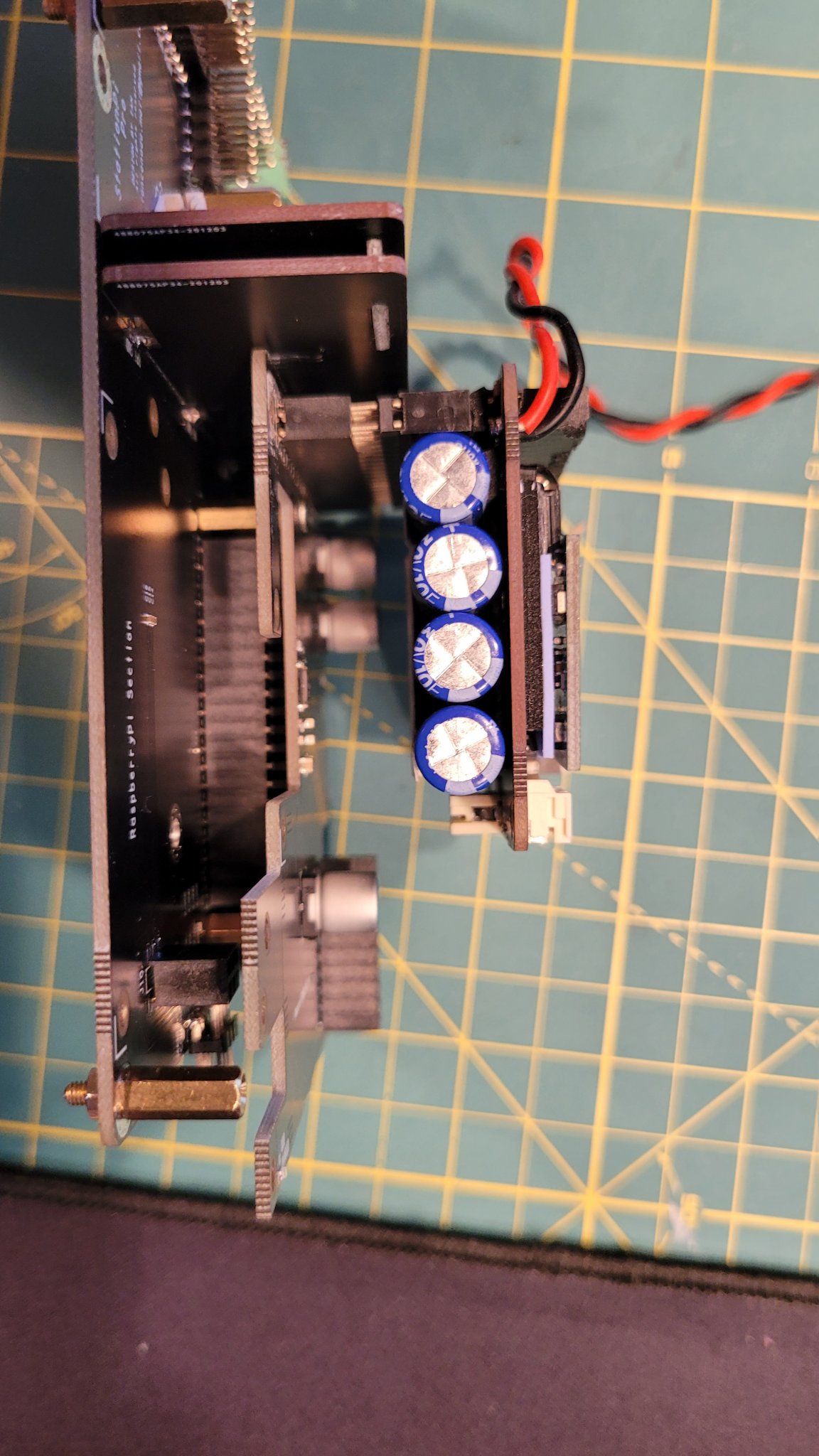

@Ian Just starting to retrofit my DAC Stack V2 with the new StationPi Pro (SPP) PCB. My previous build had the ConditionerPi face down under the RPi - and worked very well. With your new design and the daughter PCB attached, there is no physical way to install the ConditionerPi to the daughter PCB due to the 3 capacitors. It seems it might be possible to mount the ConPi by using a DIP extender/riser (below) to give more clearance for the ConPi.? If I were to pursue this approach would the ConPi still work as expected with the RPi, or is there new circuitry integrated into the SPP, or daughter board that would interfere? Or, is the ConPi still needed with the new SPP PCB at all? I know some things must be given up with a new design, so if it won't work that's an acceptable answer too.
Edit: What is the J10 header used for?
Of course there are other issues/constraints to deal with that arrangement too. The standoff holes aren't aligned and it makes that part of the SPP much taller and may not fit in my original case(will not fit once the RPi is attached ). I can shorten the extender to fit closer as well. The additional support needed I can deal with.

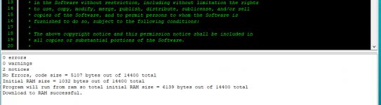

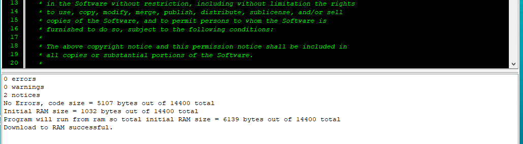

I'm following your notes on setting up the 4D System screen using your code. I can get it to work fine on the development controller by by using the compile and download commands. However, whenever I disconnect the display and hook it to the StationPi Pro connector it reverts back to the 4D splash screen and not your large display buttons. Is your code 'flashed' to the screen or is in volatile memory? Is there a step I'm missing?

The Comp'nDownload appears to work ok, and I get no error messages (see below). I've tried a couple times now and the display never changes when hooked to the SPP. Is there a jumper I'm overlooking, or 'saving' of the your 4D code once it's downloaded to the display?

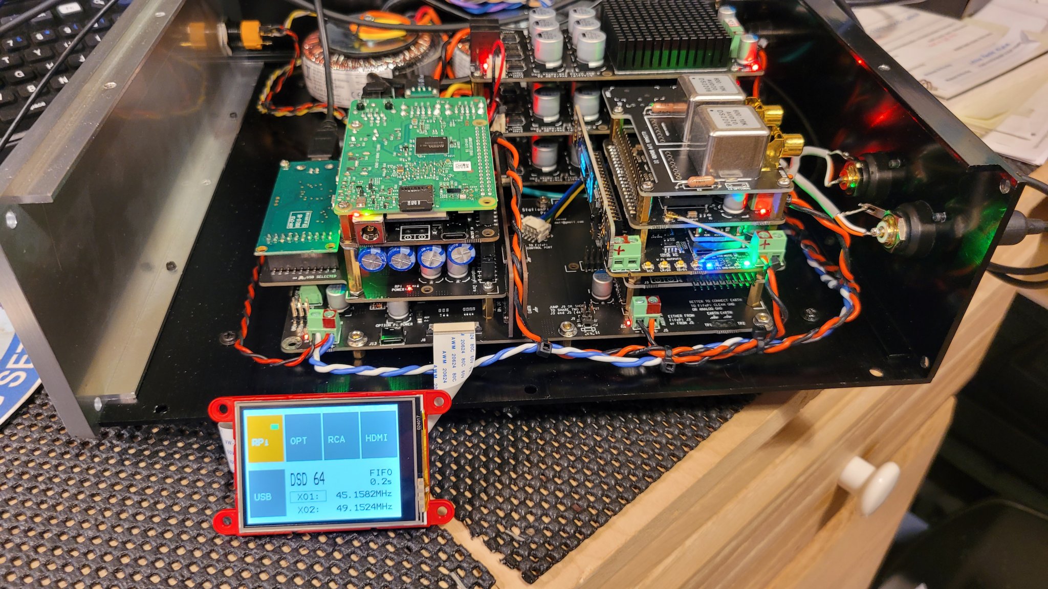

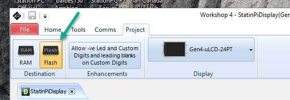

I guess I'm having a conversation with myself! Anyway, it's funny how one small detail makes all the difference in something working or not. On the Project tab of the 4D IDE the destination must be set to Flash not RAM. I knew there must be someplace to perform the flash. Once I found it and changed it from the default of RAM, everything made sense and it worked. Touch screen works and I've got it displaying controller information too. Here's an image of my rebuilt-stack. I still need to bring a USB jack out to the back panel. Then I'll have all the inputs I use available. Of course, I have to mount the screen on the front panel as well and put the finishing touches on everything.
