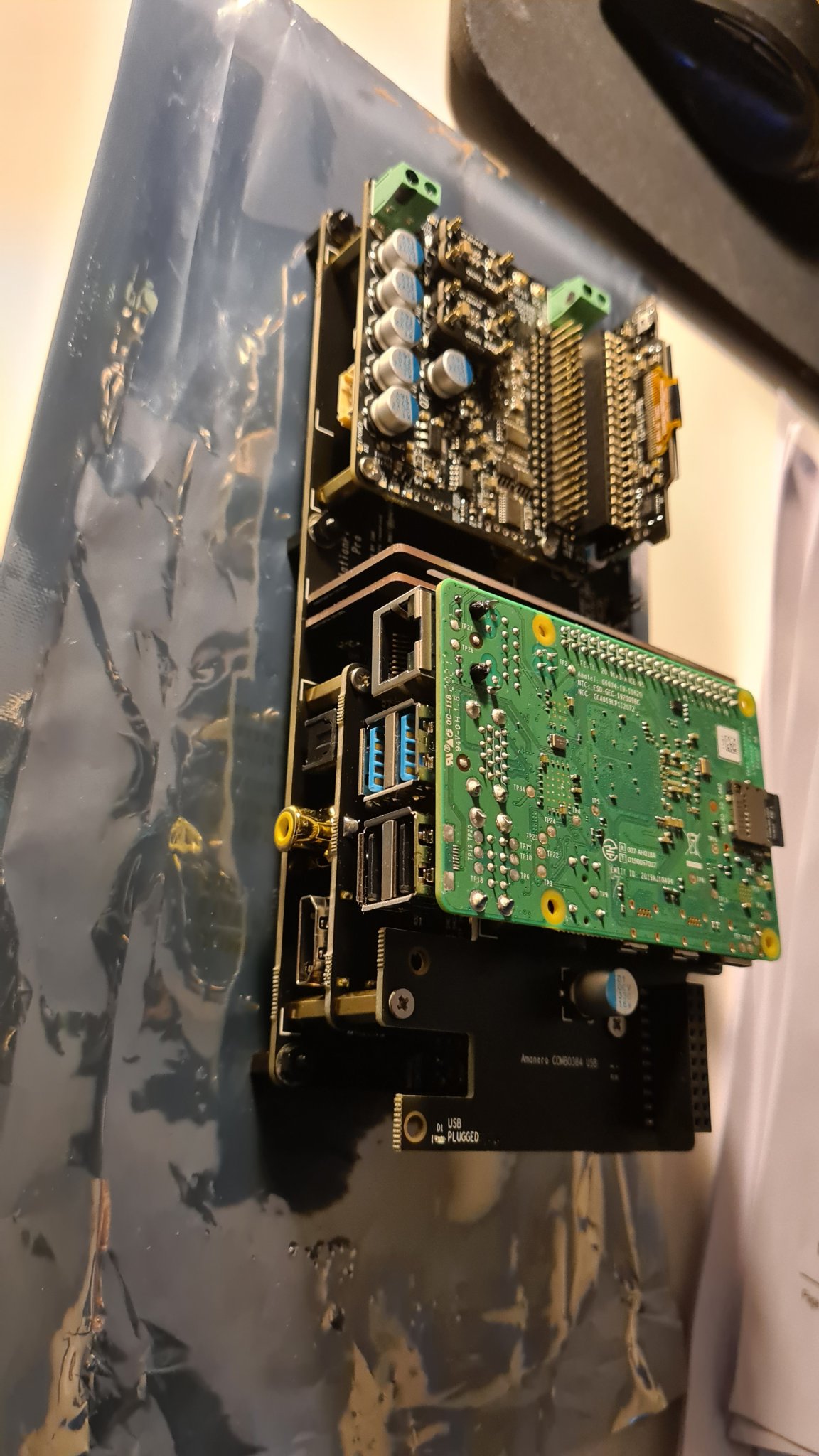

I'm trying to run Q7 with Roopie and a DDDAC. What I'm getting is soft music against a background of static. So nearly there
But one thing that may be causing this is-what DAC setting do I use in Roopie as DDDAC isn't an option?
Look forward to some suggestions!
David

Have you tried the raspberry i2s? This is what I’ve used before with ryanj tda1541 dac and it worked fine.
Thanks. All up and running now. In the bad light of Friday eve I'd connected the ground wire to the non isolated GPIO and of course it should have been connected to the isolated side! I am using the Raspberry i2sHi,

Hi Ian!
Just purchased a FIFOPI Q7 + TransportPi Mk2 at audiophonics.
Using 3 LinearPi's for Raspberry Pi 4 (5V), FiFOPi Q7 (3,3V), TransportPi Mk2 (3,3V- removed L1).
Unfortunately the Accusilicon-clocks I also purchased (45-49; 90-98) don't work. With the default Set of clocks it works (Driver for Volumio- generic).
There is another big problem that stopped me using the hats:
I also just purchased an RME ADI2 DAC FS, which is fantastic. But it's internal DC-protection immediately closes outputs
detecting high amounts of DC coming from the boards (even via toslink!) It happens, when I stop a track - this amount
of DC might be able to destroy headphones or speakers. The DC from the signal remains till the next track is chosen-
then outputs on the RME get opened again. With any other DIGI-HATS I have there are no problems at all.
With FIFOPIQ3 and original Transportpi it's the same- also large amounts of DC with the RME DAC when track stopped.
But with FIFOPIQ3 and Transport the Accusilicon clocks work.
Have just followed all instructions in the manuals.
Is there any solution?
A lot of thanks in advanced!
Greetingz, Robert

Here is the solution, it's very easy to fix, Please read the troubleshooting sections in the users manual
https://github.com/iancanada/DocumentDownload/blob/master/FifoPi/FifoPiQ7/FifoPiQ7Manual.pdf
Thanks Ian!
Then only the very serious question of the DC-problem- transmitted within the digital signal at stopping tracks is unsolved.
This amount of DC occures when stopping a track and stays till next track is played. I never had this with any DigiHat- I first recognized this phenomenon with the ADI2 dac's DC Protection.
Do you have an explanation for this behaviour? I'm really afraid to damage expensive headphones or speakers.
Is there any fix without the MonitorPi option?
Greetingz, Robert

Hi Robert,
It seems that your DAC outputs a DC offset if the S/PDIF clock is stopped. But FifoPi Q7 has a solution for you if that's the case.
You and just enable the new continuous clock function, I believe the problem will be fixed.
To enable the continuous clock function setting, you will need a MonitorPi. But if you want, you can remove it after the setup.
Ian
