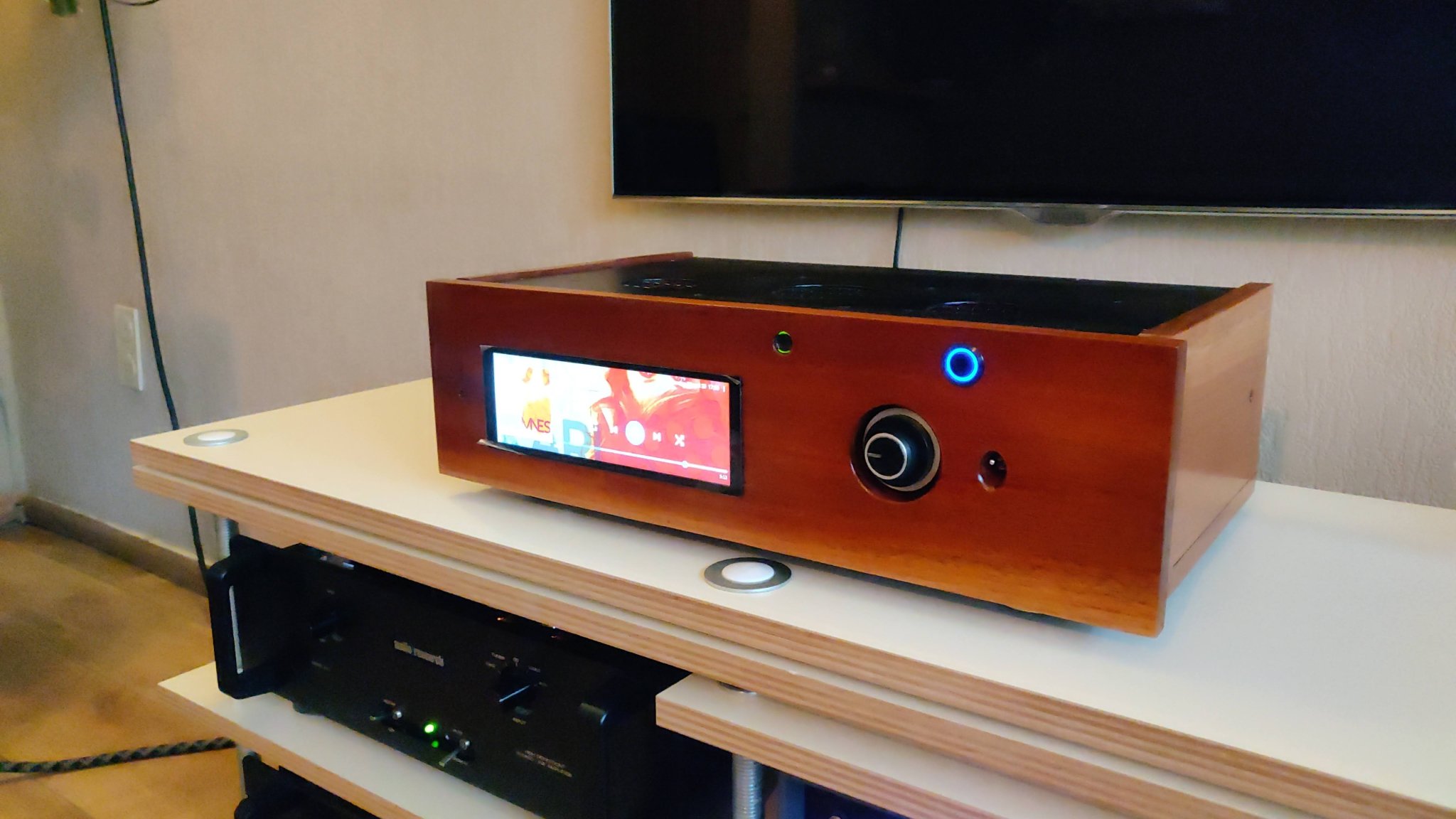

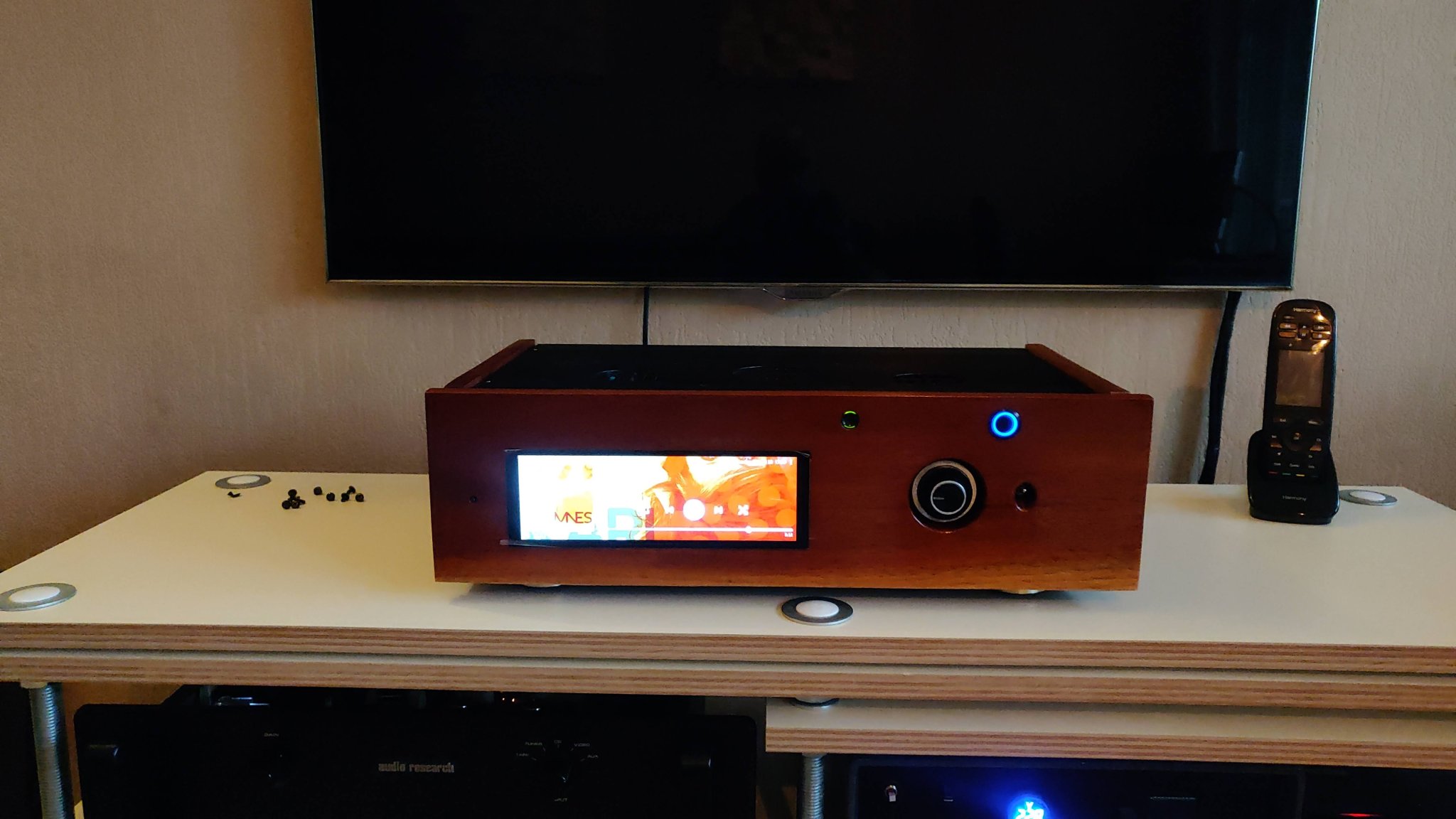

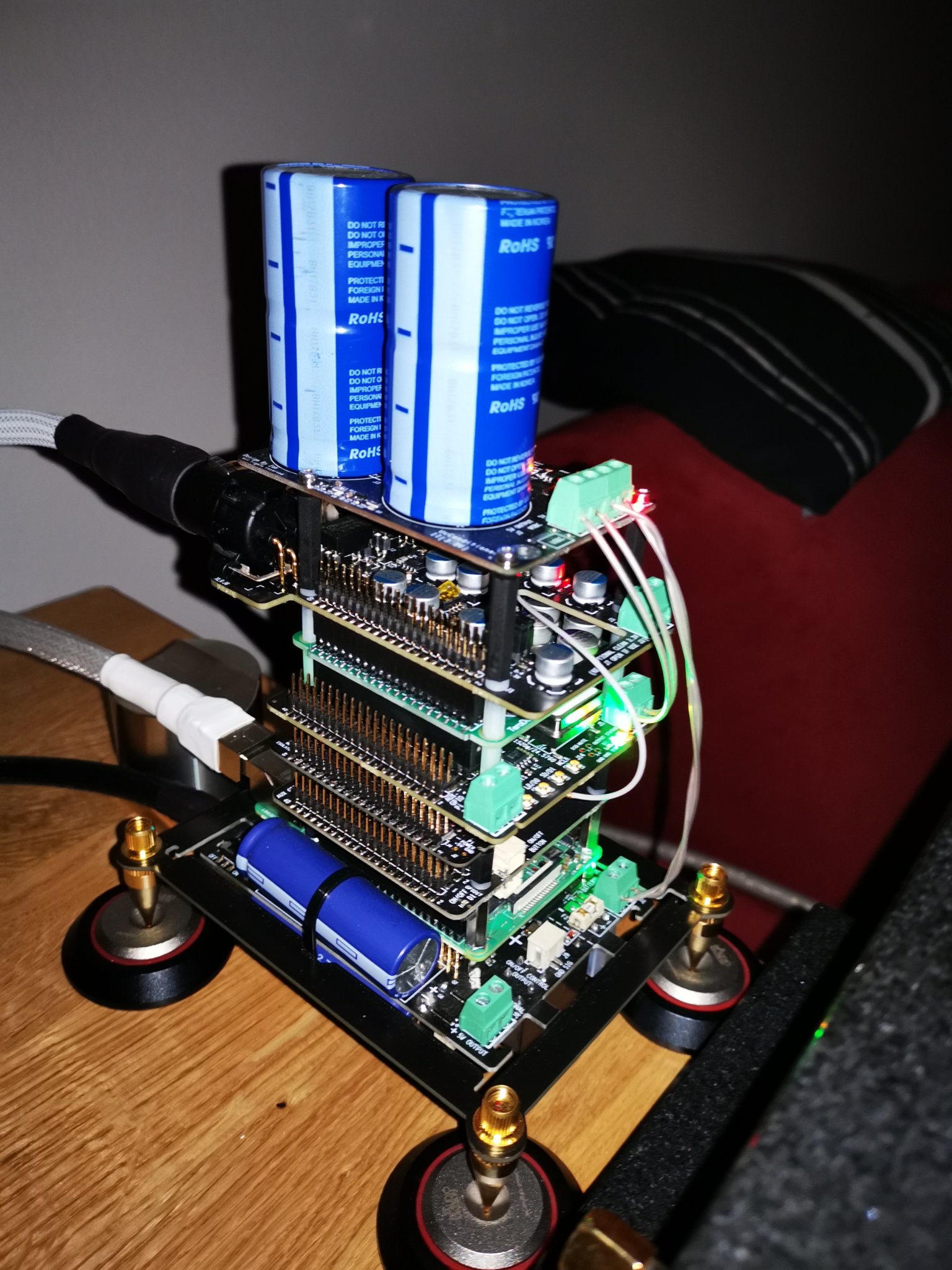

@zangalucianHi all! I’ve finally received the last parts for my Ian Canada streamer-dac build. Last for now, who knows what I’ll do in the future 😁
List of parts: RPI 4B, Station Pi Pro, FifoPi Q7 with Accusilicon AS318B 45MHz and 49 MHz, 9038Q2MPi dual mono Dac and the Ed’s controller, OPA861 I/V, LinearPis and UcConditioner with Maxwell caps (5pieces) and 3 audio grade trafos from MPAudio 2x6VAC/60VA each.
One power supply for the station + rpi, one for the FIFO, one for the dac and two in series for the opa.
Currently running on RCA as I am limited to that due to the amplifier (Wadia Intuition). I’ve just set the dac in true sync and I can just say it sounds amazing. Very detailed but at the same time very relaxed and natural, no harshness unless the recording is harsh. Can’t wait for daylight so I can listen more and louder.
Thanks all that have helped and thank you @iancanada for the great products and the help!
Attaching some pics of the current state of the build. The “case” will be changed to a “cleaner one”, better cuts and more permanent holes.
LE: added a pic with the full system. Speakers are a pair of DIY enhanced “clones” of Monitor Audio Pl200mk2 with an additional mid range on top (not my work).
