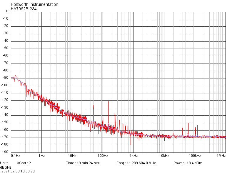

So when you test clocks, usually by connecting a cable(wire) to an instrument all readings will be wrong?You should understand a very basic concept: the longer the transmission path, the greater the probability and degree of electromagnetic wave interference, even if the transmission wire is well done, so the clock signal passing through the signal wire will naturally be subject to additional electromagnetic wave interference , the jitter brought by the wire, need to feel very surprised?
And a review of a wired clock

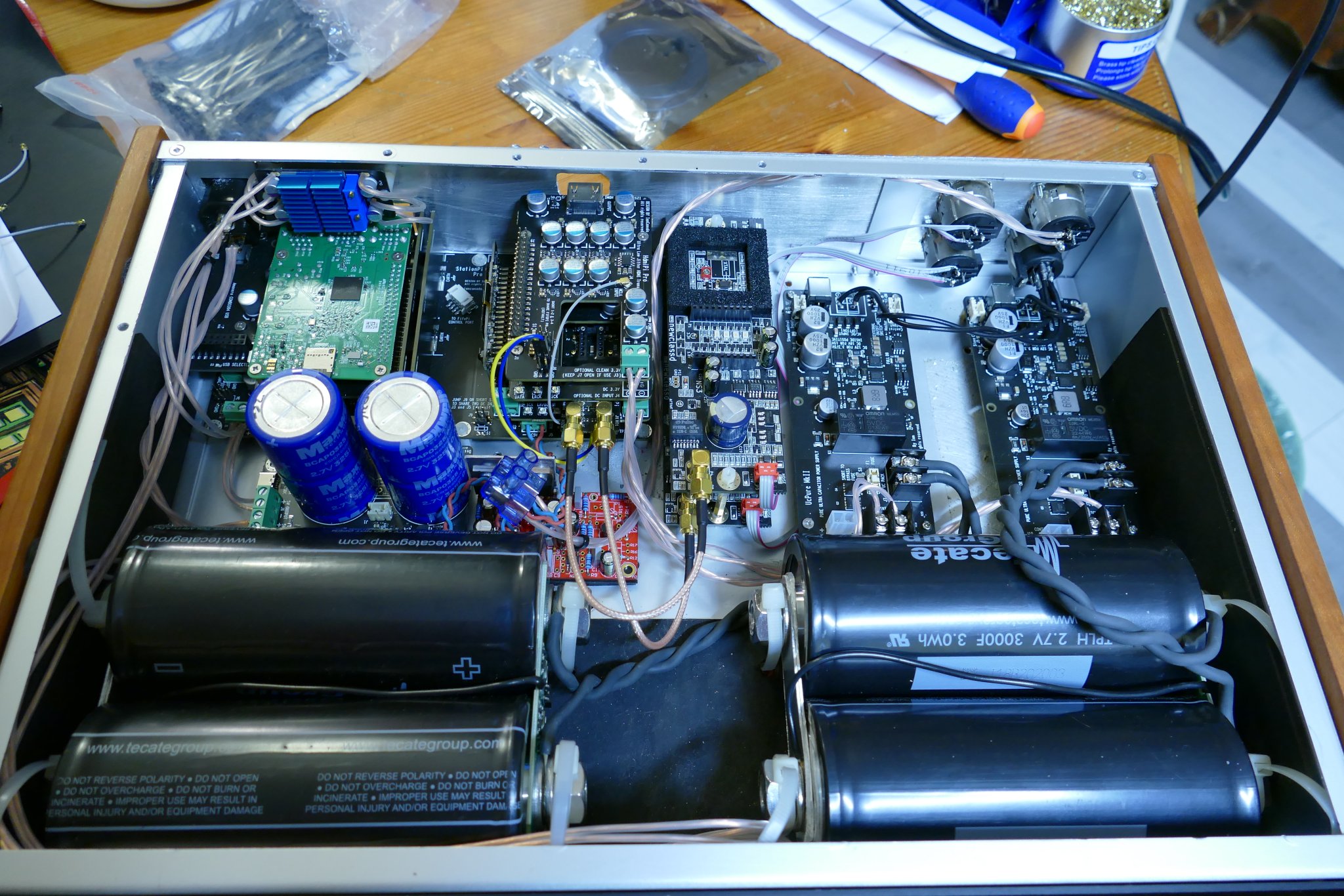

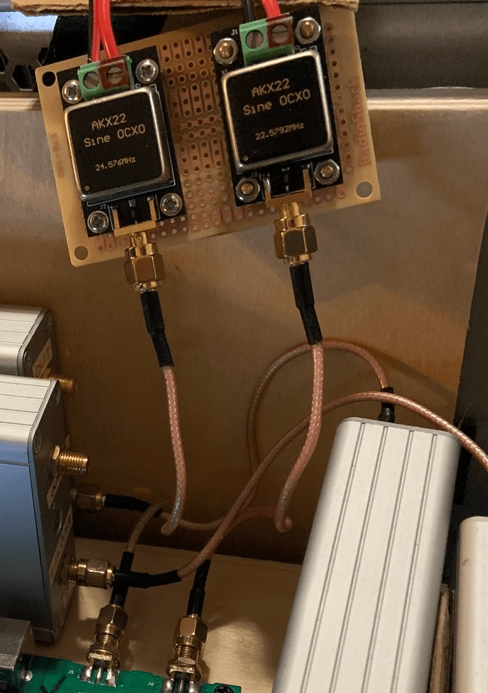

Of course shorter is better,I trye to have as short as possible.Take a look my picture,have 4 inch to sinepi from clocks.You should understand a very basic concept: the longer the transmission path, the greater the probability and degree of electromagnetic wave interference, even if the transmission wire is well done, so the clock signal passing through the signal wire will naturally be subject to additional electromagnetic wave interference , the jitter brought by the wire, need to feel very surprised?

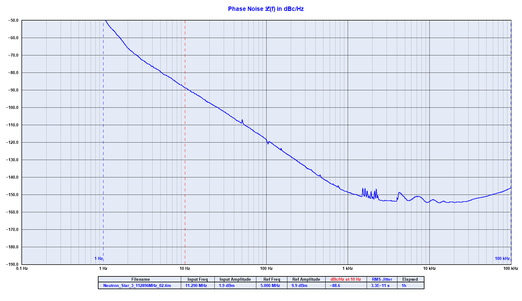

Don't know about Neutron Star 45Mhz. However, just received a phase noise plot for a Neutron Star 3, 11.xxx Mhz version:...have a Neutron Star2 45.xxxMHz...
For about 1$ similar performance at 50MHz.It s not terrible for à fréquency of 11Mhz.
https://www.mouser.fi/datasheet/2/122/ECS_2520MVLC-1903379.pdf
