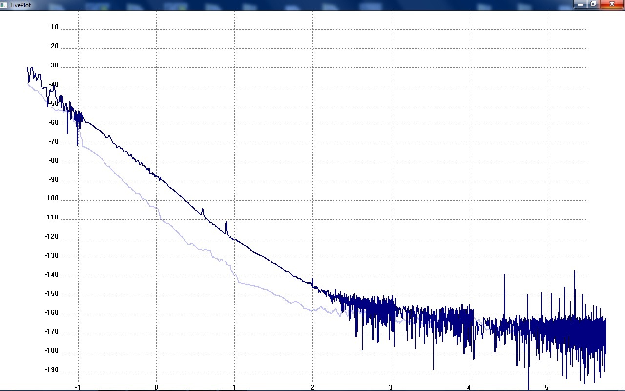

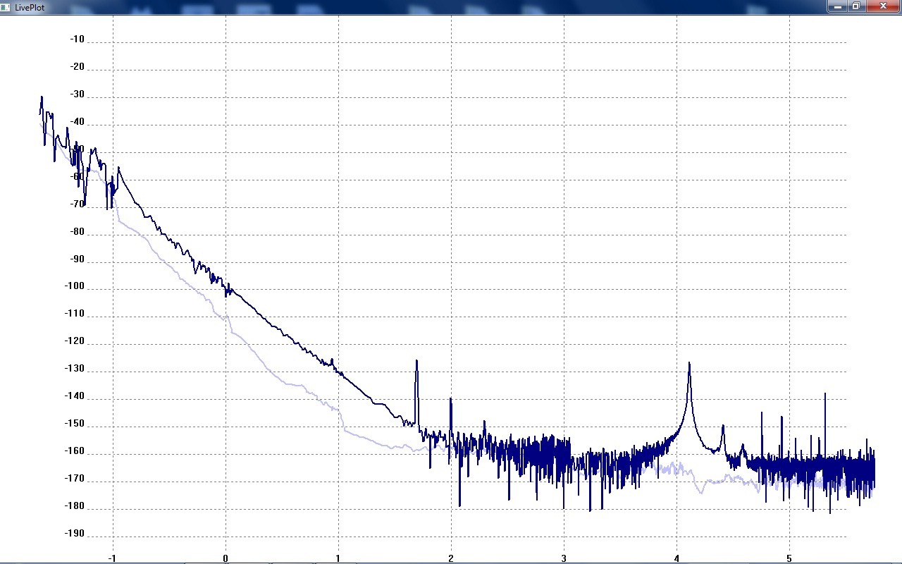

It certainly would be interesting to see demodulated clock phase noise measured from dac output. I should also mention that differences in clocks are visible in the measurements I have made. However these differences are quite small which again points to the dominant amplitude modulated noise.

Yes, amplitude modulated noise would most likely remain the same. As I said even in my measurement differences in clocks are visible but differences are small and nothing like what you see in clock phase noise plots. IMO this type of phase noise measurement is a simple way to ensure that Vref and clock circuits are working as expected.Question: if we have a nice working setup and only the Clock is changed, would the Amplitude noise in the system remain the same and any differences in what we hear can be attributed to the phase noise of the Clock or something else related to the Clock only?

I have measured some R2R dacs (e.g. AD1862, PCM1702) using the same method and result have been worse but that may be partly due to lower bit-depth. MarcelvdG's RTZ shift register dac could be interesting to measure as it should have very low noise Vref circuit so amplitude modulated noise may be lower.Based on some positive feedback on clock upgrades, these are mainly from those who use other type of DACs, like R2R, Discrete etc. I wonder if these types are more sensitive to clock jitter and will also show up in measurements of the DAC output?

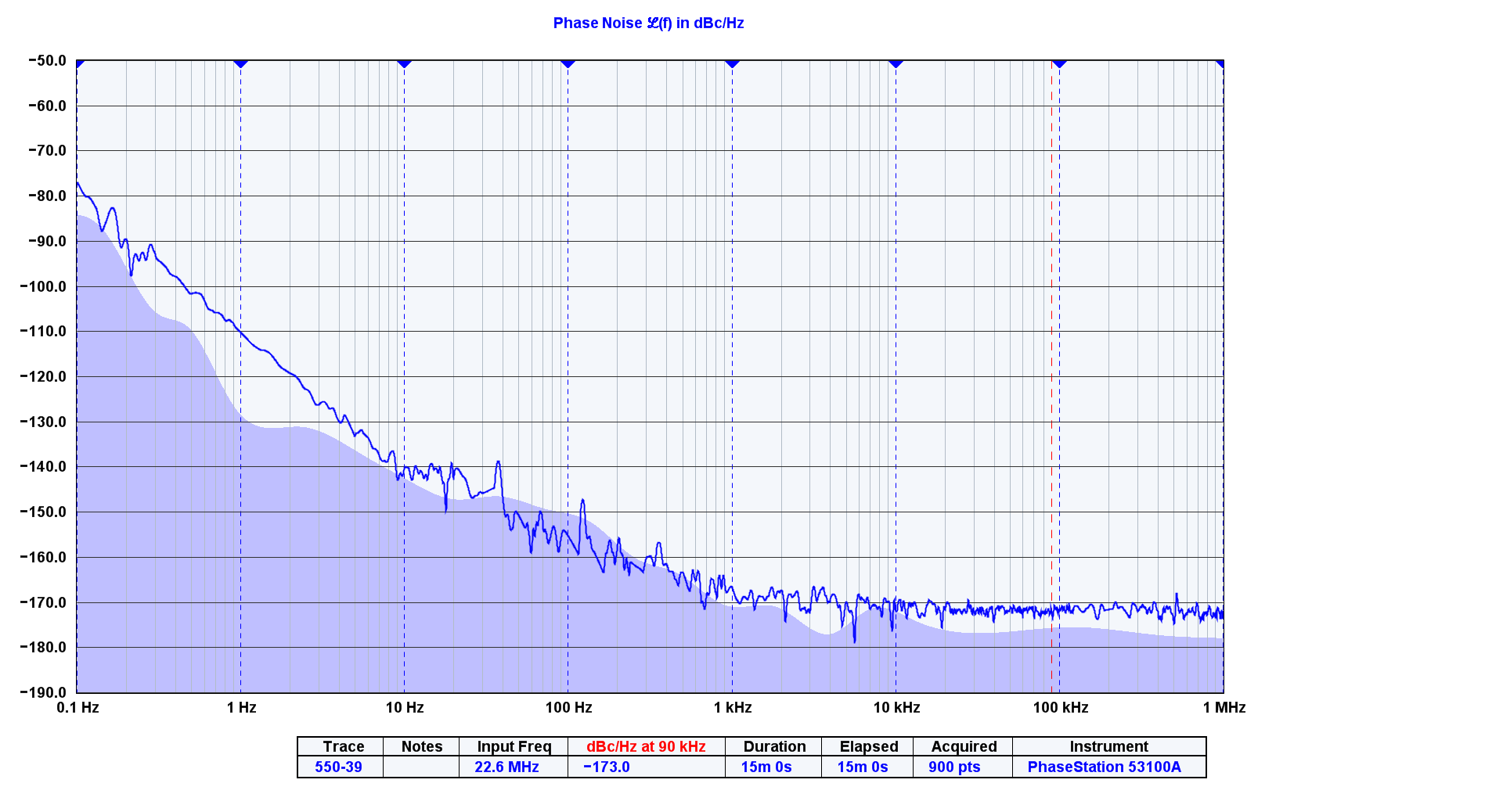

Clocks: $1 one like that you did measurement tests, NDK2250 select tested by Jocko and my latest AKX22 OCXO HCMOS version.
The plots show large differences between NDK and AKX22 to start with.

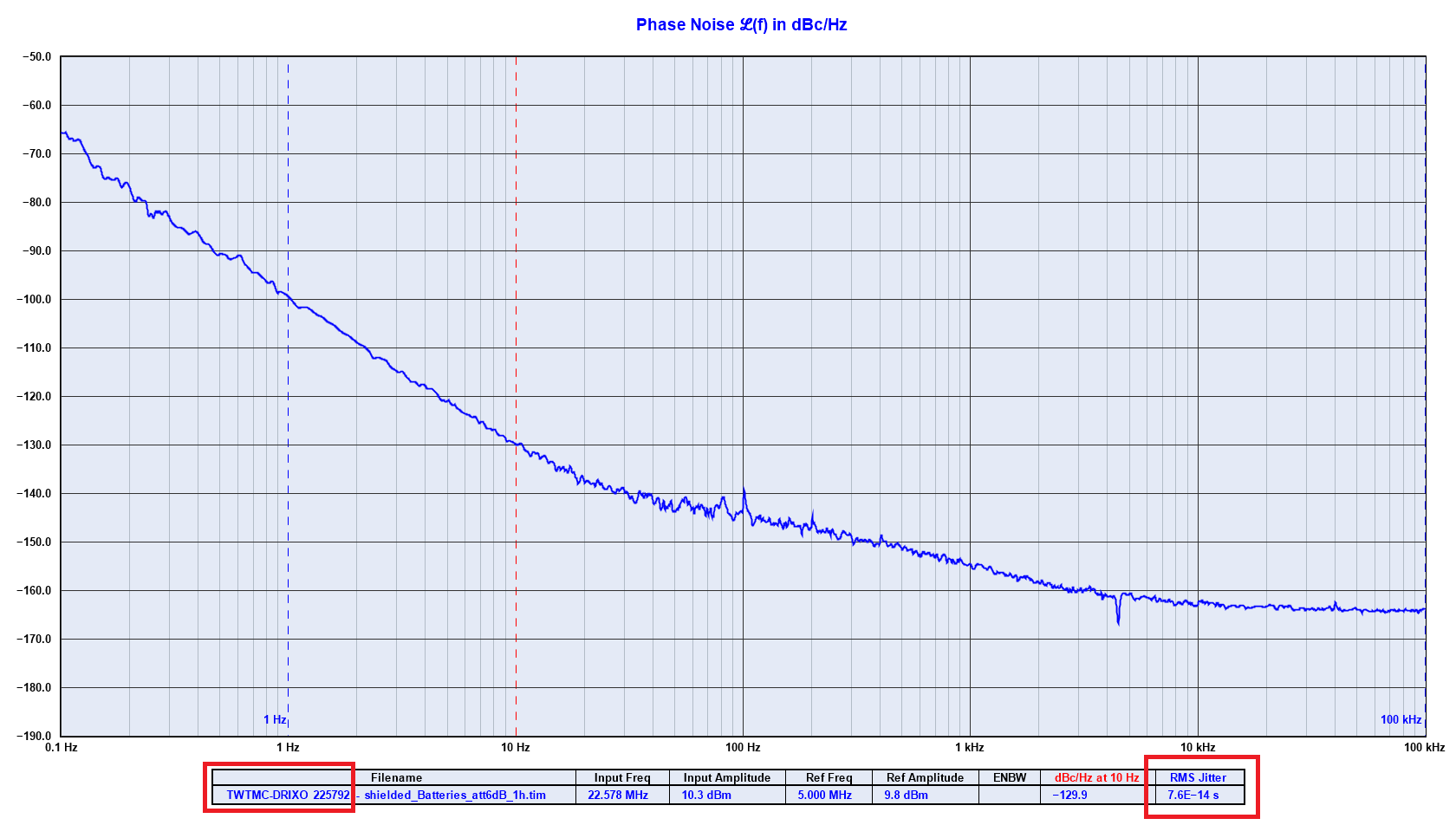

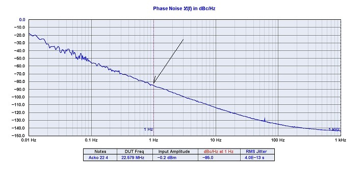

I have Andrea's 22,579 MHz Drixo, and confirmed that it sits exactly at the above values, as he had shown in his own phase noise plot as well.
Your plot shows -110dBc/1Hz & -140dBc/10Hz.
So Your 22,579 MHz oscillator is claimed to be 10dB better at 1Hz, 10Hz than either the original producers factory claim or Andrea's clock at the same frequency..
So .. are we shure that it is a correct, repeatable typical result that a random customer would receive ..? 🤔

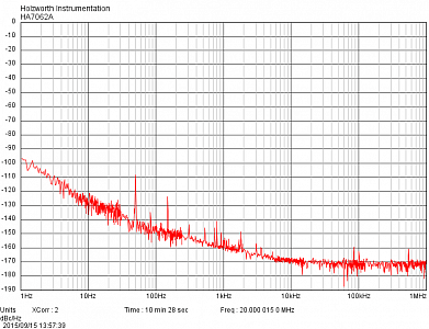

Very interesting, but I note some discrepancy: the producer displays phase noise results for different frequencies. They do not show 22MHz results but they have measured 20MHz units. Now that 20MHz phase noise plot is just slightly worse than -100dBc/1Hz & -130dBc/10Hz.My latest AKX22 OCXO HCMOS version

Furthermore, I have measured a Wenzel Citrine series 40MHz space qualified OCXO as well. I shows ~-87dBc /1Hz -120dBc/10Hz. That's light years ahead of any NDK, Crystek oscillators at this frequency.
Still, 20dB worse than your plot.. while according to phyics, at double the frequency it should be 6dB worse..
In other words: MagicXtal 20MHz plot gives -97dBc/1Hz; -127dBc /10Hz
My measurement for the Wenzel Citrine 40MHz OCXO is -87dBc/1Hz ; -120dBc/10Hz
The Wenzel shows close to 6dB (7dB) worse value at 10Hz point, at double frequency with respect to the MagicXtal oscillator.. Both of them great oscillators, and the physics is OK with them..🙂
I am not sure about other designs but I have got all my samples tested with similar results as measured by a calibrated phase noise analyser… So Your 22,579 MHz oscillator is claimed to be 10dB better at 1Hz, 10Hz than either the original producers factory claim or Andrea's clock at the same frequency.. So .. are we sure that it is a correct, repeatable typical result that a random customer would receive ..? 🤔
I can say that I have Andrea's clocks at 22/24MHz, and also at 11/12MHz with doublers (unmeasured ones though). Both have been tried with Andrea's DSD dac. Now have also have a pair of Acko 22/24MHz clocks. IMHO sound is of Acko clocks is closer to sound of 11/12MHz Andrea clocks with doublers. Also, Andrea indicated to me his own tests showed 5/6MHz with two doublers sounded best. That said, IME clocks are sensitive to power supplies, and clocks tend to improve over time if they run continuously.
