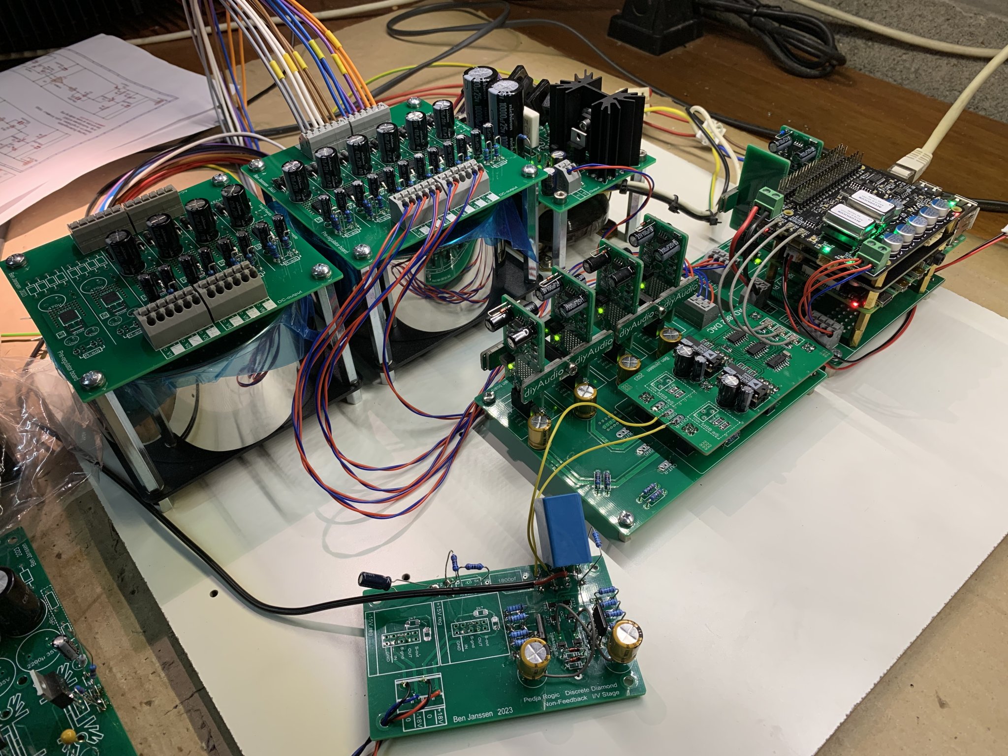

I had this same problem when I first built the DAC. I can’t remember what it was but I think the +5/-5/0 power was not correctly hooked up or I had some power issue. You get a weak badly distorted signal. It may be in some of my posts.Hi, yes verified that.
So I still have some OPA challenges and also need to be more confident to measure.
In general, as a newbie DAC/Streamer builder, who thought buying this "kit" and wired it together and you have a perfect DAC/Streamer..
I'm now back to reality...it is far away from an "average hifi electronic kit"!
So I will completly go back to step 1 and just build a simplified IAN Streamer and than move on. Currently even using my external Weiss 501 DAC and the SPIDIF from the Transport AES+ is disappointing bad streaming quality (lot of noise) - already disconnected my OPA and just using PurePiII.
thanks everyone for support!

To get start up, please keep everything default. Any upgrade would be after system gets stable.
If you are new to DIY, I would suggest started from a transformer I/V to avoid power supply issues.
"Currently even using my external Weiss 501 DAC and the SPIDIF from the Transport AES+ is disappointing bad streaming quality (lot of noise)"
That must be something wrong. Has to be figured out.

I looked back. I couldn't find. If I recall correctly, it was 3.3V supply issue somehow board didn't have 3.3v.I had this same problem when I first built the DAC. I can’t remember what it was but I think the +5/-5/0 power was not correctly hooked up or I had some power issue. You get a weak badly distorted signal. It may be in some of my posts.

Many new DIY enthusiasts often begin with projects that are overly complex. I recommend starting with simplicity, ensuring everything functions correctly, and then incrementally upgrading one element at a time. This approach helps pinpoint issues.
In many commercial DACs, the streamer contributes minimally to sound improvements because the DAC reclocks with subpar clocks and PSU. I've achieved better results by building a DAC, where clocks and PSU changes are more discernible.
As an example of an excellent starting DAC, I assembled a simple yet fantastic-sounding DAC using all of Ian's parts. Keeping Cost/Value in mind. You can find a link to the video on my channel for more details. You can use it as a starting example. See Flagship DIY Dac Video.

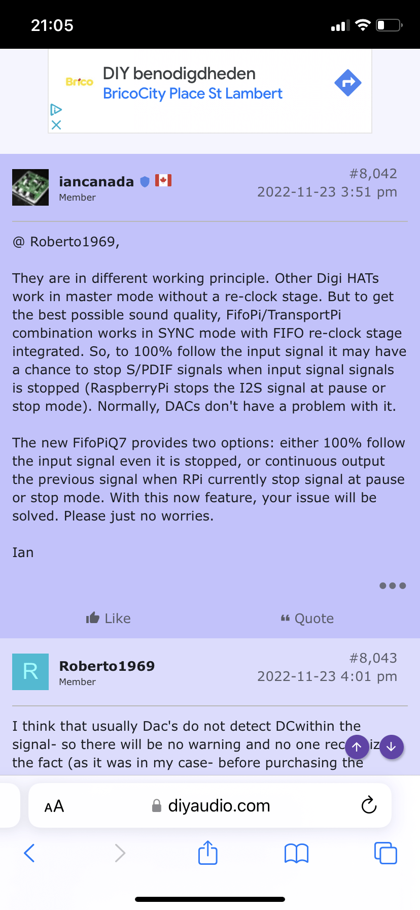

Hello all, as many of you already noticed and mentioned here. I have the clicking noise as well, when the Fifopi I2S stops when for example selecting another track. I found below post from Ian and I was wondering of this can be solved without the monitorPi?

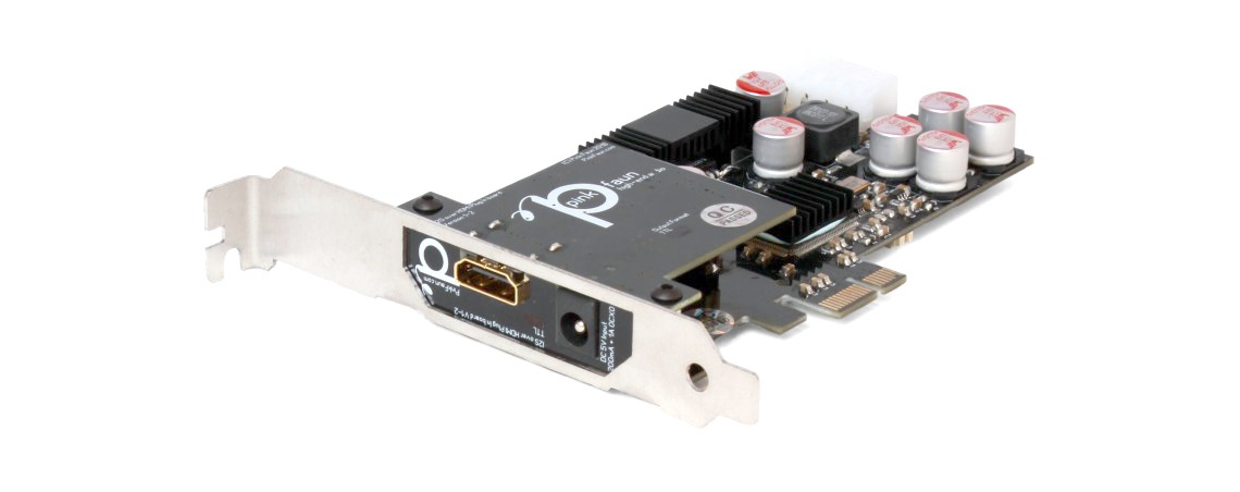

So I just want to point out besides USB, you can possibly output i²s via PCI-E from a PC (untested):
https://www.pinkfaun.com/shop/bridg...tml#/521-additional_clock_for_i2s_bridge-tcxo
https://www.diyaudio.com/community/...fight-the-jitter.192465/page-464#post-7435540
