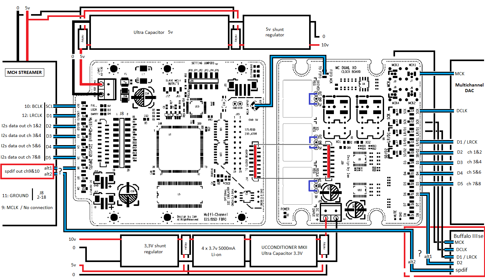

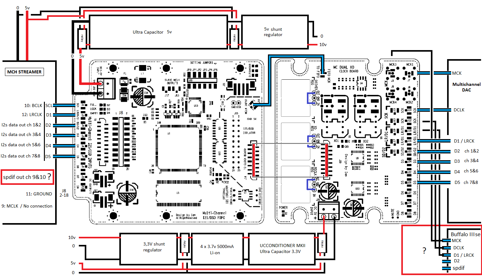

I have sort of promised a friend of mine that it would be possible to
connect an additional 2ch dac (BuffaloIIIse) to this clock solution.😳
Now I'm not so sure, even if there is some MCHstreamer firmware
that indicates something fairly close. If someone has a better clue
to this please let me know 😎

Dahlberg,
So the signal would be completely separate from the 8 ch I2S signal? You could easily send a duplicate D2 signal, but that may not be what you are looking for. Not real sure that mixing the I2S clocks with SDIF will work well. I would think that the SDIF data would be able to be passed through on D6, just not sure if that will give a better outcome than just connecting the MCH streamer SDIF to the Buffalo IIIse input SDIF.

wcwc,
Well it's not my project, it belongs to a friend of mine. He's got this
idea about a 5-way active speaker system and I'm trying to help
out (sort of). It looks spectacular on paper so it would be cool to
hear it at some point.

But still keeping all of the clock connections ?Dahlberg,
Not sure if keeping the clock connections with SDIF data will do anything.

The diagram looks good.View attachment 1245509

So, what the question is?

Hello Ian.
Question: Will any of these spdif connections work ? In the MCHstreamer mixer
it looks like there is no need for "spdif in" to get "spdif out".
From the manual, By default, the MCHStreamer uses its internal clock source (in spdif).
