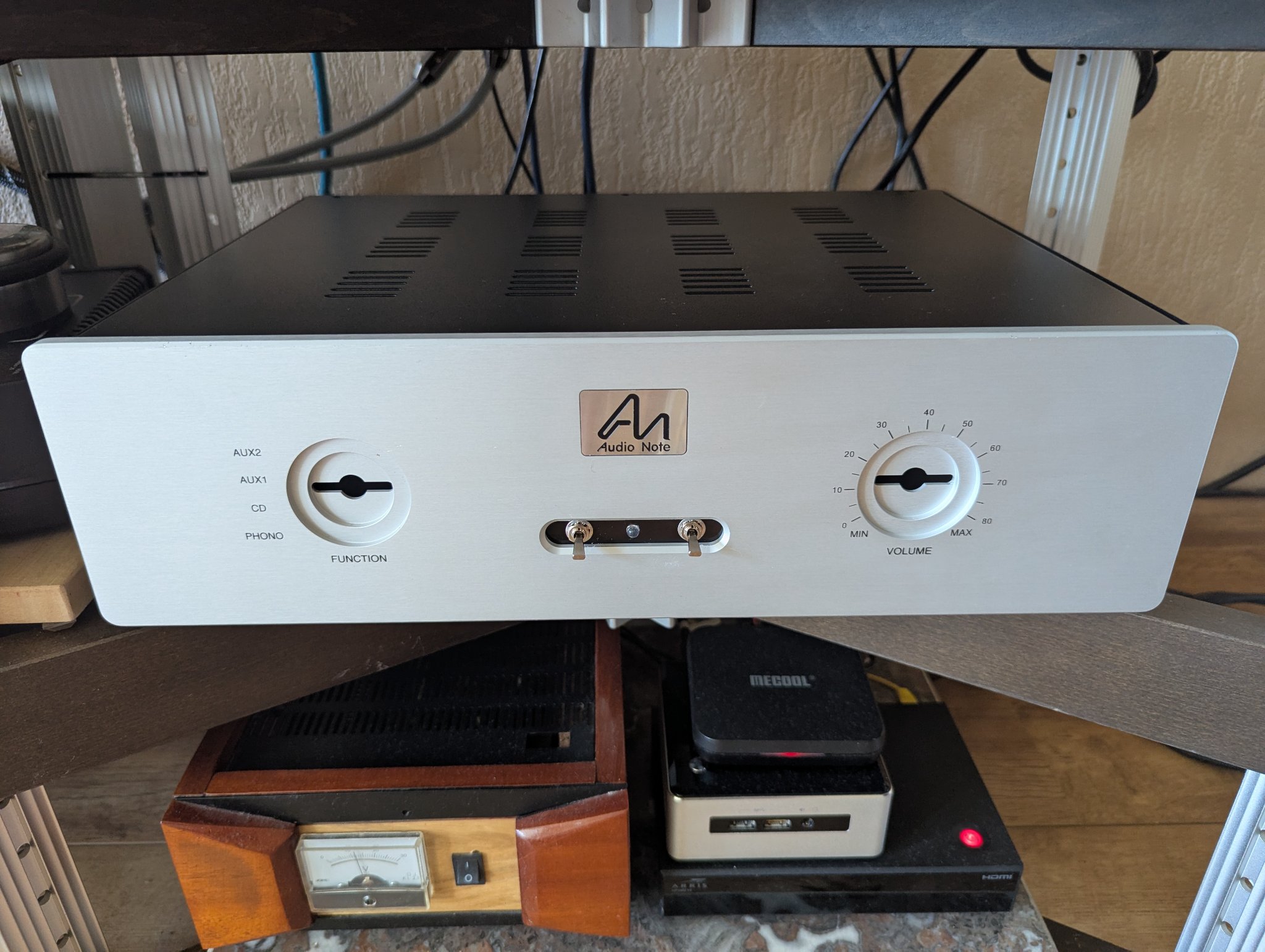

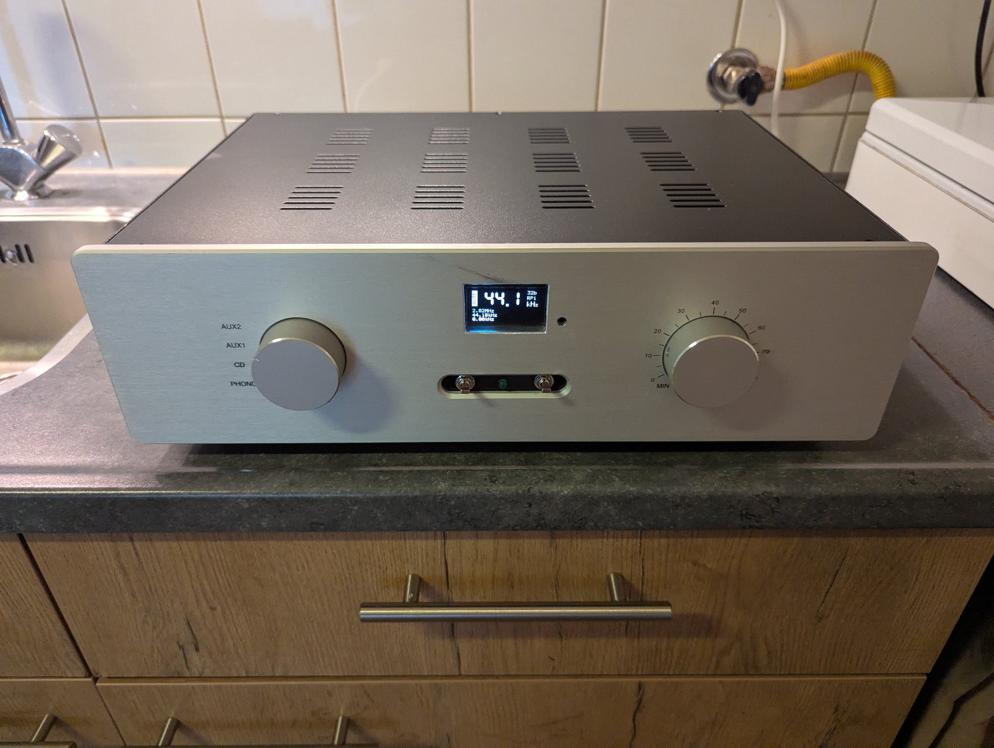

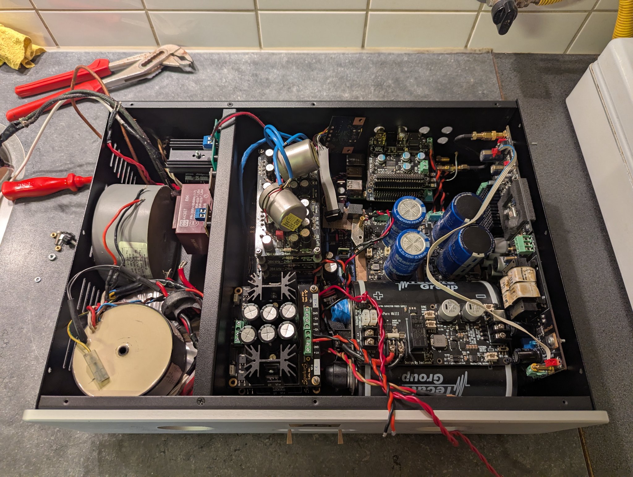

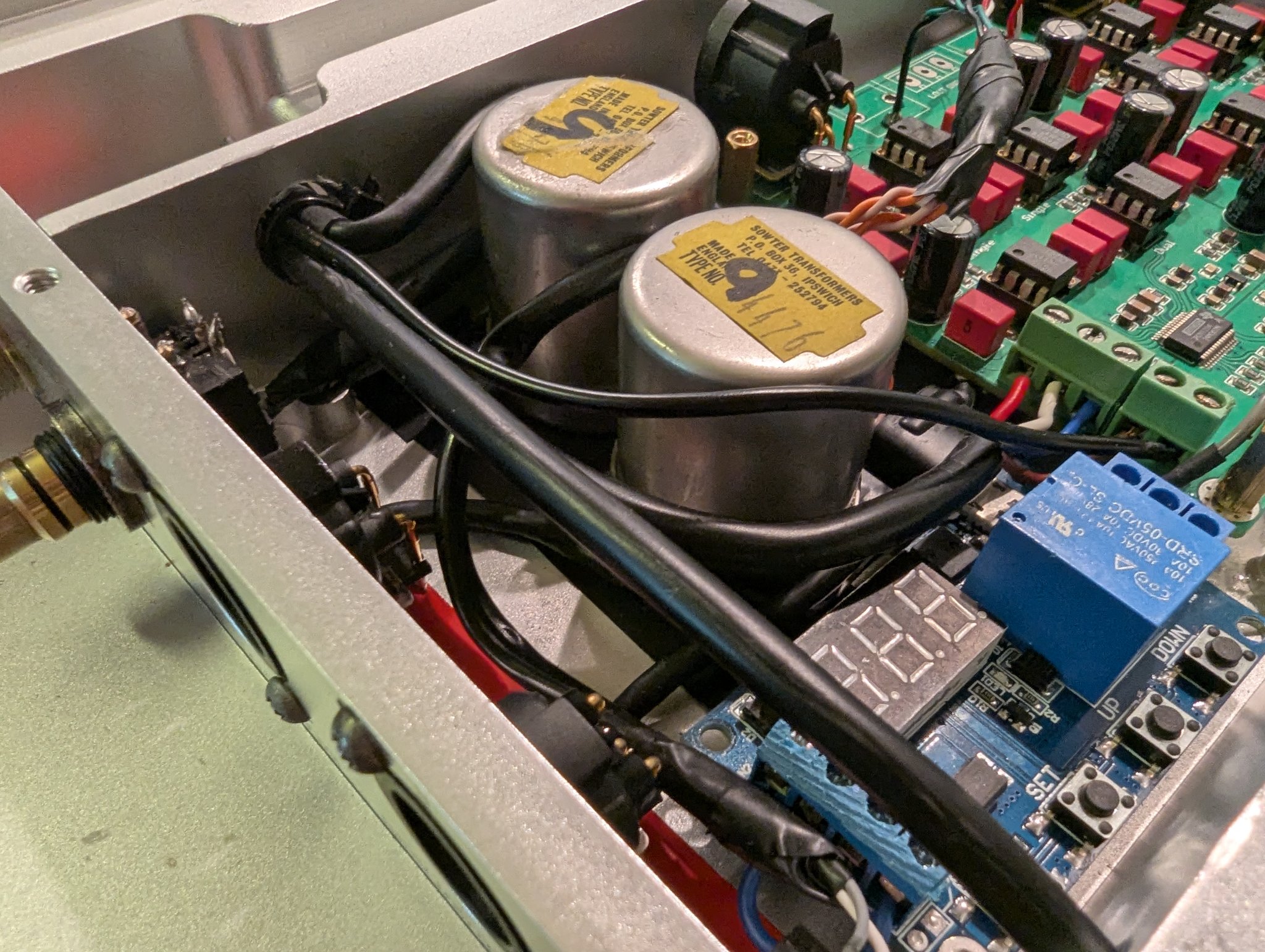

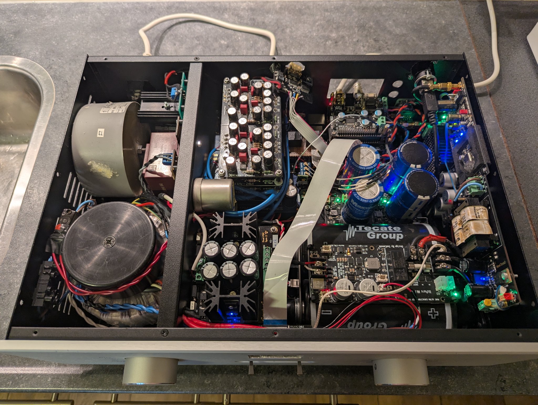

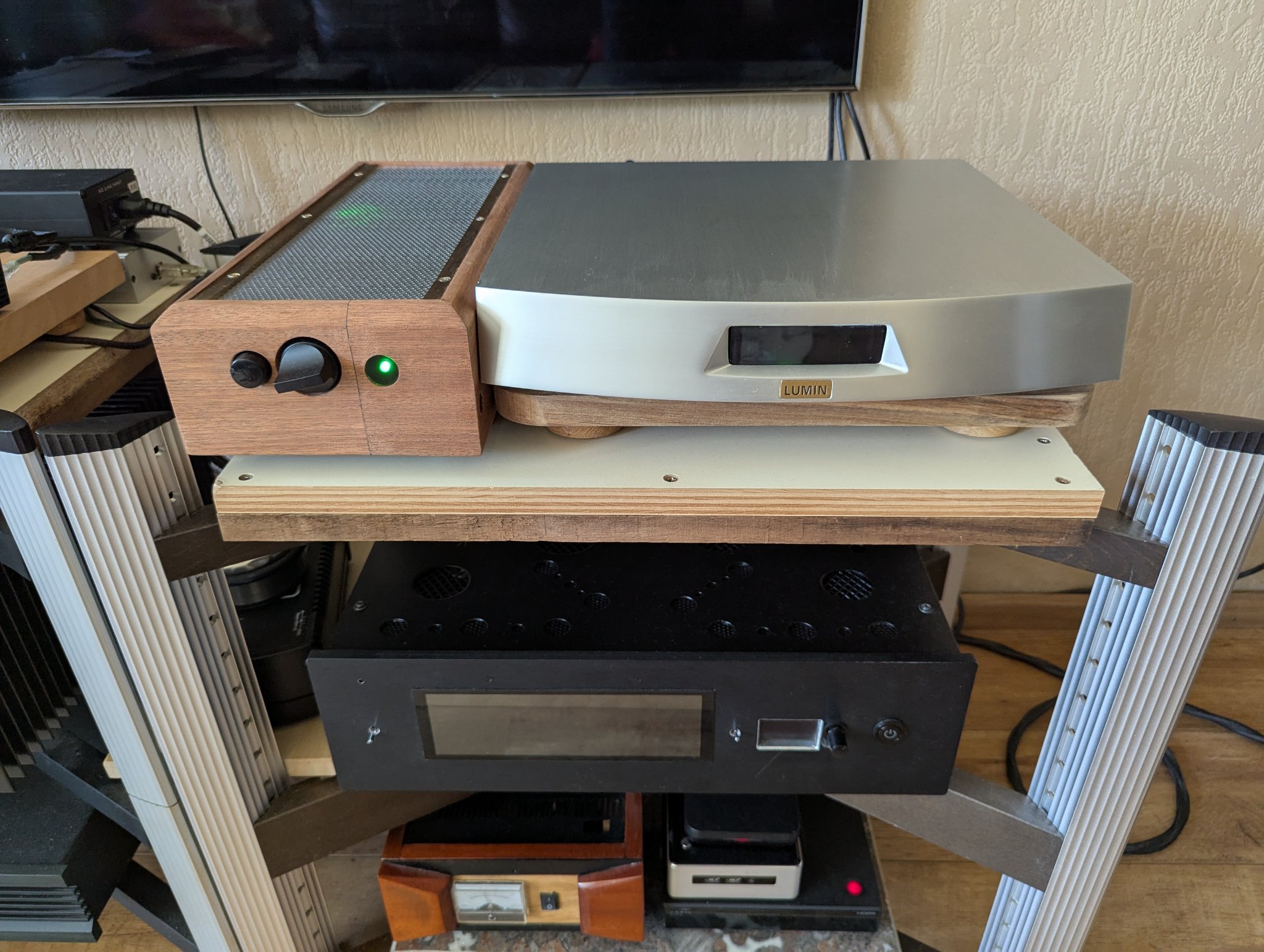

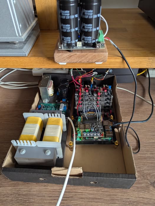

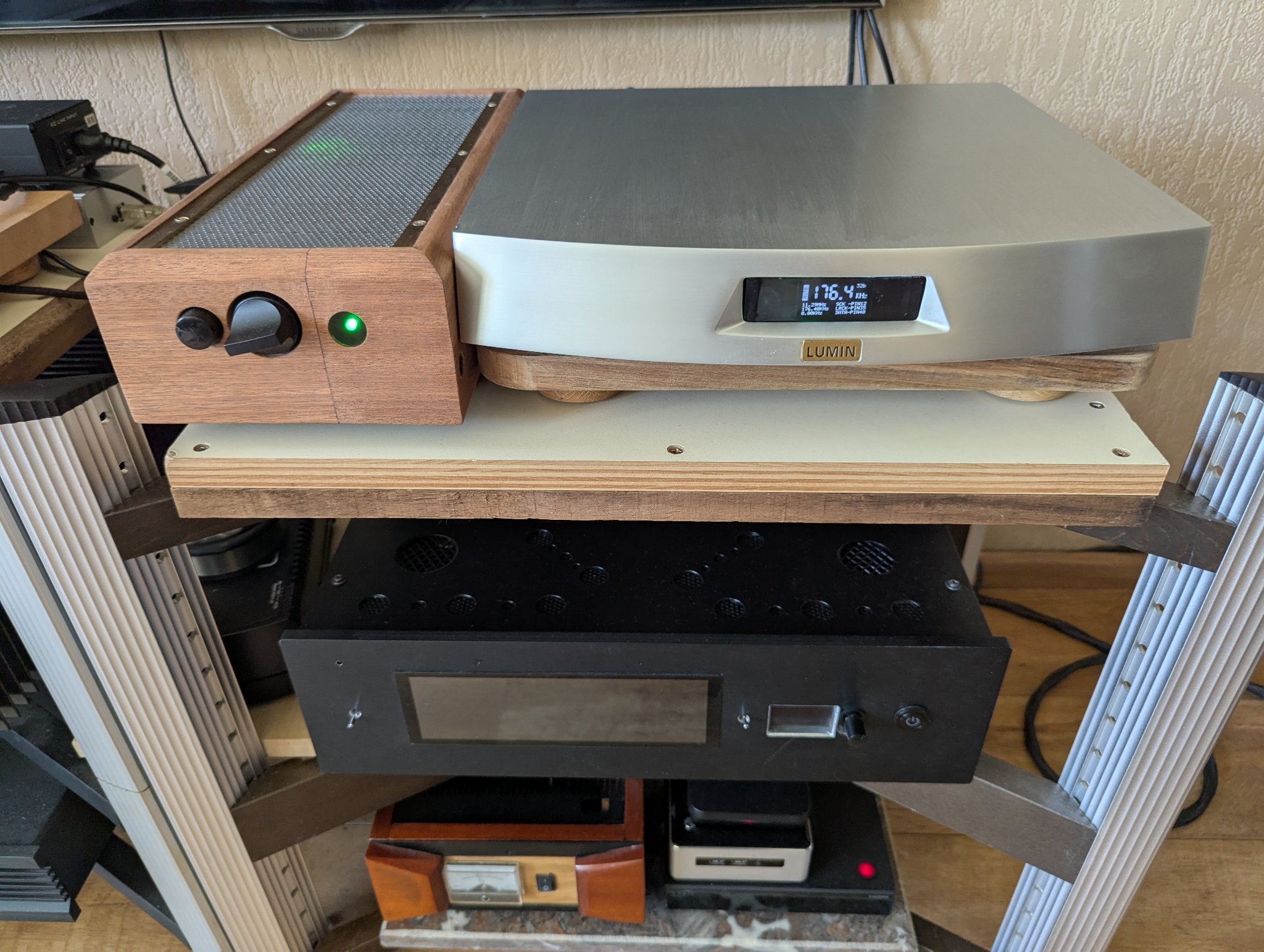

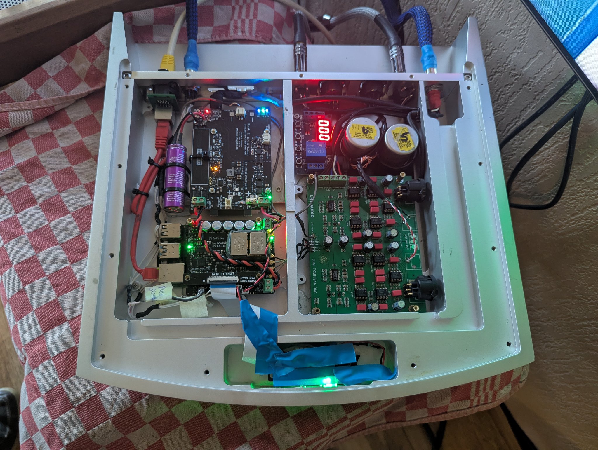

pcm 1794A in lumin S1 cabinet and external power supply ready.
lastly a few sowter Line transformers and a smoke coloring window made for it.
I think I'm going to have to build a separate PSU enclosure now too. I'm already up to 4 UCPures, and and I have everything except the super caps to build a 5th! And I think I'm gonna pick up the FiFoMa, since it's all I need to build a second streamer for my bedroom.and power supplies.
I'm not sure, maybe if I can do something like a double decker. I'd like to get it all in one case. My wife is starting to ask if I'm going to "put all that in a case." She asked me last night, "are you done spending money on this now, and are you going to put it in a case?" I didn't bother to tell her, "that would mean I'm not done spending money on this." 😉all 4 ucpure in a box or divided over 2?
She keeps saying it looks like I built a bomb. And when it was making the clicking sound, some times if I forgot to shut it off, it would start clicking while "idle". And she would say to me, "you're bomb is about to go off."
