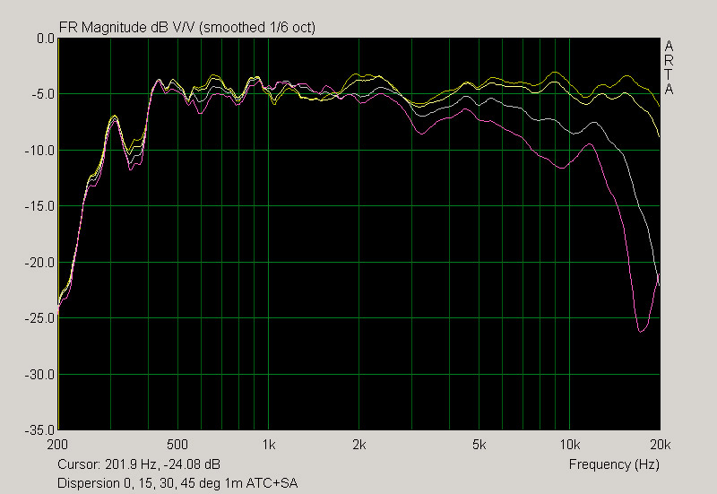

blackreplica said:Just for the sake of argument, i fail to see a compelling reason based on the objective measurements to choose this ATC over say, a Dayton RS52. In many ways they are actually quite similar. Distortion levels are similar. Breakup on the rs52, being much higher in frequency means the usable passband on the dayton is larger although the hard cutoff for both on the low-end is about 500Hz. I am not sure about how the dayton fares in terms of dispersion, but being a 2 inch dome, it cant be any worse than the ATC. The biggest difference here is the fact the dayton can be bought for nearly 1/10th the price
Thoughts?
zaphs rs52 test: http://www.zaphaudio.com/smalltest/
I think mark K tested the dome as well and produced similar results
The RS52 was tested at 90db/1m. I did 90dB/2m or 96dB/1m. No doubt the budget Dayton would fall to pieces before the ATC would.

Well the figures shown at the beginning of this thread were taken at 96dB/1m. 110dB and clean performance is a big ask of any driver. I really wouldn't like to speculate about such things considering the $700 price tag of an ATC mid. My guess is that it would happily play in the 600hz+ range with steep 4th order+ filters at those levels and still remain subjectively clean. I'd think THD would be in the 2% range across the passband but that's a guess based on previous performance and assuming a relatively linear rise in distortion with regards to output.

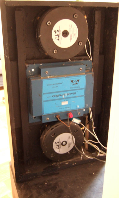

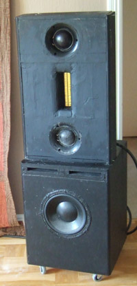

I Use the domes in MTM configuration coupled with a Stage accompany 8535 as tweeter🙂tinitus said:Seems to me these mid domes especially would be some benefit from a MTM configuration
Are those running in a 2.5way because of the large centre spacing? Also do you use SM75-150 or SM75-150S?
BTW A formidable setup you have there.
The spacing between the drivers is a consequense of their physical dimensions as you could see in the attached image🙂. It is the S-version and I cross them electronic at approx. 1400 hz.
Compared to use "only" one mid per channel my subjective impression is that this configuration gives a more precise and controlled "soundstage" and more "body" to voices etc.

Patrik:
Wow, very interesting (and exotic) setup you have there. Would you mind providing some more detail about it? What woofer, what are you using for a crossover? Whats the story behind the cabinets? Thanks. I'd love to see more pictures too if you're so inclined.
m0tion said:Patrik:
Agreed. Those ATC are addictive so the more the better 🙂 Despite the smallish picture I believe the visible bass driver is a 9" ATC probably SB75-234 in either SC or LC variant. The SA planar is another well regarded driver. You might remember Thylantyr who uses about 8 or so per side in line arrays. Alcons and SLS also have best of breed planars but these aren't available to DIY'ers sadly. I think the Alcons is designed by the same chap who originally did the SA.

The bass driver is ATC SB75-234 SC. The cabinets where made about five years ago and I´m still not shure what kind if configuration I should go for. I have more bass units of the same kind and a pair of ATC SB100-375 SC to choose from 🙂.
The crossover is of the swedish brand "Supreme" and is custom built for this application. I will try to make som kind of measurements in the next weekend.
