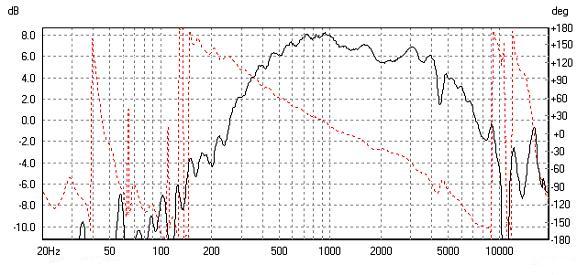

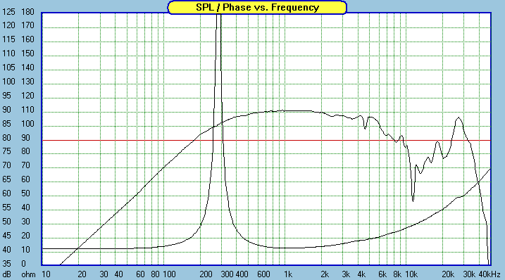

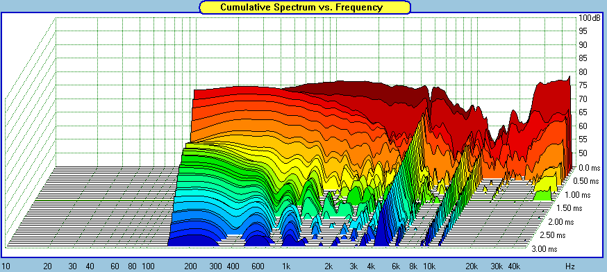

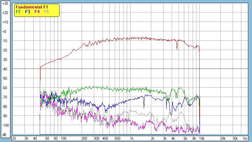

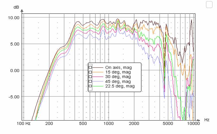

The images are coming from Zaph's blog. Here is the CSD. Some kinda resonant thing starting at 4k, as you'd expect from the FR. Note the scale on both axes is rather unflattering, not that I think that's a bad thing.
Amazing how high a Qm this driver has, when you consider the doubel suspension system an all. I guess it must be a no-conduction voicor former it is made with, even I would not think it would be that standard when this driver was developed.

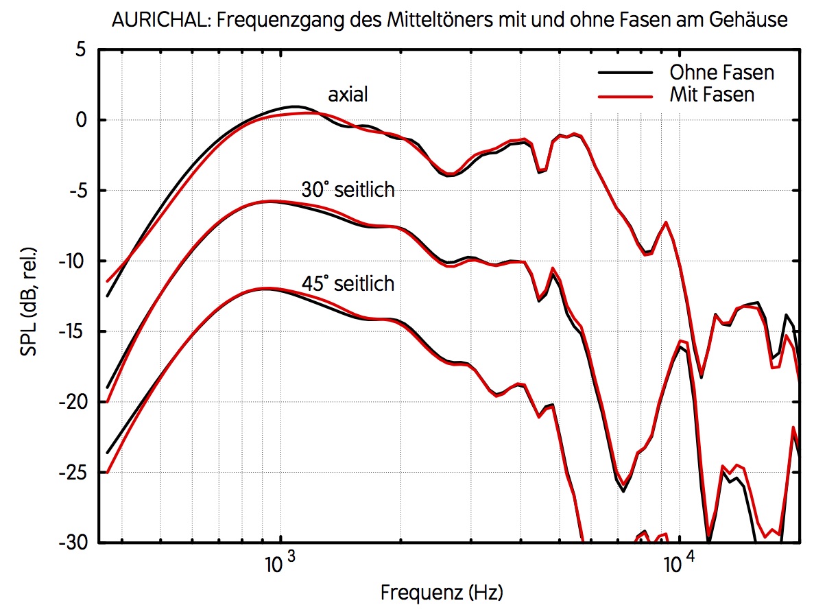

The issue with the Volt VM752 is the notch in the frequency response at 2.6 kHz. Designing a decent passive crossover at 2.5 - 3 kHz is very difficult under these conditions. The notch only is mildly visible in the manufacturer chart, but clearly in the measurements of Akltam and Bushmeister.

I observed a similar dip with my design unsing the ATC SM75-150, although not as pronounced. This seemed to be related to baffle edge diffraction, not so much to the driver itself (see attached measurements).
Looking at it simplistically a curved baffle edge will add some correction?
No. In fact, the black curves were measured with a flat, rectangular baffle; the red curves with a chamfered baffle (the chamfers were as large as possible for the given baffle width and driver diameter). The chamfers don't change anything. The wave length at 2.5 kHz is about 0.14m, so the chamfers would need to be quite large to have any effect at all. Siegfried Linkwitz says about this: "With most speaker cabinets the radius or chamfer is acoustically too small and is primarily cosmetic."
The only thing that helps to reduce the dip is to offset the driver from the center of the baffle, which smears out the dip to other frequencies. The same happens with off-axis measurement (as demonstrated in my measurements shown in my previous post).
Yes not enough, the results would be minimal. Have you had the chance to measure them on an offset baffle?
Yes. See measurements, model data and photos here: http://hifibau.ch/optimierung-der-schallwandgeometrie/Yes not enough, the results would be minimal. Have you had the chance to measure them on an offset baffle?
