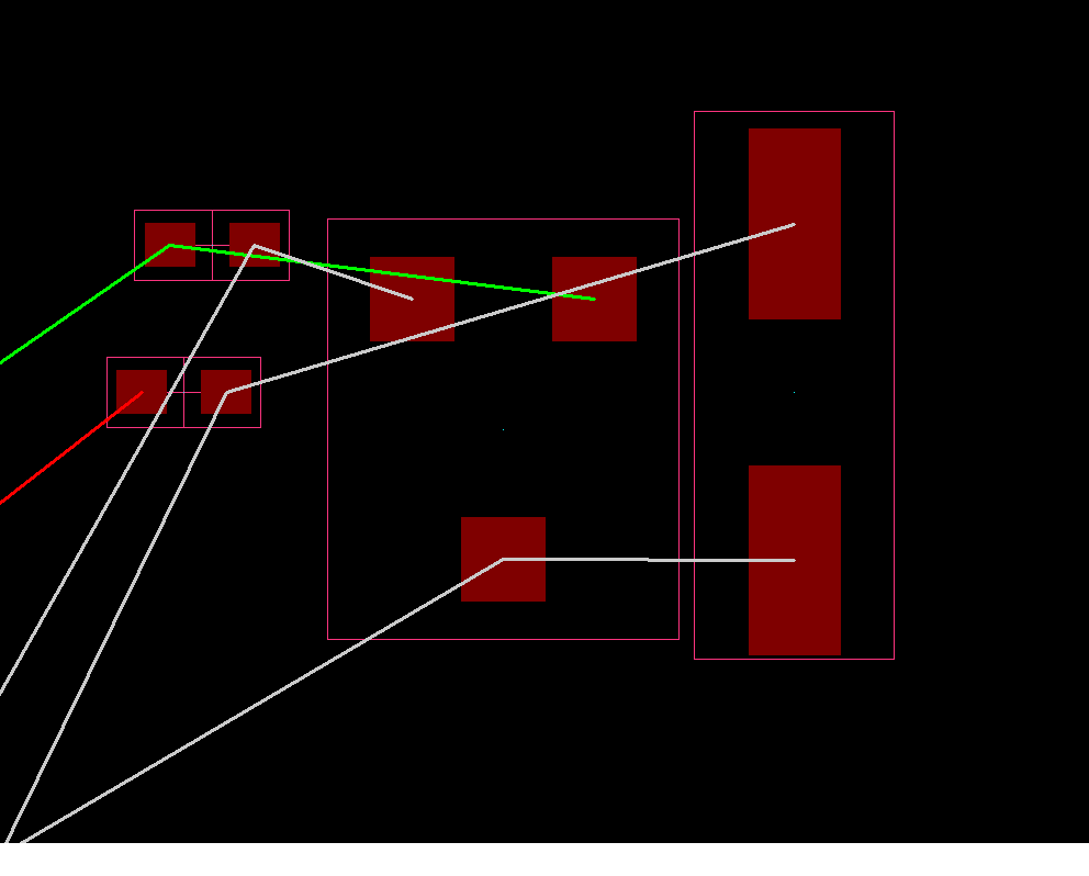

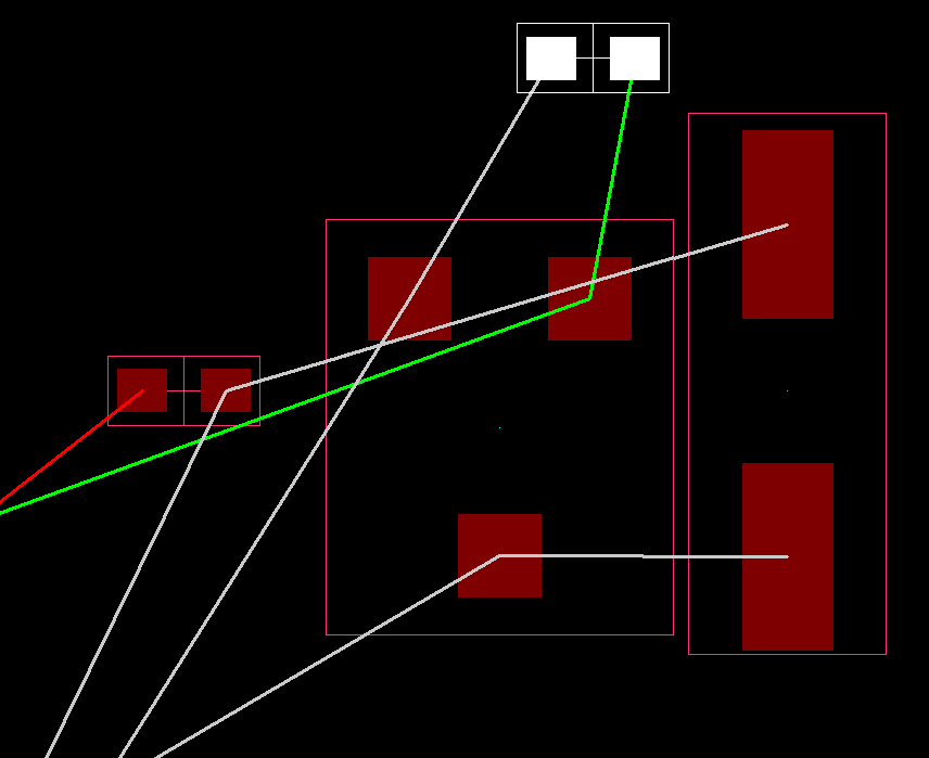

Rubber banding, the connections between pins are visible while you move components, and generally jump to the nearest pin of the same net during component move.
The two pictures sort of illustrate what rubber banding is...
Yes I agree, 27 years of doing the job (the most critical learning factor) and studying the academic side has wired my brain to see patterns in PCBs especially during placement. Same as with your graphic experience, one that I am learning, and finding interesting and challenging.

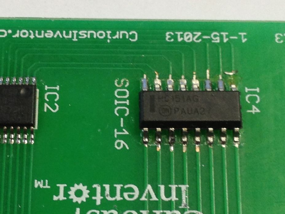

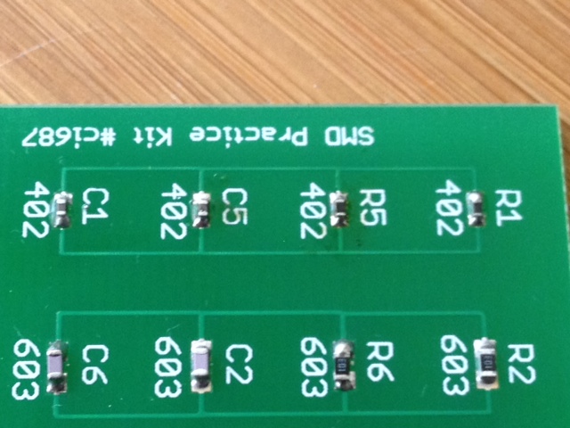

For those hobbyists not wanting to go the DIY reflow oven route, the Atten 858D+ reflow station ($62AUD), makes SMD work very easy having not done any of this type of soldering previously. Highly recommended.
Attached pics of a test smd pcb kit... ic's were removed and resoldered with paste. R6 was the only component done by iron, easy to see the difference.
