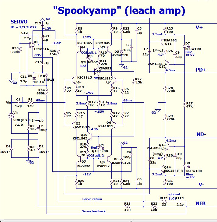

Great post Jesper, this is a great summary.
I have been thinking along the same lines.
I was thinking of tackling this experimentally and with simulation.
For example, making a ground plane PCB and star ground PCB of the same nominal design. And actually measuring the performance of the amplifier.
I don’t have access to any fancy EM simulation tools, but I was talking to the creator or one, he was happy to run the simulation given that the results be published online for publicity.
I would be delighted to make it a group effort if other people want to join.

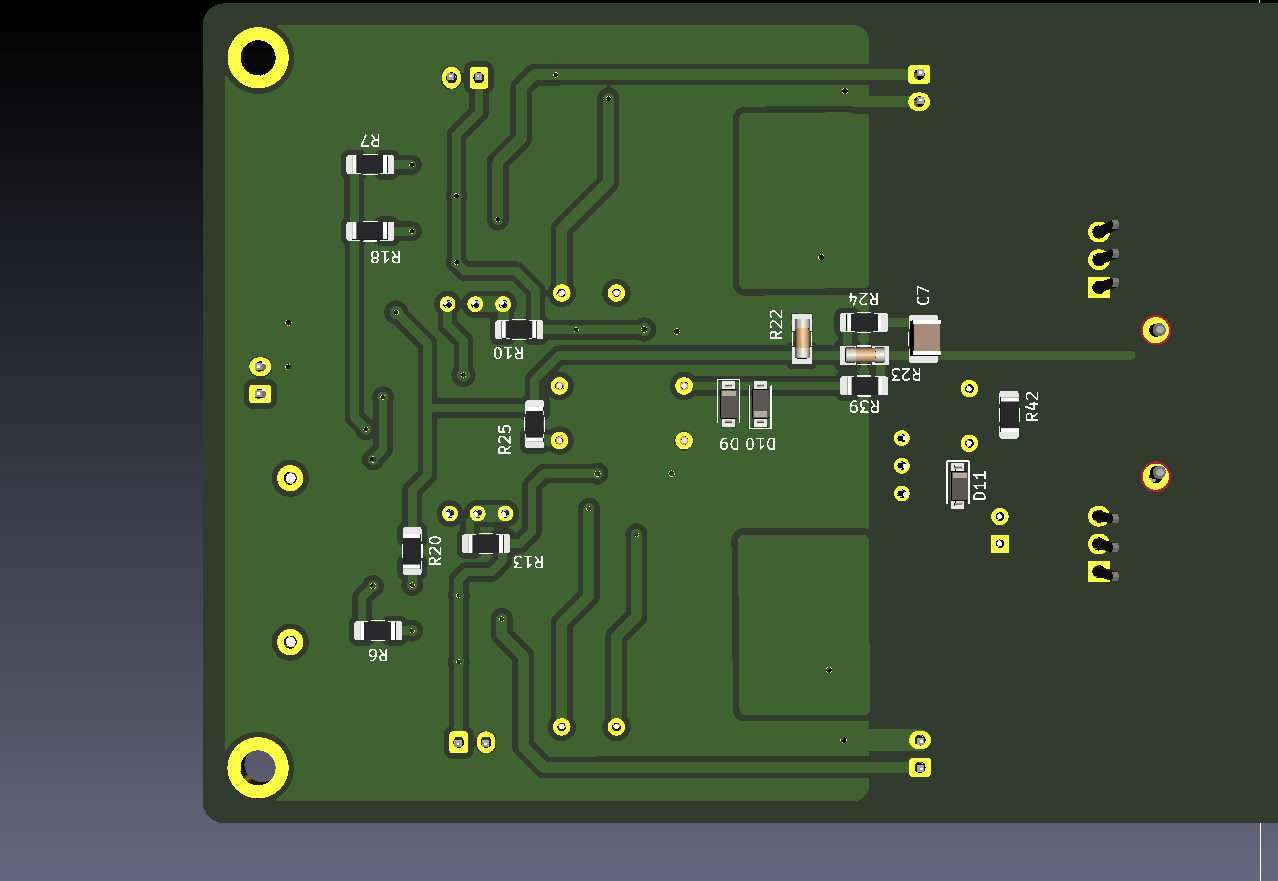

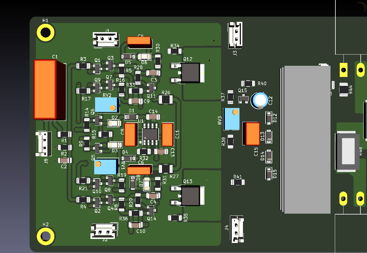

A few ideas that come to mind:
Prioritise track lengths. If they can't all be short, look at I/O resistances. For instance, an op-amp output with a 1M resistor: on the op-amp side the signal is strong, but on the receiving end (JFET base, NFB etc), which may be far away, the signal is much more susceptible to noise and RF so the resistor needs to be very close to the receiver.
Capacitors also act as voltage sources.
Differential voltages: ground planes are a bit of a cure-all, but tracks that are related by opposite signal polarity should usually be kept close together (same principle as twisted pairs and CAT-5 cabling etc).
Sometimes a scrunched up layout may help to reduce loop area, which helps to reduce parasitic inductance.
Thermal issues: ground planes can make things hard to solder, so use thermal relief 'spokes' where possible.
I find that ratsnests can be annoying if there is too much going on all at once. So I colour code things like power planes. Or they could even be temporarily made "no connection" in the schematic, to really help focus.
None of the EDAs I've seen allow you to separate "common" connections to 3 or more components into subcomponents, so you have to pay attention if you want a thin signal line hanging off a fat power line. Adding test points on the schematic level could helpful there.

BTW: In your layout design above - have you considered making the board a "2½ layer" design? By this I mean keeping a quite contiguous GND plane and then routing wires on the bottom side to the places where this is unavoidable? It is my impression that if the wires are kept close to the GND plane - and it is audio frequencies - then this may be a cost effective way to "increase" the layer count of the board. Just a thought ...It could be the case that compromises may need to be made somewhere in the product design phase and processes.
My thought here is that this thread was started in 2013, and the OP might not be that active anymore so that gathering relevant information in post #1 (for all to easily access) may no longer be an option ...I'm not sure splitting this thread into a new one is such a good idea, I would probably say this is probably the best thread to accumulate general knowledge for pcb layout guideline and techniques.
Anyway, the day is approaching - cheers,
Jesper
All very good points, I have learnt many things along the way from other peoples designs when laying out my pcb and I'm still tying to understand all the return current paths, made all the more complicated by the fact I have added to the design +/-15vdc and +/-50vdc regulated supply rails.
Yes I have, it's the 3rd attempt at the layout. I got part way through the first two layouts only to come to the conclusion that it didn't quiet look right. It's a fairly tight layout, most of the tracks are on the top layer and where I couldn't route was put on the bottom layer and used ground pours on both layers, probably not ideal and I have to move the DC power supply inputs because the ground pours are obstructed for the return currents. I can change to a 4 layer board if required without changing the component layout and this will give me a proper ground plane to work from. The next challenge is the driver and output stages and how to route the high current return ground tracks, this is where sometimes looking at other power amplifier layouts can help.
BTW, the amplifier is a slightly modified version of this circuit from this thread - Slewmaster - CFA vs. VFA "Rumble"
The difficulties laying out this circuit arises from the push pull differential input stage because you have tracks crossing over from the edges of the pcb to the centre. As seen from the bottom image in my post #105
