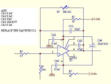

SYSTEM ONE NOISE FLOOR IMPROVMENTS.
Analogbuff
The AD797 will replace the NE5534 and usually have better noise floor.
Some of the Systems may not have much improvement in the noise floor while others will show 2-3dB better noise.
1. Run the noise test on both inputs A & B as a reference.
2. Remove the NE5534
3. Add the AD797
4. Add new PS bypass parts to back side of the PCB (CA1, CA2 & CA4)
5. Add CA3 (47pf)
6. Replace the 10pf cap with CA3 (22pf)
Note that the A and B PCB layouts are a little different.
I have also looked @ the LME49990 SOIC with DIP8 adapter and this also needs PS bypassing. No firm information yet to post.
Good Hunting
Duke

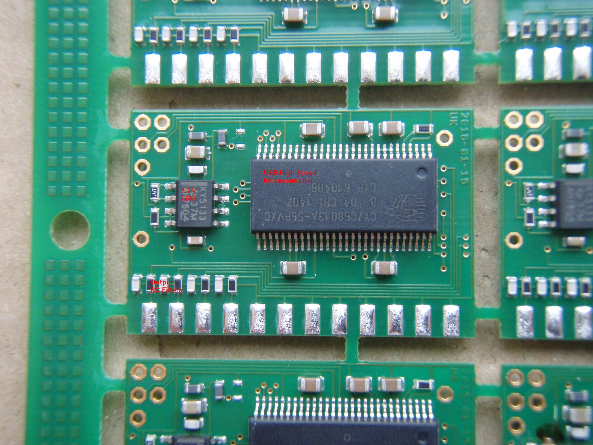

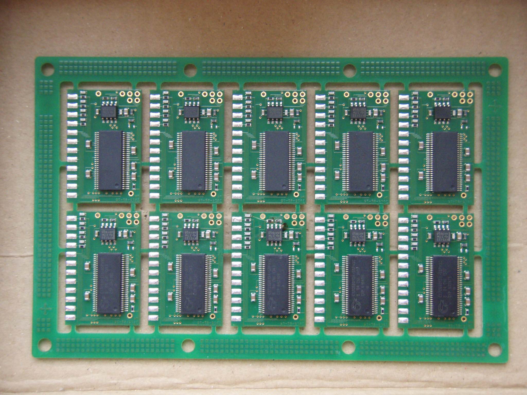

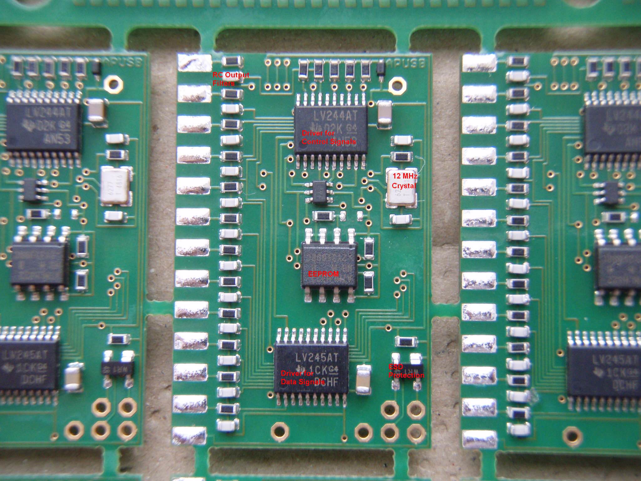

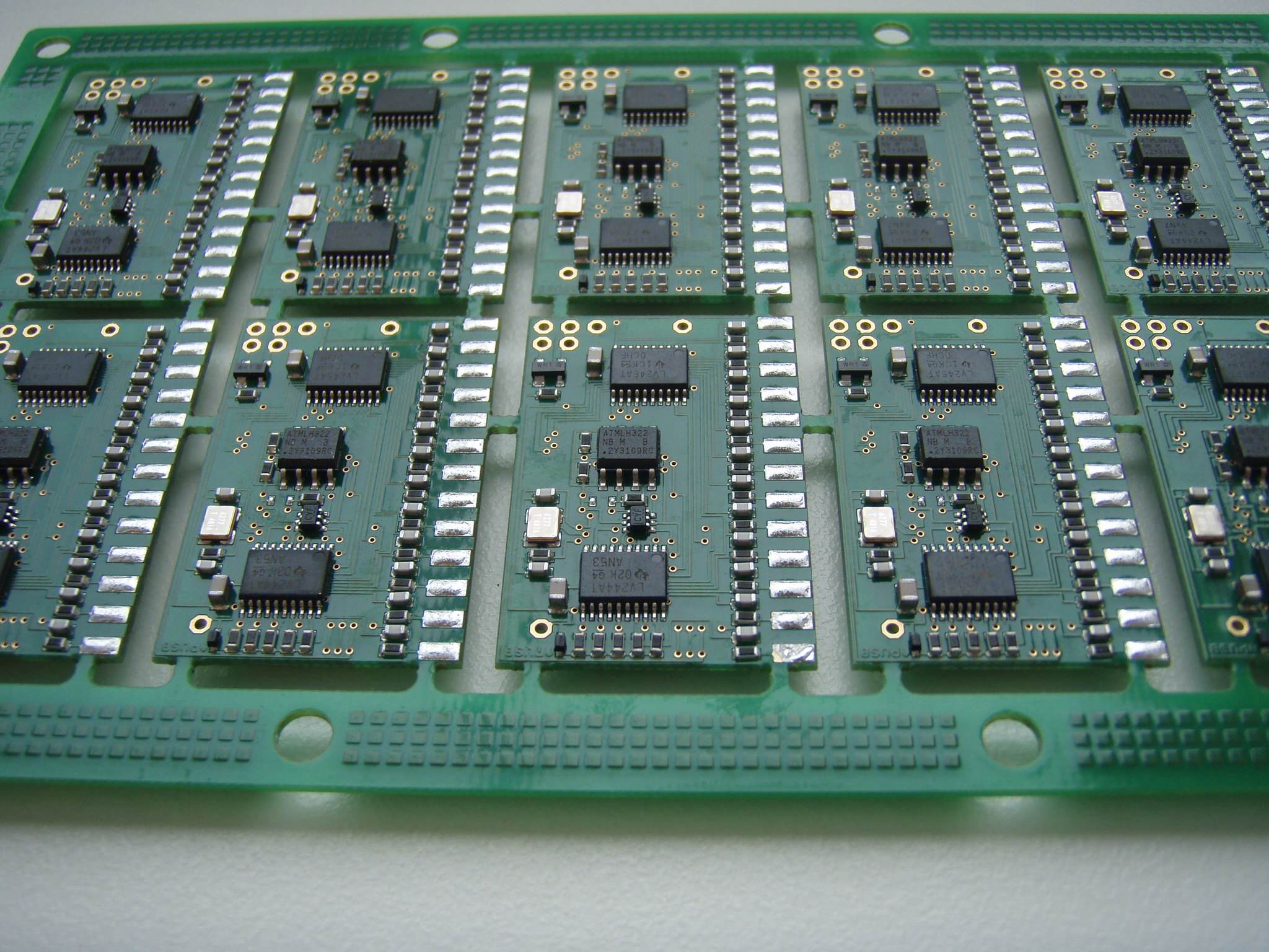

Hi all,
I received 20 assembled prints last week. I attached some pictures of the PCB panel with a short description what the chips are doing.
I am working at a project in Germany until the end of the week and unfortunately did not have the time to solder the connectors and USB cable and ship the interfaces. The next weekend i have some spare time and i will solder the connectors and send the first interfaces.
In comparison to the first print i changed the plating to gold flash and the thickness of the print is now 1 mm. Some minor changes in signal layout and some pin swapping were done too.
The top side has 44 components and the bottom side has 22 components, in total 68 components (hope i counted right).
Thx, Udo

Hi all,
Thx, Udo
right angled trace corners (90 deg):up:
Don't often see them🙂
Sorry for OT.
