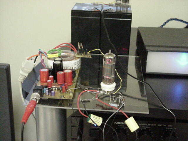

markgall said:
Hey Karma,
What circuit are you using for the tube buffer? Which tube? Do you have a schematic? Are you using another transformer for the tube buffer or powering it from the dac transformer? I've decided I'm going to get one of Peter's DAC's and was thinking I may like to add a tube buffer also.
Thanks,
Mark
ill post stuff when finished on my webpage.
this thread is for peter.
cheers😉
