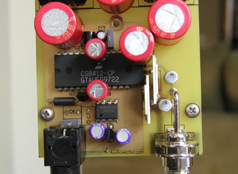

NOS DAC CS8412
While assembling your NOS DAC and reading through previous posts, I noticed on post #52 http://www.diyaudio.com/forums/showthread.php?postid=586980#post586980 that 4 pins are removed on the CS8412. They better be 13, 14, 15 and 16 or I'm in trouble![xeye :xeye: :xeye:](https://files.diyaudio.com/forums/images/smilies/xeye.gif)

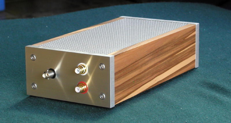

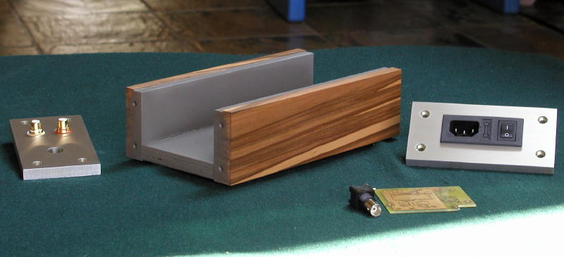

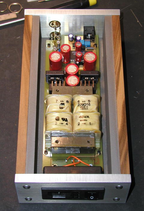

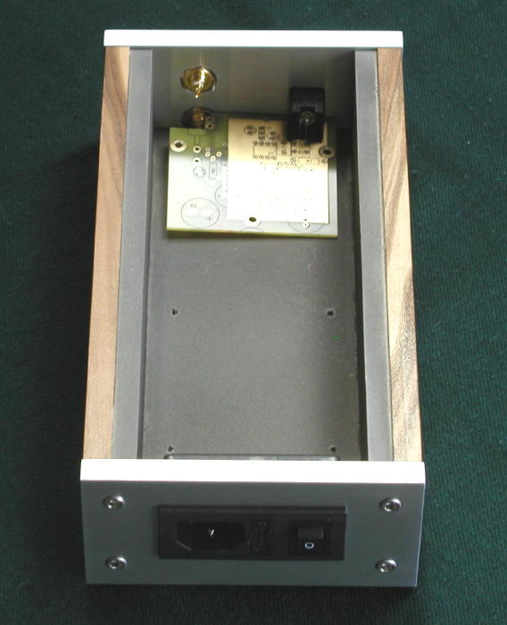

Here some pics for chassis construction.
Start with a U channel made out of wood, with metal plate front and back. You may spray the inside with conductive nickel paint, although it's not necessary.
I also have the feeling that this DAC is quite special, I'm using one myself, and I'm not tempted to put on the Levinson ML360S in a system at all.
