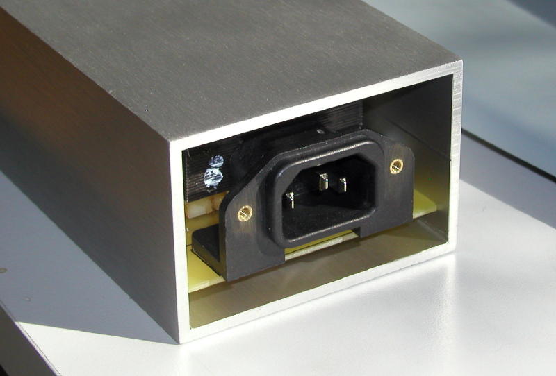

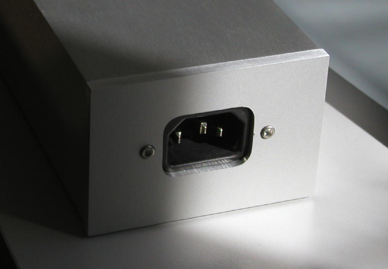

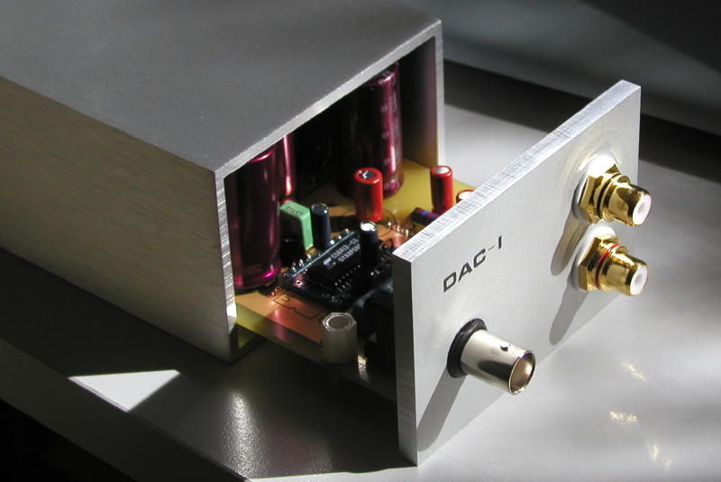

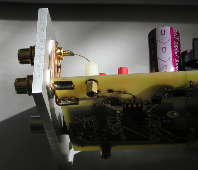

Peter Daniel said:That assembly slides into 2 x 3" aluminum tubing, the board is attached to the bottom using six 1/4" standoffs. That locks the front plate in position.
2 x 3 ordered.

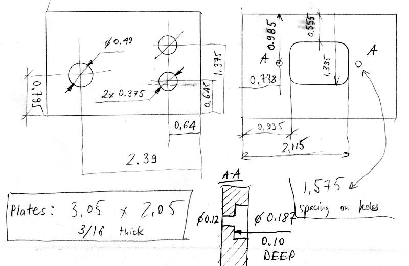

Have you got diagrams with sizes for the front and rear panels?
sweet found one in my area.

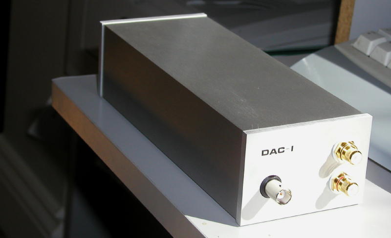

karma said:what grit do you recommend for sanding fresh cut aluminum. to give it that nice smooth finish?![]()
I use 100 on a belt sander.

2 x 3 ordered.
Peter Daniel said:Yeah, I got the drawings and can email them to you.
if you get a chance may i get a copy?
thanks
However, the DAC in a wooden enclosure sounds better, and even better without any enclosure (that's how I'm using mine).
Yes please. My email is i dot j dot russell at tesco dot net.
I am going to build both enclosures and see which I like best. Unfortunately, domestic arrangements require an enclosure.
