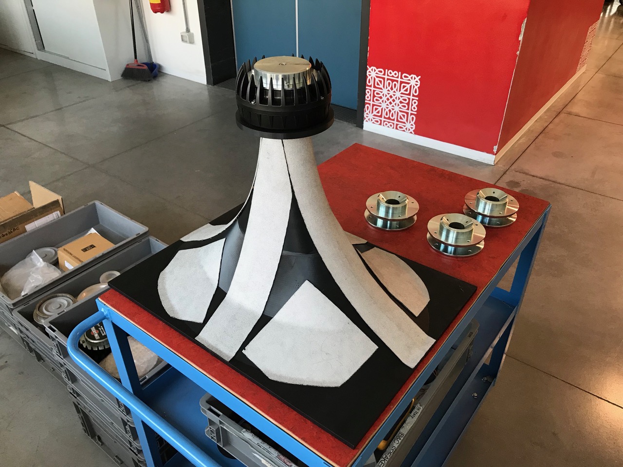

-this coax CD have some shorting ring? the datasheet say nothing about it
-there is some horn (from B&C or other brand) that on pair with DCX464 can produce a similar curve like that one showed on the datasheet? Even a curve that roll on around 7-800Hz might be ok...

Hey Alessandro,
The coax uses a copper cap on the HF section only, we found no benefit to using any shorting device on the MF section. Regarding the horn, I am unaware of any off the shelf horn that can go to 300Hz. We use two large horns in testing and measurement at B&C, the one used for the data sheet is attached.
