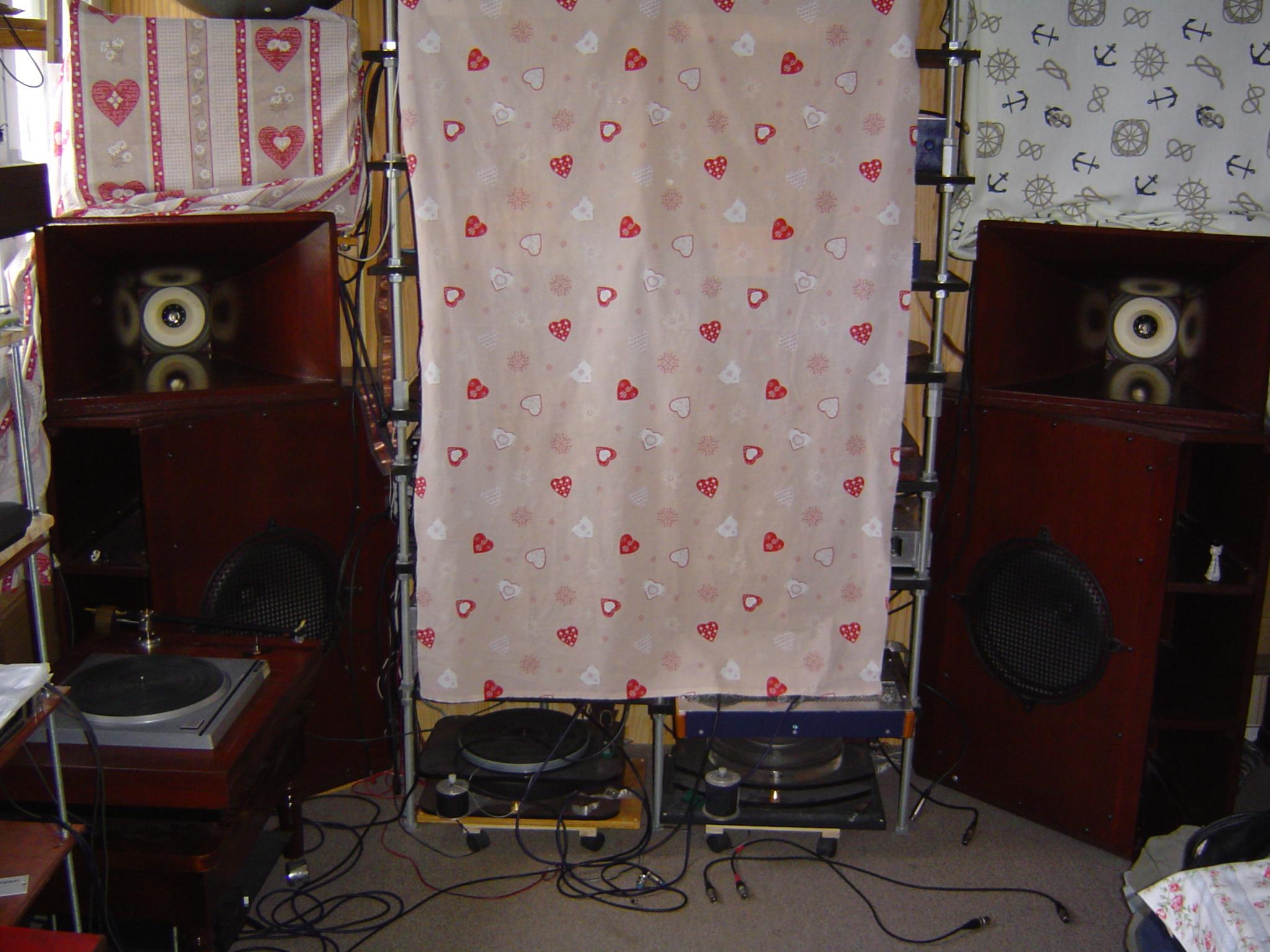

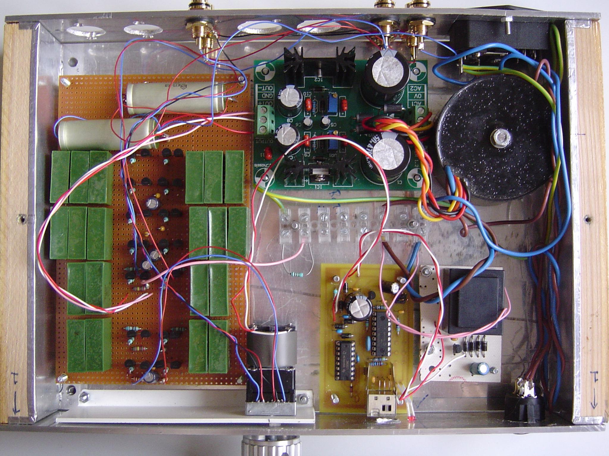

I have attached some photos of the Lowther Jensen system I mentioned (2 way, xo @ 180Hz LR4), incorporating IR remote volume control.
Thanks,
Davidkou.

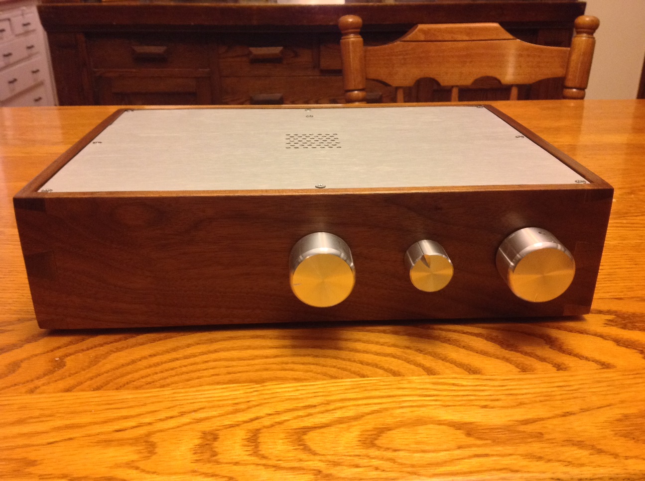

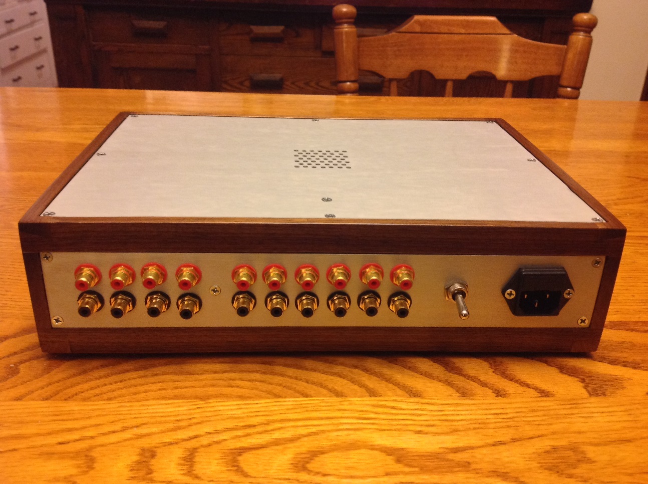

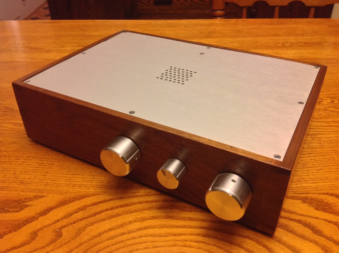

Just finished my DCB1 with a buffered 2-way crossover. Ready for some bi-amping! Don't have it hooked up to the system yet, but the test speakers sounded good. The crossover is on it's own board so it can be easily swapped out for different frequencies. Not the most elegant, but it should be reasonably flexible.
Are the filter rates (attenuation slopes, frequencies, etc) for the high pass and low pass filters both the same or have you included any compensation for amplifier freq & phase response, driver differences, box diffraction, etc?
Is that block bridge with the 'Red Cap' across it a 'floating ground' mechanism?
You generally only need one adjustable volume on either output - suggest you try the high pass filter O/P without the series pot, if the low pass amplifier gain is high enough
