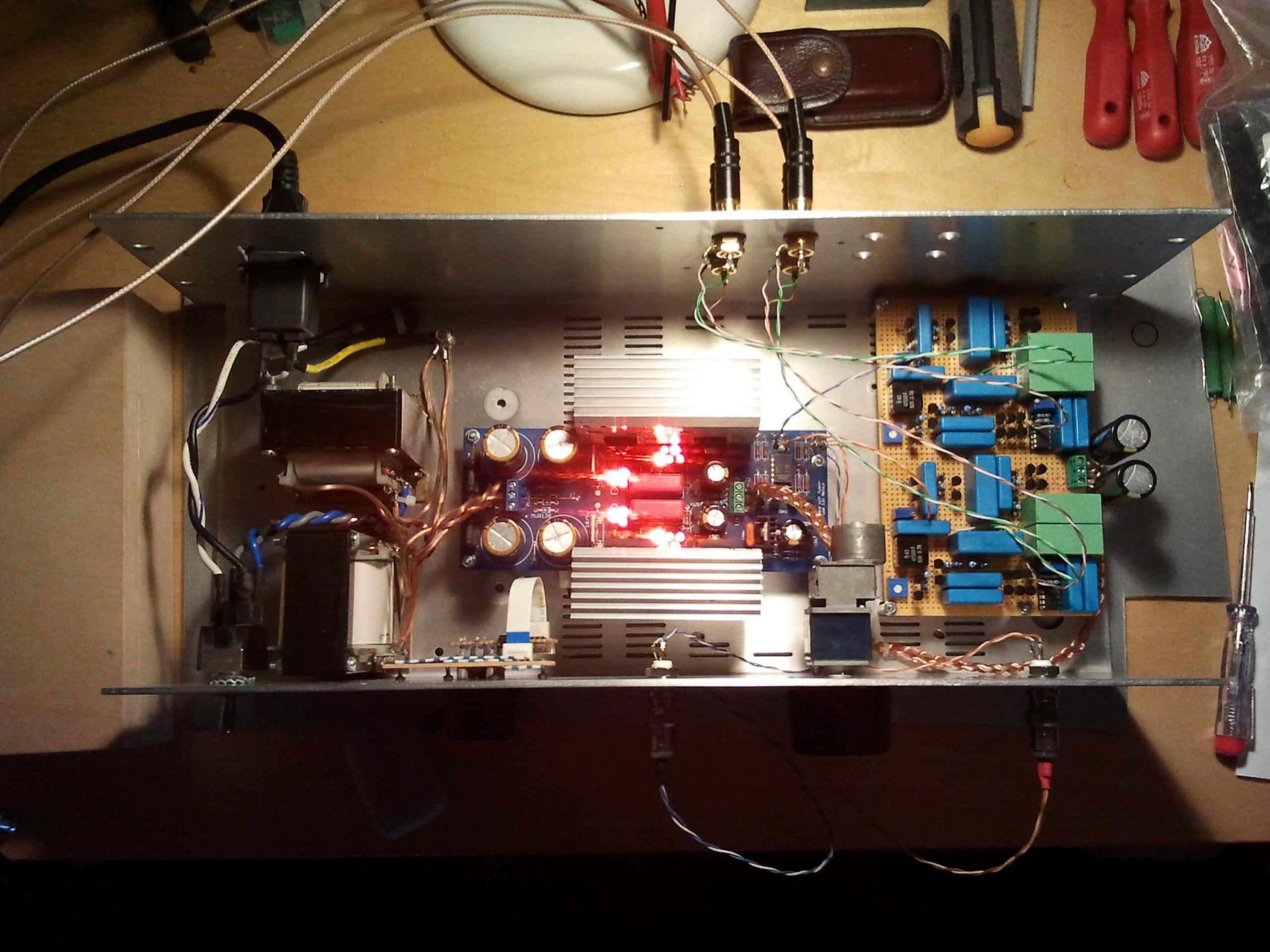

Nice build, by the way - lot's of effort - great to see
Hi Tony, season greets and all that!
I'm playing with the our old mate, the similar dcB1 buffered Xover but with only the high pass filters via the dcB1 and using the UltraPro Berhinger (yes, 'that damn thing'!) for the low pass to get better control of the vagaries associated with 2 different amps, 2 different speakers, etc and is showing great promise so far - might try the Nadja DSP later on to see if the mids/tops is satisfactory, unlike the UltraPro high pass signal (Fx/o is same 125/140Hz)
The crossover is on it's own board so it can be easily swapped out for different frequencies
Are the filter rates (attenuation slopes, frequencies, etc) for the high pass and low pass filters both the same or have you included any compensation for amplifier freq & phase response, driver differences, box diffraction, etc?
Crossover is currently set for experimenting with FAST setups (1st order at bafflestep, which the fullrange forum seems to think is a good starting place). Ordering more parts so I can try a few different points.
Is that block bridge with the 'Red Cap' across it a 'floating ground' mechanism?
It's Rod Elliott's ground loop breaker circuit. There's a resistor in there too.
You generally only need one adjustable volume on either output - suggest you try the high pass filter O/P without the series pot, if the low pass amplifier gain is high enough
That's my plan. The knobs on the preamp are: input select, output select, and volume.

Finally finished the 2 Hypnotize regulators for the 2 way stereo crossover, had to cut off the B1 part of the boards to save space. I populated the bread board crossover 6 months ago, the Salas Simple phono pre amp and regulators were finished 2 months ago along with the Mesmerize DCB1.
Rush
So… can I use two DCB1 pcb (Hypnotize), one pcb per channel, to power active cross-over without populate the buffer section of DCB1 pcb ?
Or, should I also populate the buffer section of the pcb and use DCB1 buffer before XO ? Is it not redundant ?
Why does Rush use (Mesmerize) DCB1 buffer + DCB1XO ?
Also, looking at the picture of Rodeodave DCB1XO, I see a complete DCB1 buffer running before the XO section….

Yes, two PCB's fully populated, one per channel, but use them as the output HP & LP buffers after the volume control; also make sure the filter buffers are powered from the DCB1's and not another PSU.

I am using the Mesmerize DCB1 as a preamp buffer and as an input selector. I am also using a pair of Hypnotize boards (one for each channel) to power the crossover. I have a lot of stuff in that box: phono preamp, buffer/input selector, and a two way 24DB/Octave crossover.
I have a 3 outputs per channel, all pass, low pass and high pass.
