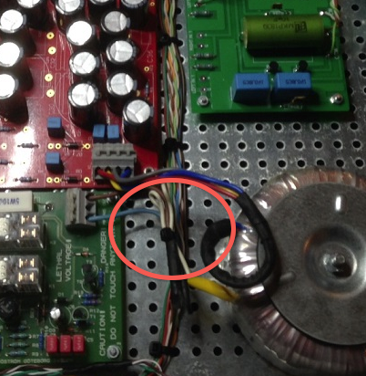

Nice work but have to tied 230 V wires together with others? Not got for safety reasons but not good either of you want to have low noise. I recommend that you try to have 230 stuff with low voltage stuff.And we are done!

High vs low voltage
Hi PA,
Thank you!
But I don't quite understand what you mean.
I did not ty any 230V lines to low voltage lines.... that's good I think?
Hi PA,
Thank you!
The small wires at the left are quite dangerous! They must be 230 volt wires since you have ALL stuff on the soft start connected to the mains. This is really dangerous to have those thin wires through those holes with sharp edges! You know, I write about this in big black letters about this safety issue. It's also printed in block letters on the pcb. YOU MUST FIX THIS!
Wires
Hi P-A,
Those thin wires are only the switch and LED wires, so they have very little voltage. They do not go through holes in the chassis. No danger there.
The other thing about the softstart close to the low voltage side, that is the case and I will follow up on that. Thanks for the tip!
NB: All "thin" wires are low voltage wires(exept for the lead in thin ones of the toroid offcourse) and they do not go through holes of any kind. That was the case before, but I changed it a while ago.
Hi P-A,
No..... EVERYTHING is at 230 Volt potential!!! Lethal! Why don't take a voltmeter and measure?Hi P-A,
You must have 8 mm creapage distance between mains side and secondary side.P-A,
I could raise the softstart about 5cm...... that would provide a bit more distance. Would that be enough or do you think I should revise the layout?
Thanks!
