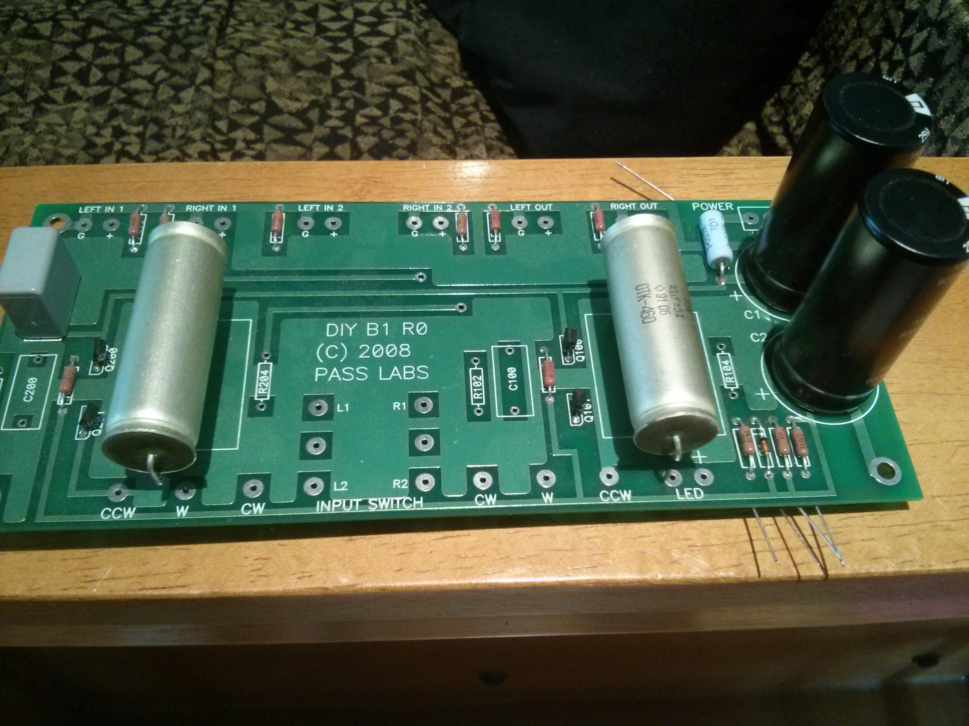

B1 Buffer Preamp
I paid 8 USD for 200 pieces (including 600 number of angled pins below), plus 5 USD for shipment - averaging .065 USD per piece include shipment, from the Chinese online market called TaoBao.

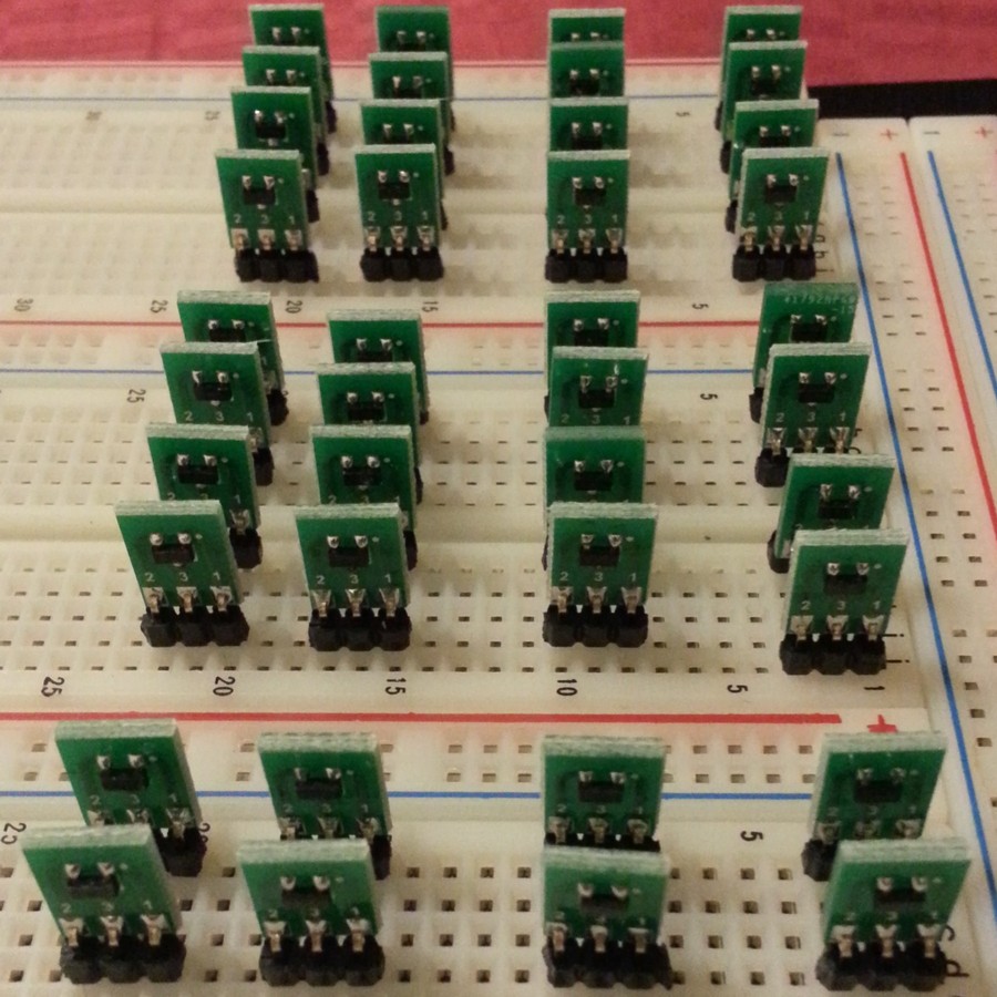

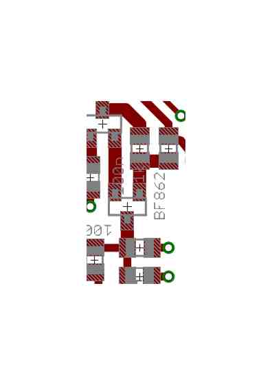

First time to solder SMD parts, it turns out to be easier than I thought. I have a question about idss matching though.
I've measured the Idss (@12V, as I have no 10V source around) of 40 pieces of BF862, and got some matched pairs. I would like to know if it's better to use a loosely quad-matched for the 2 channels of B1, or 2 closely matched pairs.
Idss of Quad matched: 14.89,14.93,14.98,14.99mA
Idss of 2 matched pairs: 15.81,15.81 and 15.90,15.91mA

Thanks Salas, Andrew mentioned the same before. I'll probably stick a small piece of copper foil on them with thermal glue.
@18 degC room temperature and open space, running them @12V and idss for an hour, they aren't even warm. But it's probably very different in the summer, in a small case together with a shunt regulator.

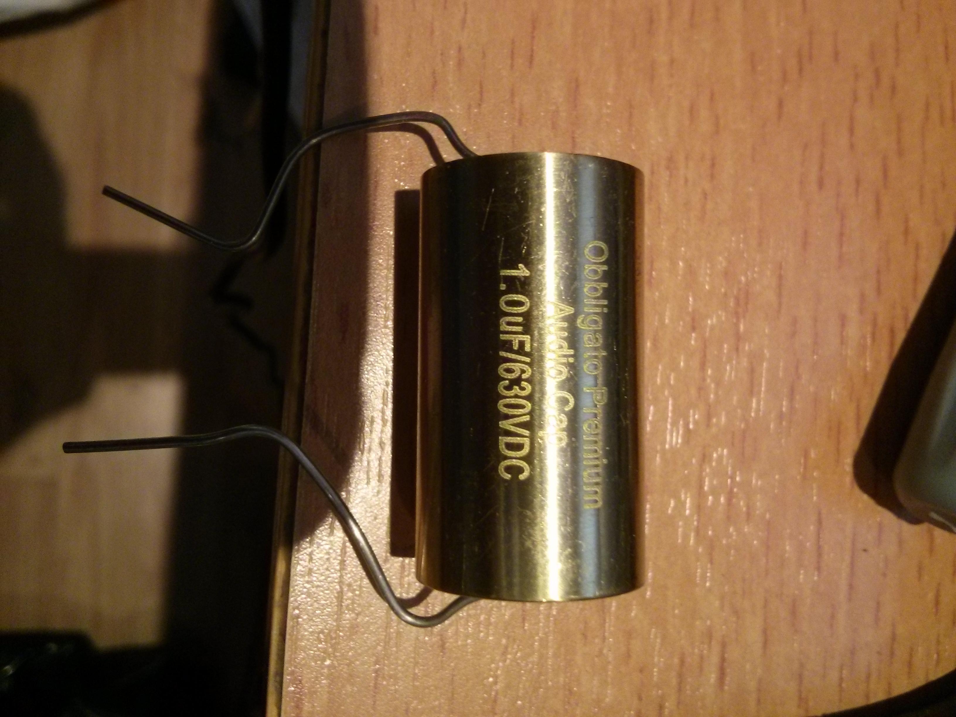

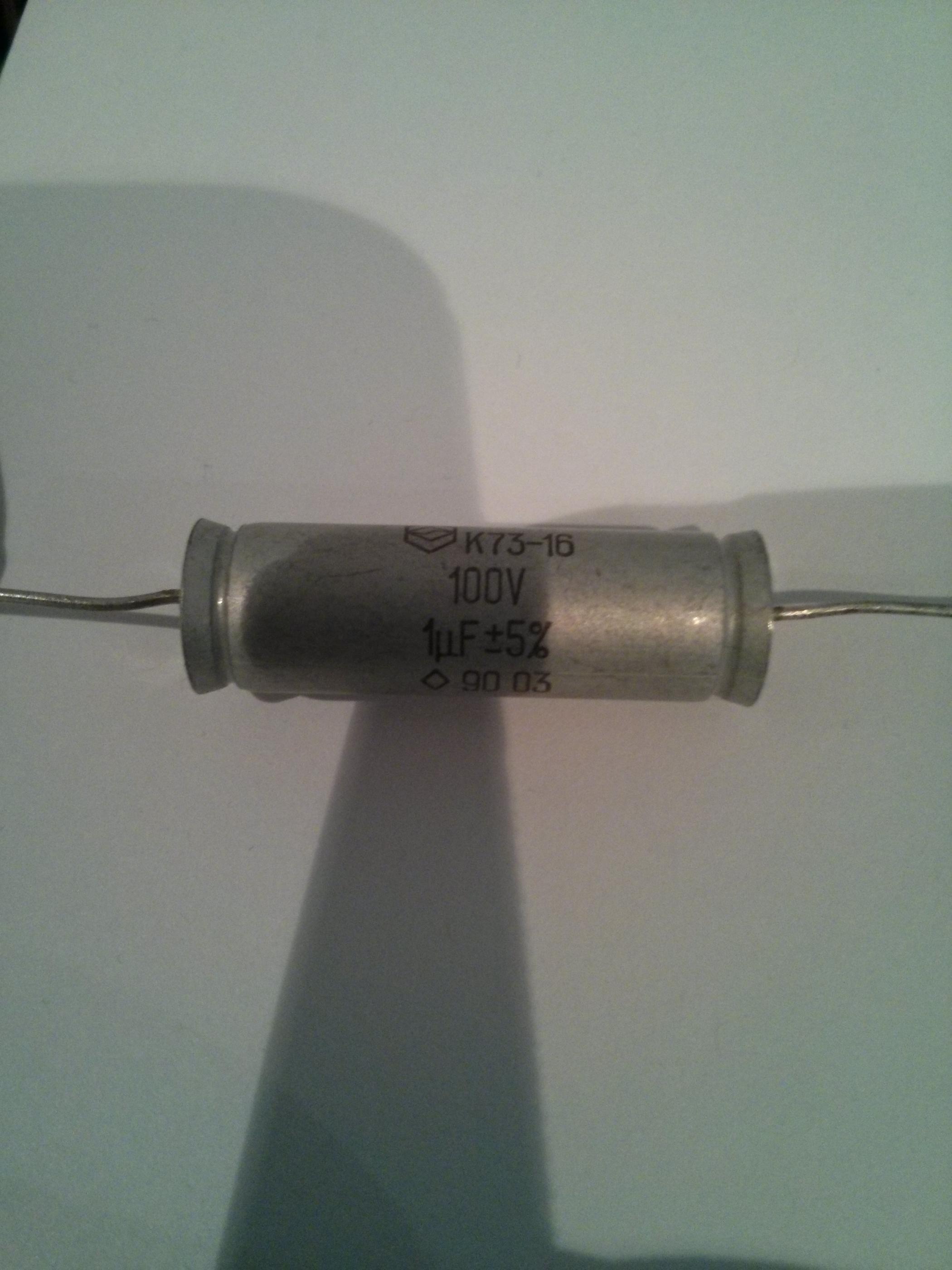

There are more than a few that do not recommend paralleling many capacitors for a signal coupling duty.
I wonder if mixing lots of different dielectrics will give an average set of parameters that will pass signal cleanly?
what about trying a mix of polypropylene + polystyrene + teflon + polyphenylene sulphide.
Then one could vary the parameters by changing the relative values of each type.
BTW,
what is the objection to using multi-paralleled coupling capacitors?
