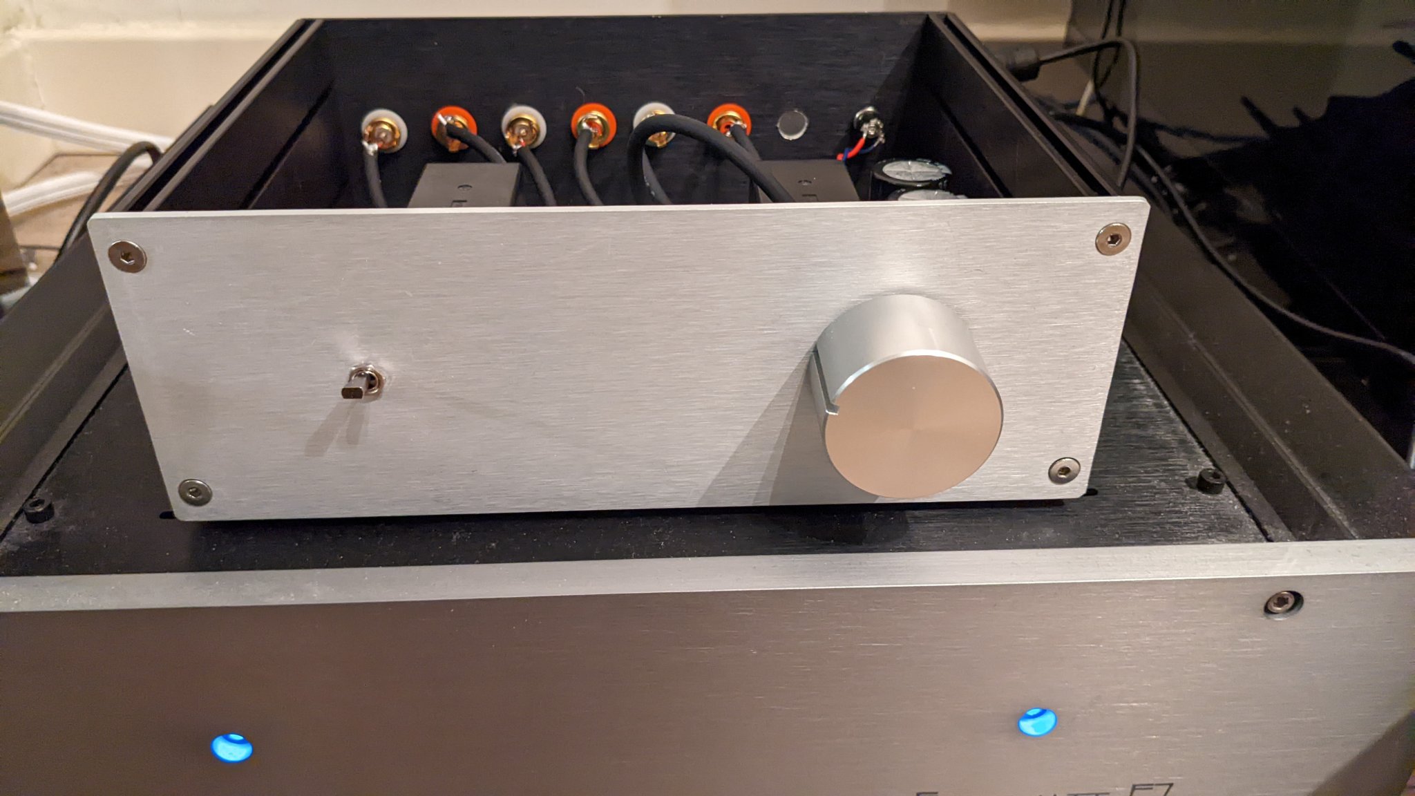

I recently built an M2 from Teabag's boards. Then I tried 3 preamps with the M2: a B1 buffer, AKSA Lender pre and H2 (V2) set for minimal distortion. The verdict is that the H2 sounds better as a preamp in my system. I just thought that members might want to know this.

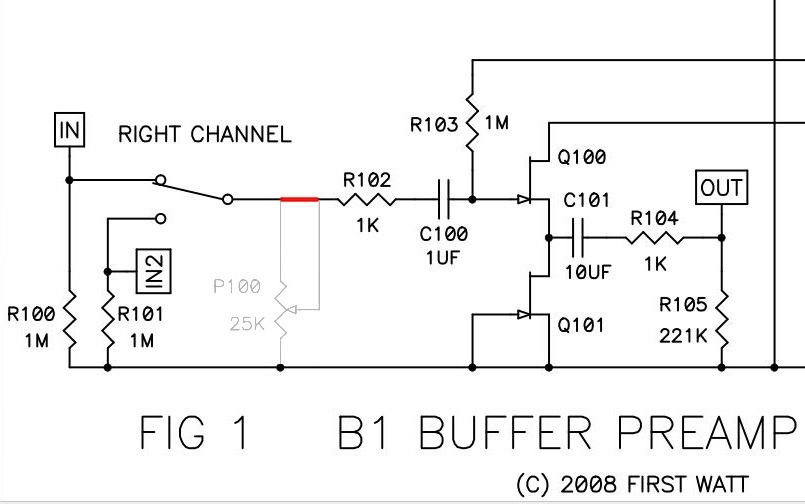

I need some advice, please. I want to remove the pots from the B1 V0 circuit since I don't use or need attenuation. Can it be done like shown in the modified schematic below? Do need to install a 25K resistor in the place of the pot? IOW, does the circuit need the 25K resistance?
I'm currently using cheap "Alpha" pots, one for each channel. Will I gain anything by removing the pots?

I'm testing the B1 in a balanced configuration using a signal transformer to covert unbalanced input to balanced.
It works pretty good and i'm quite satisfied .
Do you know guys the output impedance of the B1 ? Am i wrong or is close to 50 ohm?
The Class D amplifier i'm using is having a 10k input impedance.
Many thanks in advance..!!
Maurizio

Rout:
for complementary buffer : (xconductance of upper plus its source resistance) in paralel with (xconductance of lower plus its source resistance)
for "same sex" buffer : xconductance of upper plus its source resistance
so, you're in bracket with said 50R
in any case, more than good to drive 10K
