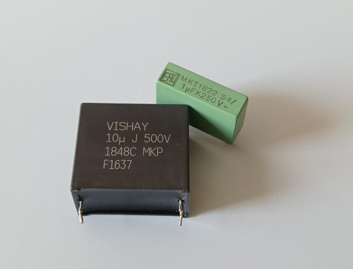

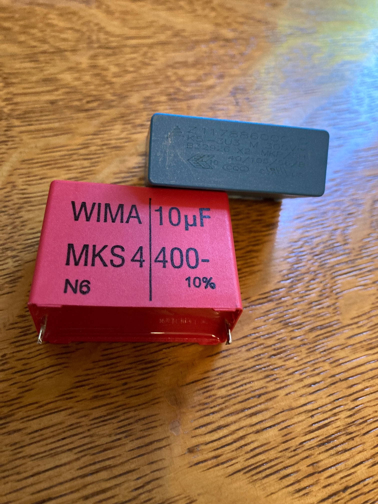

I came across a pair of 3.3uF MKP EPCOS/TDK MKP safety capacitors and could not get un-curious as to whether they would sound "better" than the Wima MKS4-400 series 10uF caps I'd spec'd as the coupling caps (C101, C201) in my single-rail B1 buffer. The new caps are metallized polypropylene, intended for use in EMI suppression, versus the metallized polystyrene I was forced to settle on for my original build due to the supply chain crisis of late. My favorite load is an F3 with a Zin of 10k; the roll-off point with 10uF output caps is probably 1.45Hz; with 3.3uF it goes up to 4.38Hz. Maybe not a big deal. Anyway I tried them while making some other minor repairs to my B1 buffer, and I swear the treble opened up dramatically with the MKPs. Much more detail, and they changed and mellowed quite a bit over a few hours of listening to CDs. I can't detect a difference in the bass response.
So, if you are on the fence regarding the effects of caps in the signal path, at least consider this anecdote as one more in the camp of yea, they can matter, and it's worth playing around.

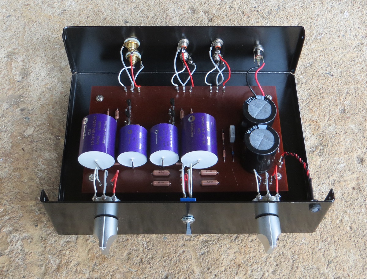

I will need a bigger case. I used some old Soviet PiO caps and they sound grey and dull. I came across some videos where they rolled caps in guitar amps, and I heard the same dull type of sound. Time to upgrade caps! My B1 triode preamps are so good I doubt the B1 can compete, but maybe with better caps, who knows.With only two caps in the signal path on the B1, cap rolling worked extremely well for me. I opted to upgrade to CSA series ClarityCaps.
The difference was like night and day. The B1 is now my best preamp by far, with incredible clarity. Maybe it’s because the caps I used originally weren’t that good in the first place, but I don’t have access to a “standard” B1 to compare.
Please give feedback once you've tried new caps in the B1. I can't vouch for anything other than the CSA series ClarityCaps, but I'm convinced. It would be good to know how it compares with your triode preamps.
There are so few parts in this thing that one would imagine that each one is extra important. I've just built one with top-notch parts all around: Jantzen caps (Silver) and Caddock and Vishay Z-Foil resistors, plus a Goldpoint switch and Khozmo volume control. I'm hoping actually to listen to it next week. I also have a 'stock' B1 with good but more standard parts (Solen caps and Dale resistors, Alps pot and generic switch).
