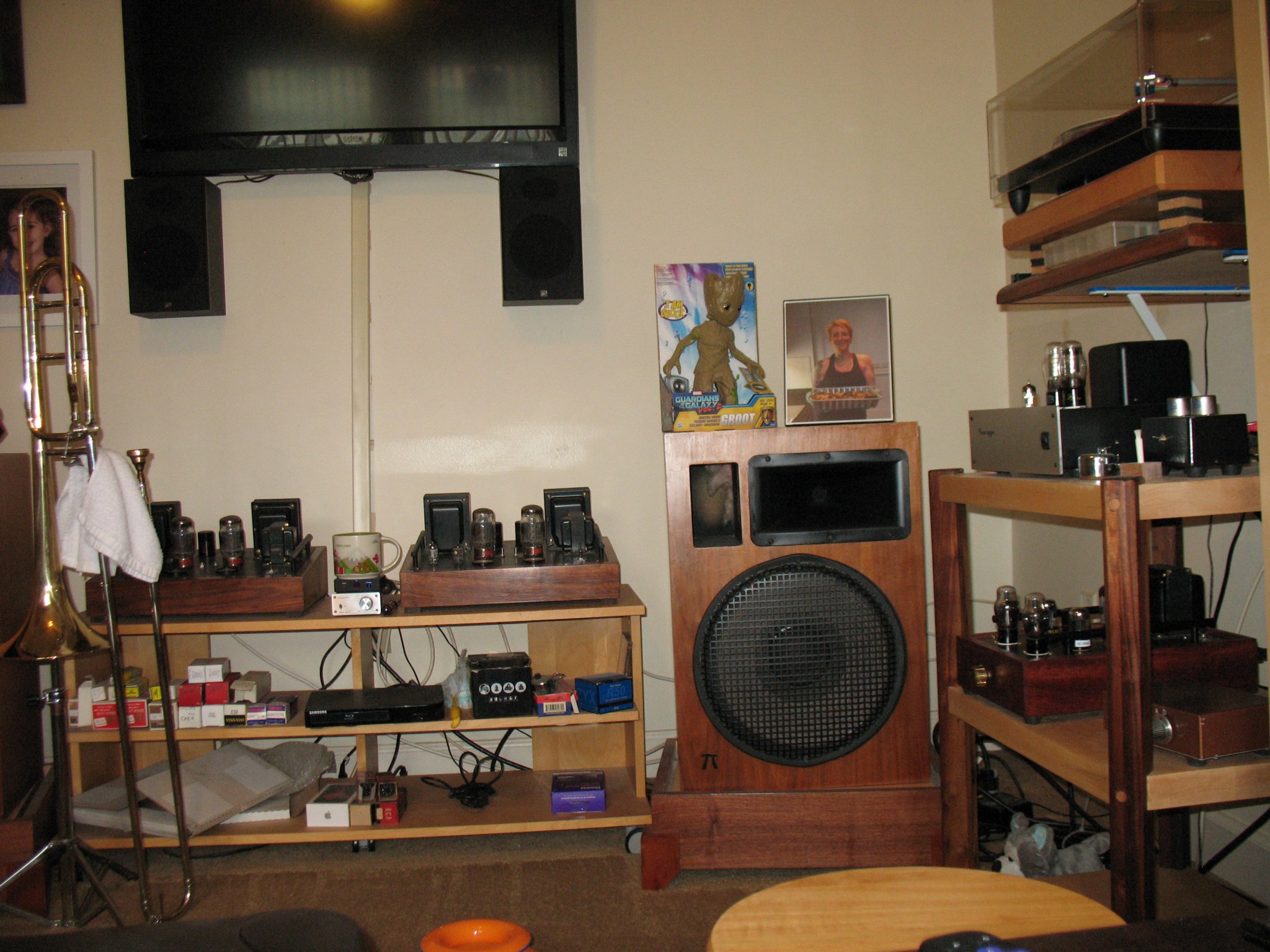

Interesting assortment of Gear there .I'd be grateful for a few words on how your "standard" build sounds which is what I shall begin with. My single reason for the build is to find out how the circuit will compare to the performance of my DIY JE Labs 76 Line Stage, active vs. buffered passive.
I tried the Schiit Saga+ with the single 6SN7 and was underwhelmed. I have a little box with an attenuator and switch from back in the CD intro days which sounded "pure" in the same rack with a 45 amp but in my current setup, a mismatch with 20' interconnects to KT88 monoblocks. The amps have the negative feedback from the Mullard circuit removed, so as wonderful as the 76 Linestage sounds, a passive is enticing to try.
Shame that's All in an Itty Bitty room though.
Hey! My "Itty Bitty" room is in my luxury retirement town home on the shores of a parking lot with a deck over-looking a bank drive thru. So there!Interesting assortment of Gear there .
