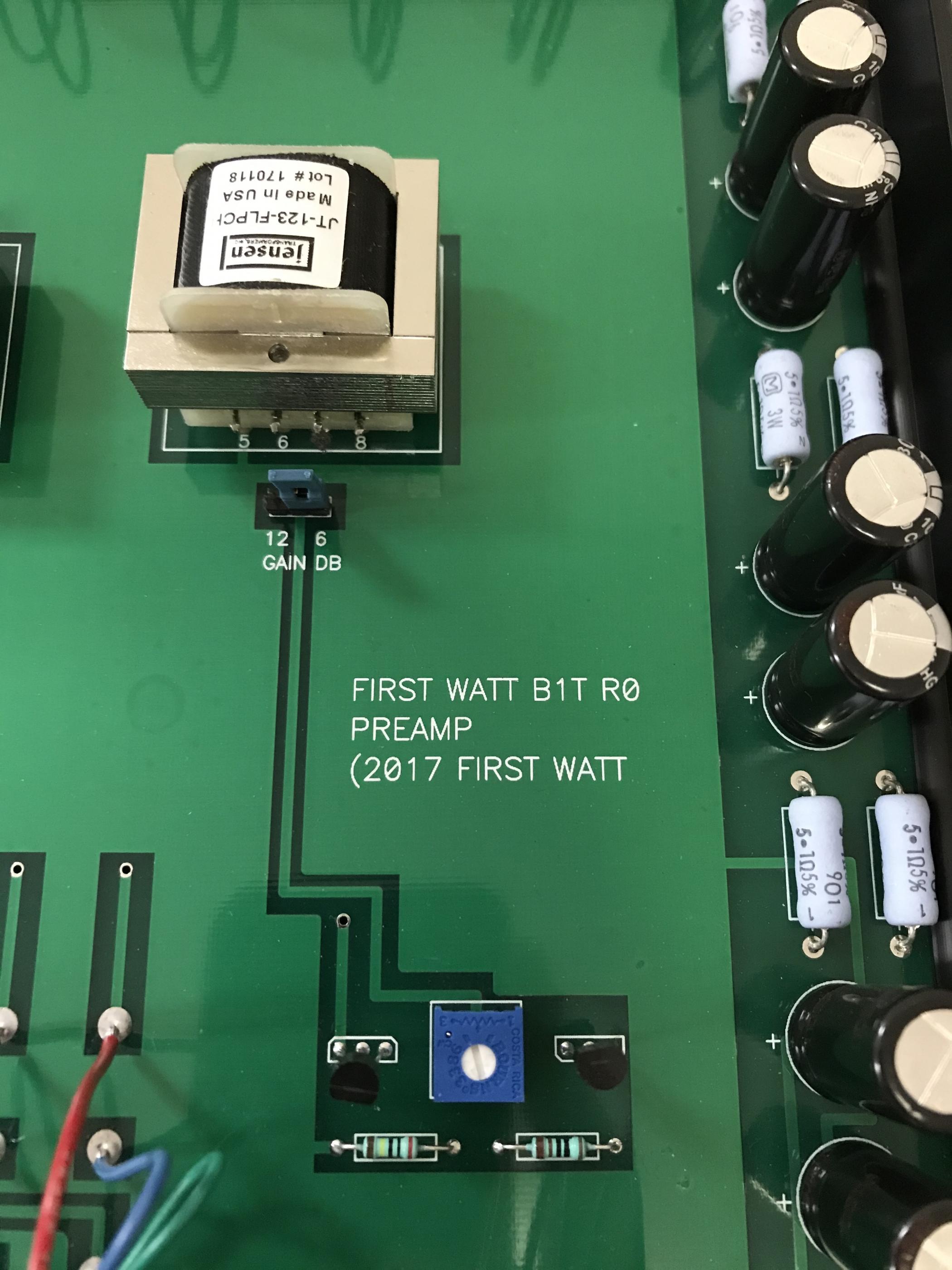

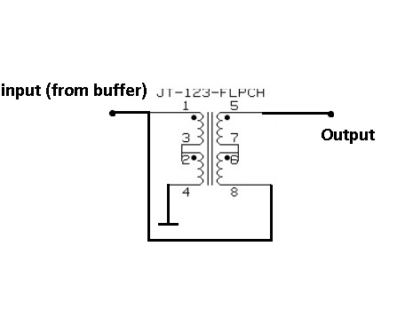

M2 using Edcor 600:15K (nominally)
F6 using Jensen 600:600 (150+150:150+150) (nominally)
obviously B1T using same Jensen
more about principle you can read here : What's wrong with the kiss,boy ?
pic from B1T (I think Pa didn't made it in commercial quantities) :

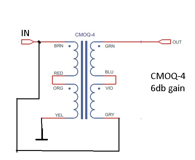

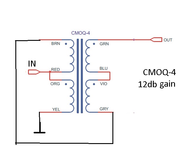

@Jeffreyjuice
Thanks for the kind words. I am completely reliant on the guidance of others when it comes to making modifications to circuits. I just like to build pretty things and listen to them.
I think you have all the info you need to pursue adding some gain with iron to your Mez DCB1.
Zen posted a picture of how to exactly wire up the Jensens in the KISS thread (below).
I pulled my 220 Ohm TX2575 Z foil output resistors at Zen’s suggestion.
The only other thing I did was integrate a safety ground on the same perf board that Salas helped me with. I had some hum issues with certain equipment combinations previously and this appears to have fixed the problem.
The change gave me exactly what I needed to finally experience MC carts properly through my system.

Has the b1 with transformer ever been released to the public? Or stayed at prototype level? Didn't matched the expected performance? Is the transformer core material the same as M2 or F6?
It stayed at prototype level. Perfectly fine piece - you might be surprised
to know many things go on the shelf, although this one sits in the sound room.
