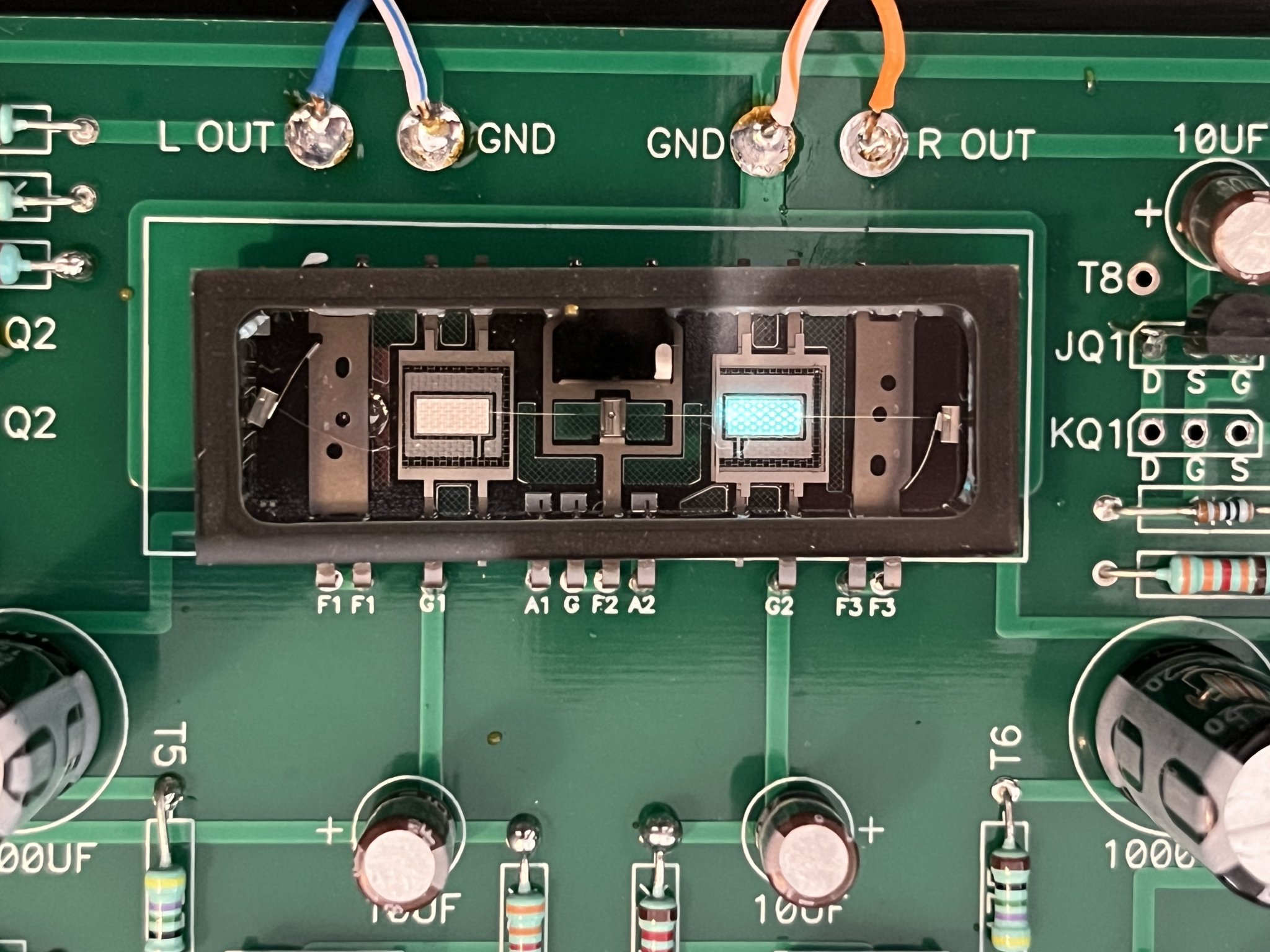

Welp, although I got held up and procrastinated 6 months before even cracking the chassis open (jeez where does the time go) ... it appears to simply be the NuTube failing on that channel. Ordered a replacement from the shop just now. NOt sure why this happened, but I do tend to leave it on all the time, maybe I'll stop doing that. I also have al the parts for a PSU project ready to start for this, maybe now is the time! Thanks guys for the help.From https://www.korg.com/caen/news/2015/012212/ :

Does the Nutube glow on the side that is not producing sound?
Measure the voltages at the test points outlined in the B1 Korg manual. Are they still good?

Thx Papa. I have a replacement coming next week thankfully (and this one has served well, on 24hrs, for about 2 years) – but if the L channel on NuTube has died, do you think I need to run tests elsewhere to locate the cause of that happening? Not sure where to start, if so.

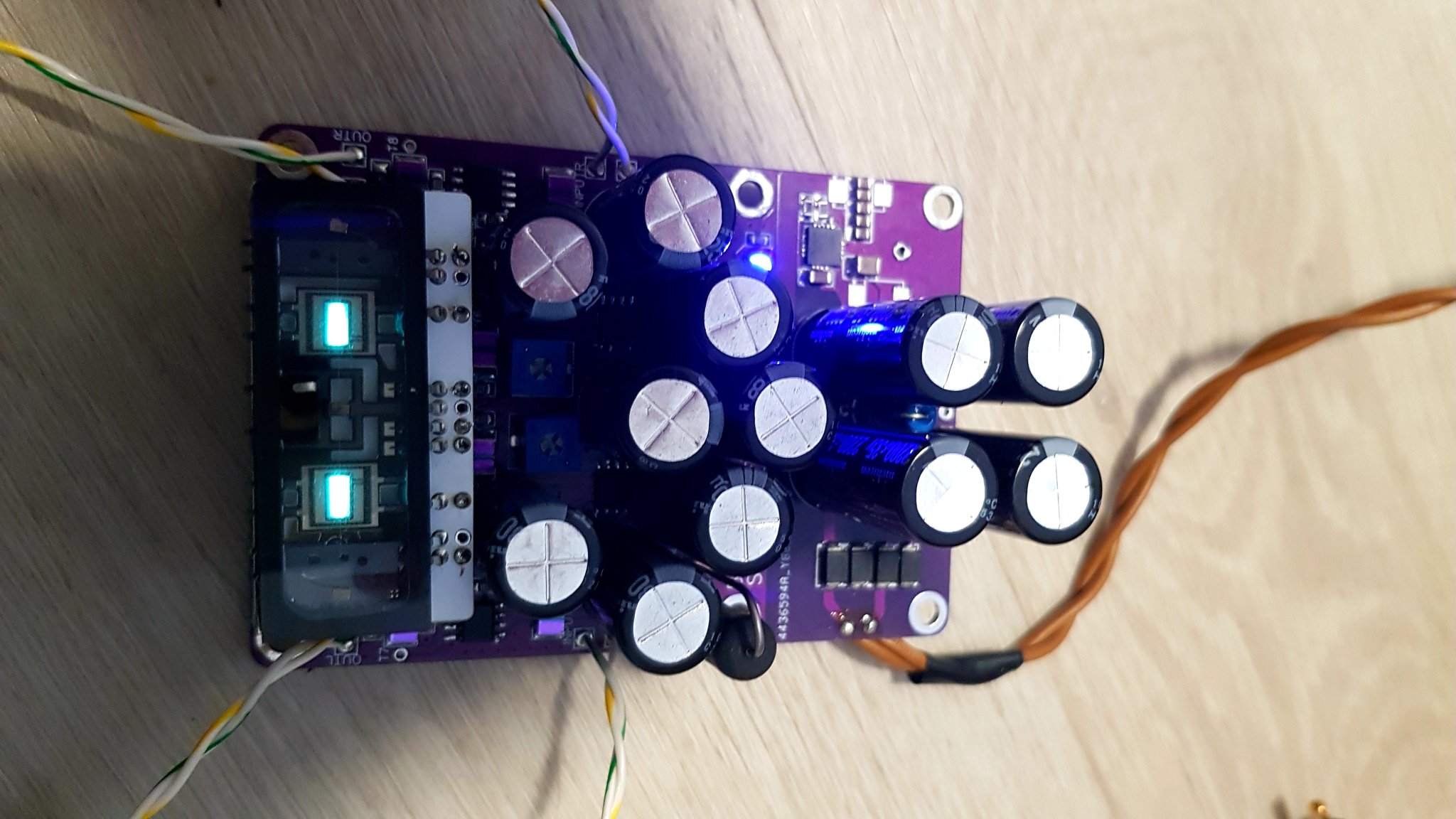

Hmm I missed the don't leave it on memo. When mine failed I measured all of the build test points and one channel was correct and the other the values were not right. Someone told me to take a very close look at the fine wires and one was broken. I ordered a new tube, replaced it and it seems to work fine now.

You are the eleventh person at least to report a Nutube with a broken heater wire on the left (!) side of the nutube. It seems they have severe QA and QC problems.
The nutube either works or the left heater wire breaks. Mine did worked for about two to three weeks.

This recently happened to mine, in fact the broken filament looks the same as yours pictured, on the left side. It happened around the time of the peak solar activity. Possible voltage spike? Probably coincidental. One of my hard drive wall warts crapped out at that time, too. I stopped leaving mine on 24-7 a while ago. Though I believe turning on/off cycles is more stressful to traditional tubes, not sure about the Nutube. I assume it's the same, though. When it blew there was a nice pop out of the left channel, but not damaging to anything downstream, including my ears.Welp, although I got held up and procrastinated 6 months before even cracking the chassis open (jeez where does the time go) ... it appears to simply be the NuTube failing on that channel. Ordered a replacement from the shop just now. NOt sure why this happened, but I do tend to leave it on all the time, maybe I'll stop doing that. I also have al the parts for a PSU project ready to start for this, maybe now is the time! Thanks guys for the help.
I have been introduced to these many years ago, as a result of my encouraging a EE friend to investigate the design.
The result being there are five variants built and a original Spec' as well.
I have had the original spec on long term loan, and really enjoyed what it could do with my 845 Monoblock Amp's even with the added gain that was present.
I have a Monoblock KB1 to be built, with bespoke built VC's for the role.
The intention is to house the Korg Nutube in a Panzerholz casing and house the whole of the Electronics in a Airtight Panzerholz or Permali Chassis.
