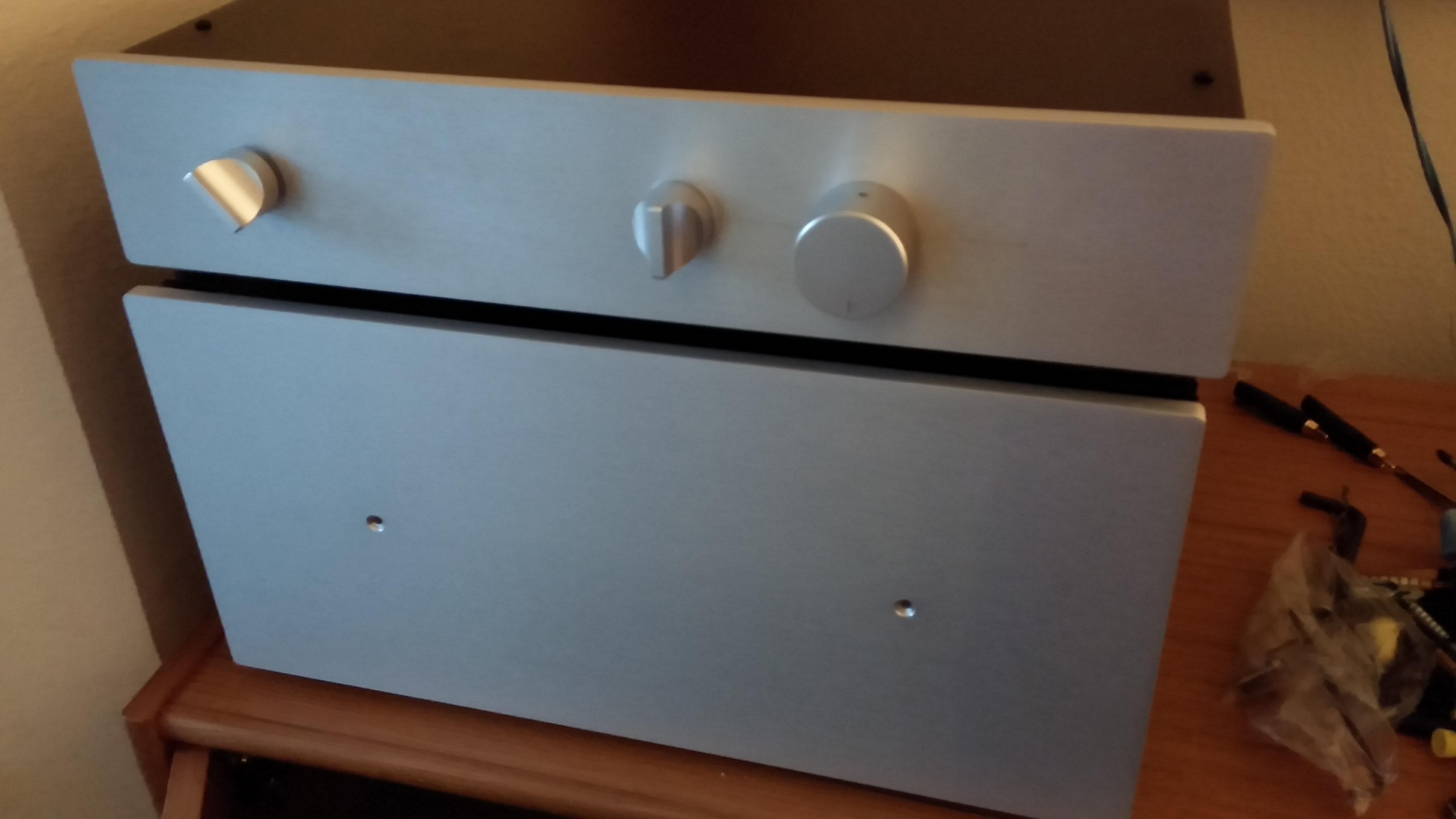

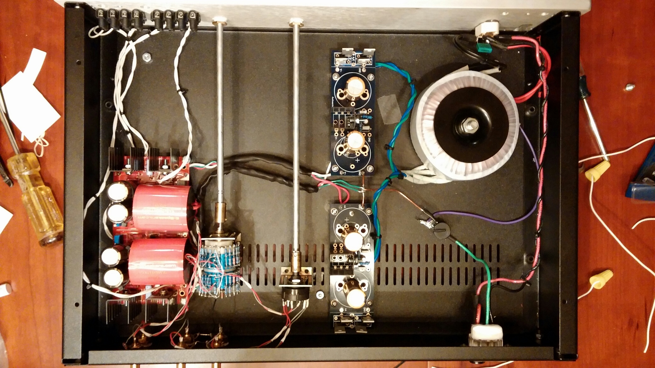

I thought i'd post a pic of my 99% done BA-3 build.
The white wires lead to the black terminal blocks on the faceplate. They are for bias, DC offset and P3 probes. Makes it really easy and fast to make adjustments.
My goal was to keep signal wire short.
I have no scope or distortion analyzer to scientifically adjust P3. I've tried a few different settings, just by counting the turns of the pot. It has a profound effect. I still don't know where I will leave it but has it really changes the placement and location of instruments and voices. You want it wide and distant with voices deep in the back it can do that. If you want it up front and focused with vocals right above your head but less depth and width it can do that too. If any knows of any Mac based software to take some measurements related to P3 let me know. That may be the next step.
I'd describe the sound as controlled and precise. Smooth and even without any raggedness or sense of being out of control. Compared to my prior preamp, a Jfet BOZ, it is much more refined and extended, image placement is much more solid and it never feels ragged or compressed. But it maintains the same basic tonality.
This is a great design, a relatively easy build even for someone inexperienced like me and sounds great. So far so good.

Hik,
is that the Safety Earth under the Power Thermistor?
Bolt the PE wire to the Chassis at the mains input socket.
No other wire comes to this bolt.
Is that purple wire a link to an inter-winding Screen?
Shorten it and bolt it to the Chassis where the wire pokes out of the insulation.
What wire is the Power Thermistor inserted into?
What carries Fault current to Chassis?
Have you tested a Power Thermistor at fault current to see if it can handle 1000Apk?
Does the bias change when the input conditions change?............. the Bias needs to be set with the inputs shorted - why, I am not sure, but it is true.
If so, then the bias should be set with a nominal dummy resistor that matches the Source/s that could be connected.
