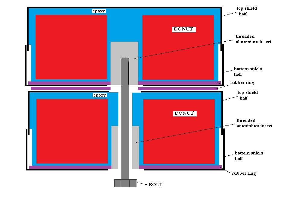

acceptable
though , can you put big boyz stacked vertically ?
it's easy to drill one black core all the way, and use longer bolt
something as I did here , and even simpler - you don't have pots to care about isolation etc. : post #52 , Most Greedy Boy, of them all... or (there is no) DEFiSIT of Papa's Koans
that way , you'll have space for bridges at left and right of Donuts

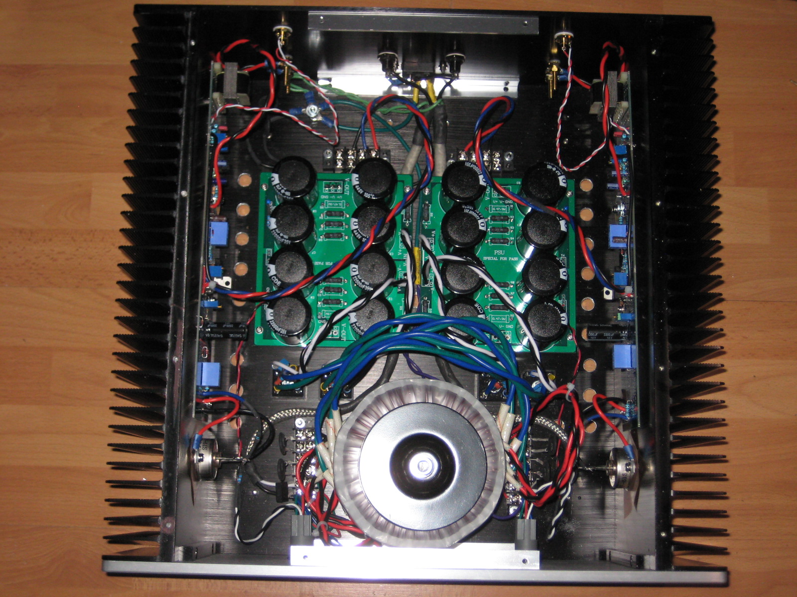

I've mounted them vertically in my Alpha build, it's also a 4U 400 case.My trannies are big boys, and fill almost all the width of my 4u 400 case.
How would you guys place the parts?
The most delicate part was drilling/tapping 8mm in the 10mm front panel for the transformer bolt without getting peeping holes.
Next time I will mount an L-bracket for the transformers on the bottom plate, this will give me less stress

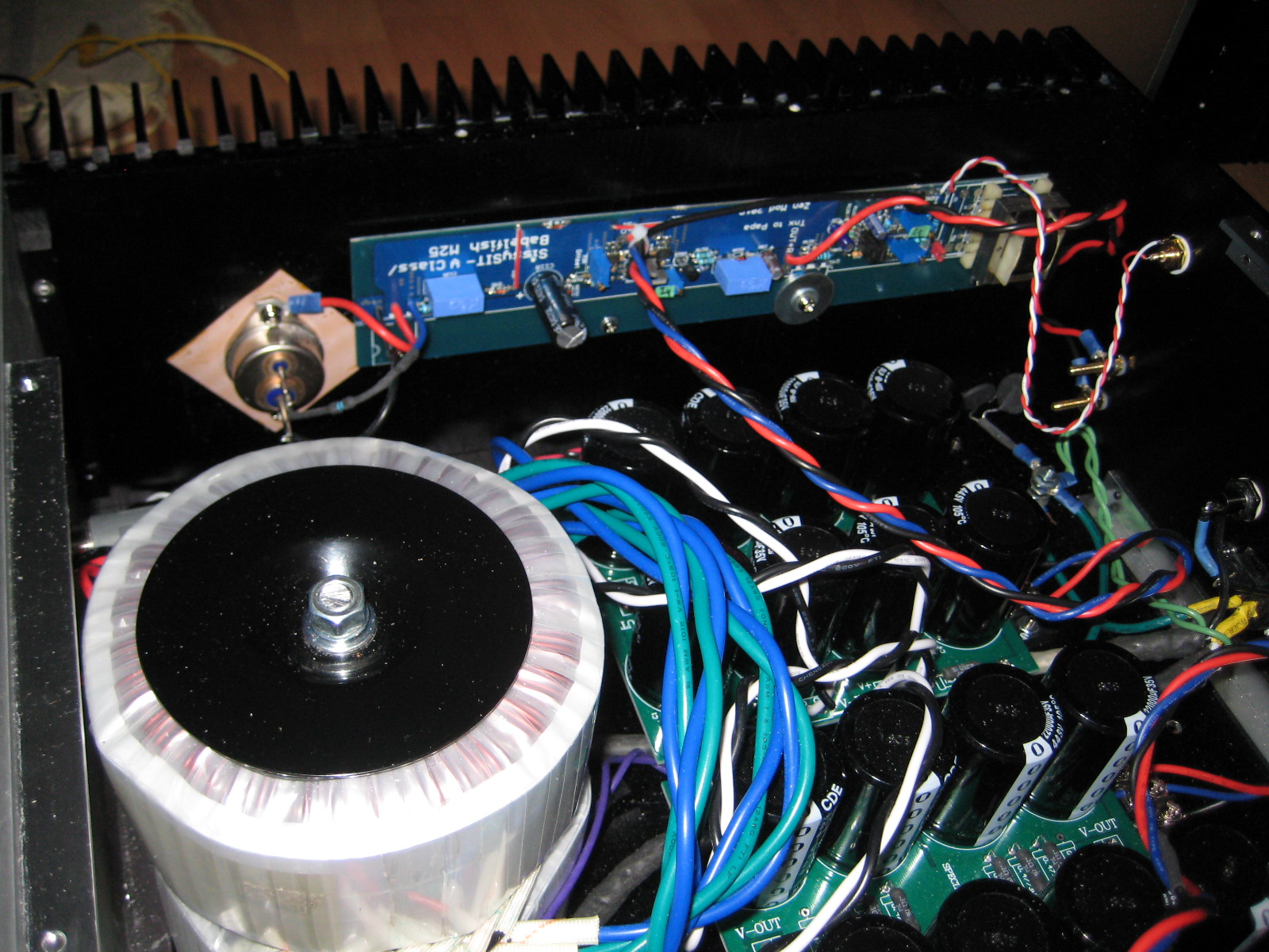

Here is a picture of my SissySIT with stacked Antek transformers. I purchased a length of threaded rod and cut it to size, with nuts at both ends to bolt the transformers in place.
Hi Ben. I was thinking of stacking transformers. I see the metal pad on the top, but is there also one in between the transformers?
