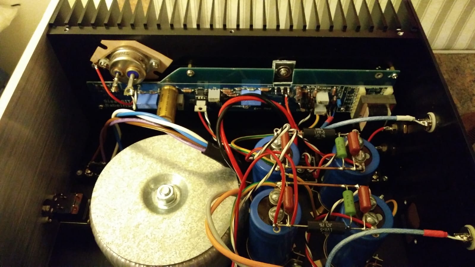

One thing that the middle plate does with Antek transformers is that it keeps the bottom transformer centred, as the Antek transformers do not have their centres filled.
From the bottom, I have rubber, transformer, rubber, steel plate, rubber, transformer, rubber, steel plate.
Also with stacked transformers, the top of the upper transformer may be very close to the top plate of the amplifier case. Make sure that the bolt/nut does not touch the top plate!

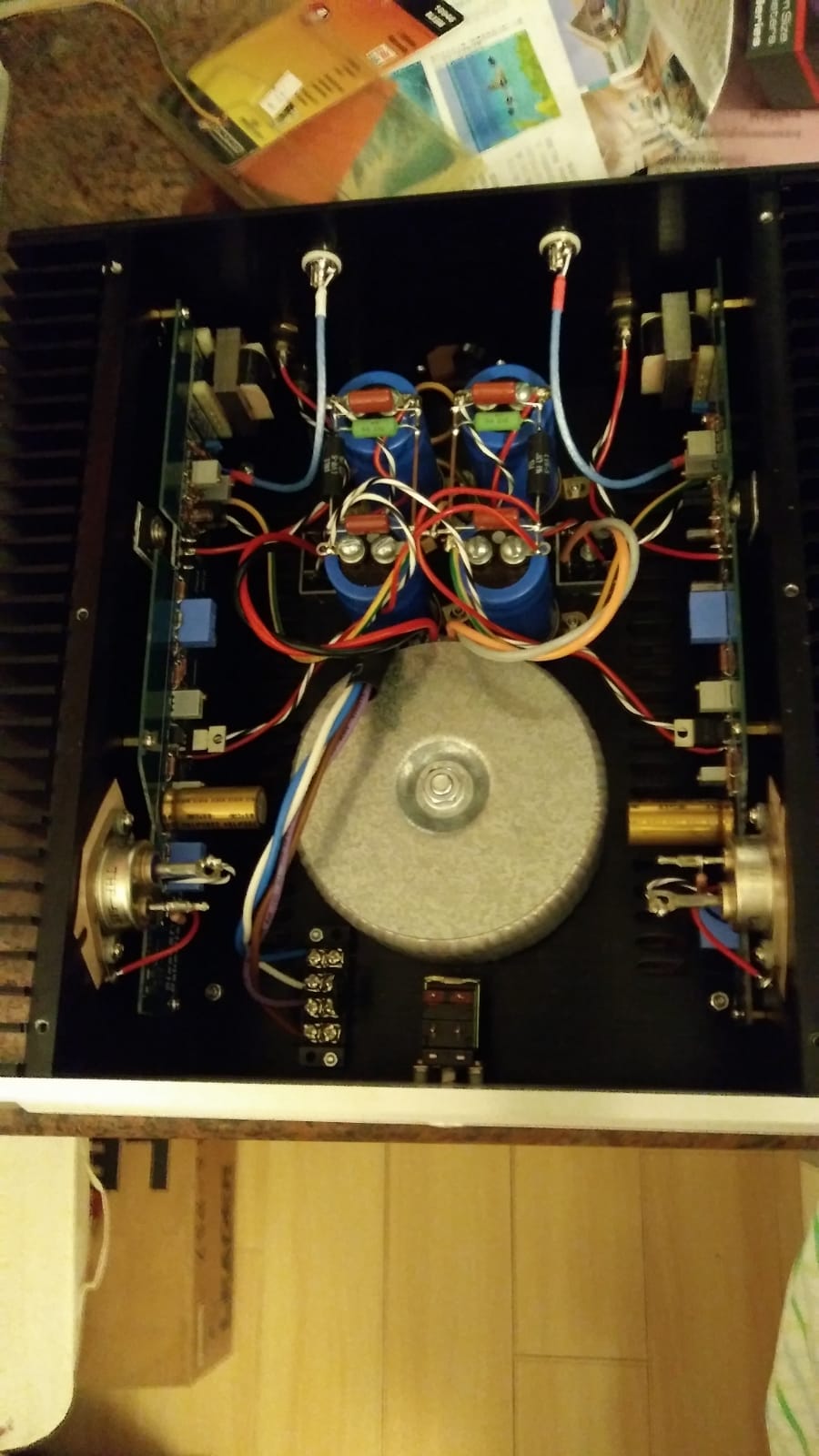

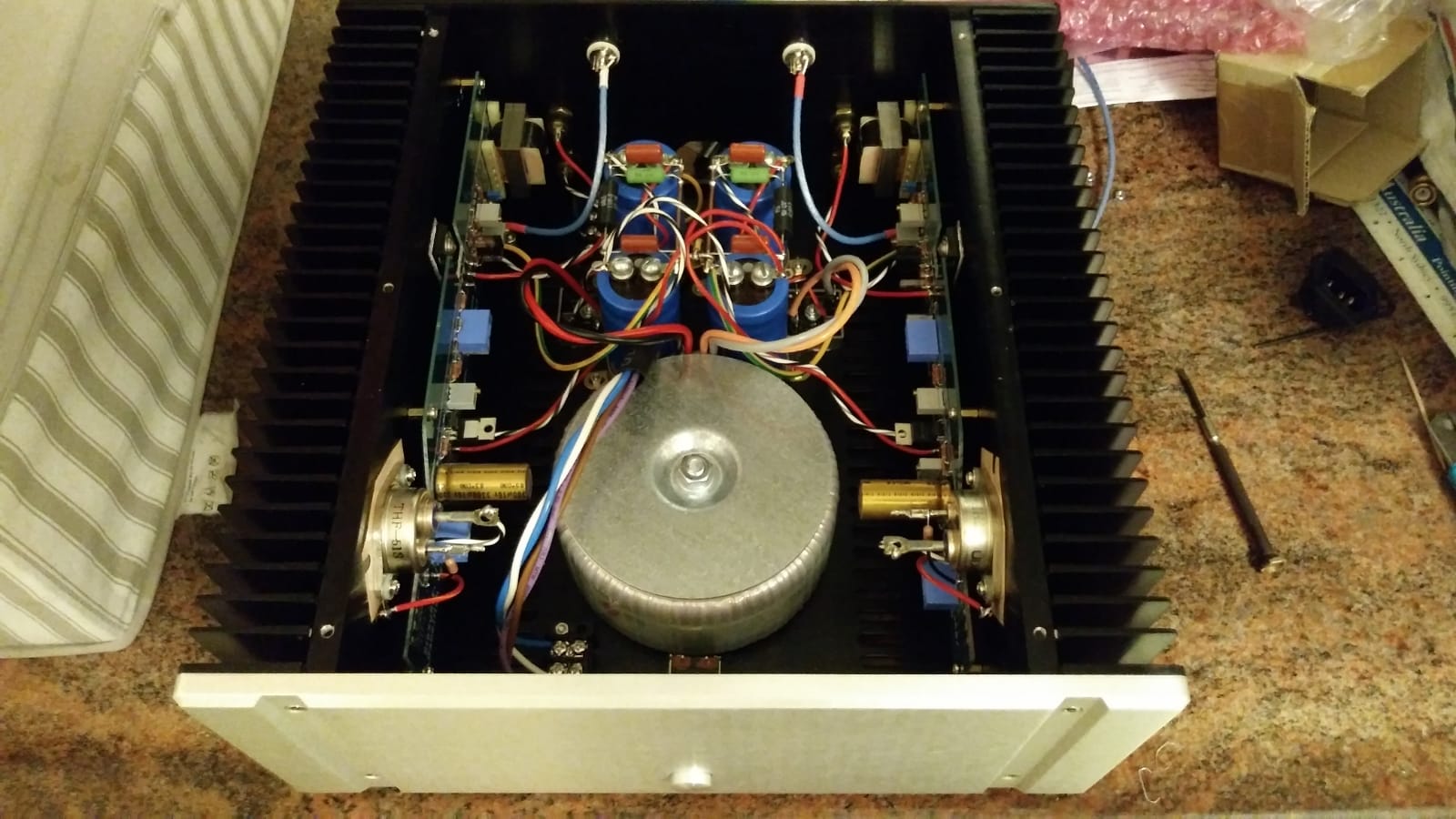

Just have time to put the SissySIT into a case. Everything is fine and it does really make music. Thanks ZM.
I just measured the temperature, the SIT is 55 degree C and the MOSFET is 75 degree C (at the steel washer). Is it a bit high for the MOSFET?
I set the Iq to 1.6A and am afraid of setting higher due to the high temperature in MOSFET.

I used the thin silicone thermal pad with thermal paste for the mosfet.
Is 75 degree C for the mosfet not good? What should be the ideal temperature?
I have not mount the 10mm face plate yet and will see whether the temperature will drop a bit after mounting.

I covered that too - I said several times that silicone sheet (btw. which Pras is sending for free, along with bushings, if you buy SIT from him) is perfect for SIT, as in SissySIT its sheer case size is taking care of peanut dissipation
T0247 cased mosfet is opposite case, it really starts sweating when you approach 35W++ dissipation, and you need to take care
